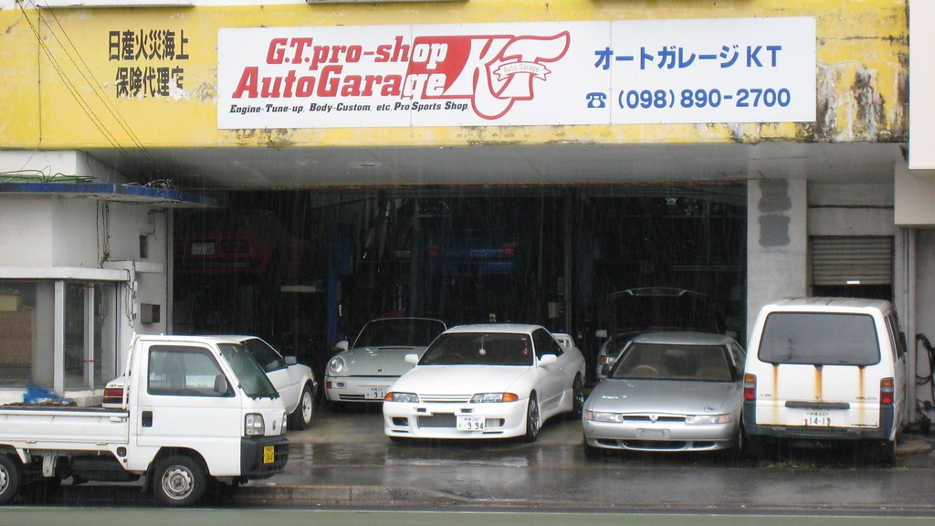

Interesting...I had no idea, thanks for the info...I've been there twice for vacation...The first time I spotted a Cosmo and took this pic...
Do you recognize the shop and or the Cosmo? I took this pic in early 2009...
Can't say I've heard of the shop, I'll ask around, I'm kind of curious too. Unfortunately I only know of another running Cosmo here and it isn't that one. There's a '95 SX model with only 33K KM's, it's a very, very clean and original Cosmo.

Cool...Good to know there is at least another running Cosmo in Okinawa...Got pics? Know the owner? If so, we'd love to see them join and post about it...
