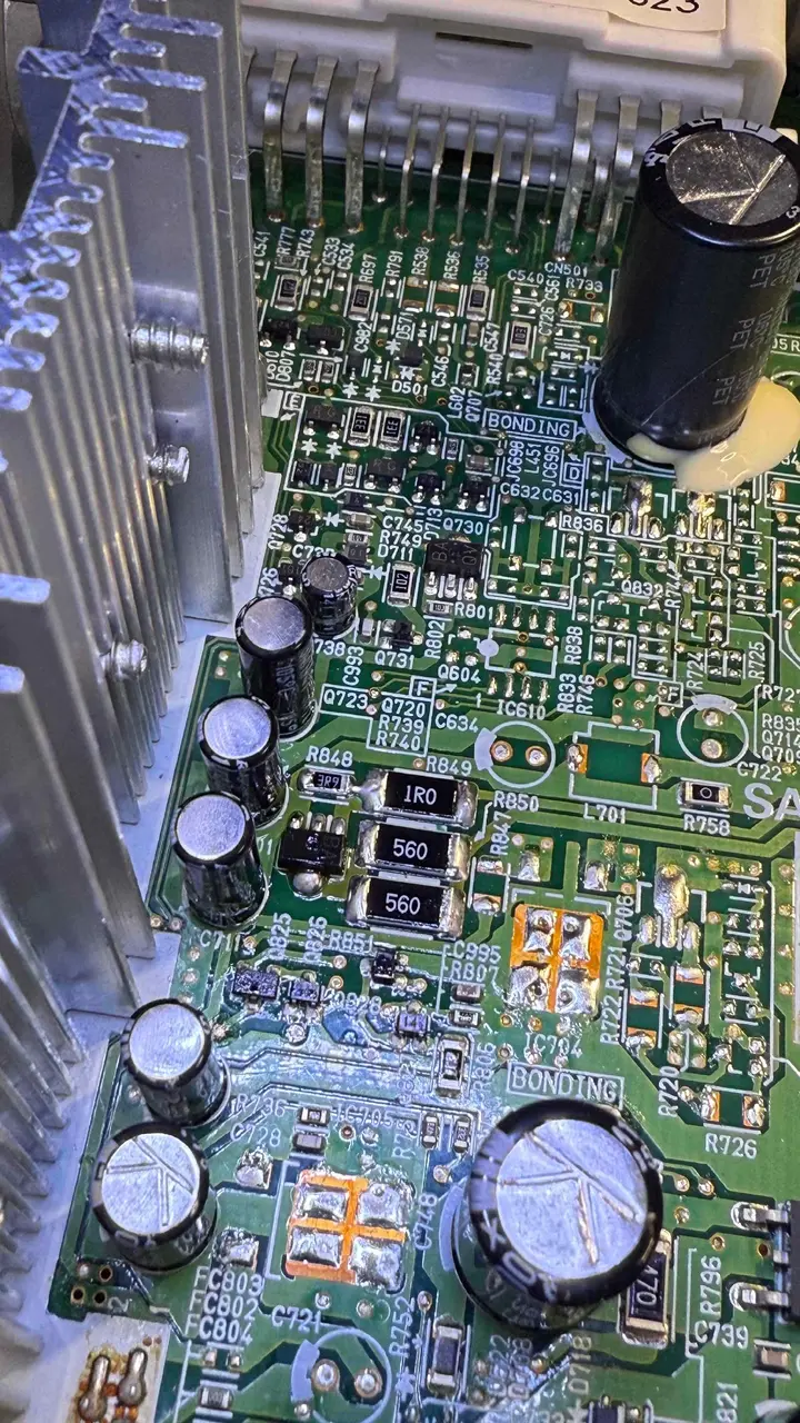

2011 Mazda2 Sport - No Sound from Speakers?
Yes, I confirm that its these 3:
Thanks ziddey for providing the picture! Let us know if it works for you too.
Big thank you for posting this information! I was able to get my wife's radio fixed today. Indeed, 2 of those 3 resistors were loose. As I re-soldered them they even shifted because only one side was actually still attached. I topped off the solder on each one and reassembled and the radio is working perfectly again! It took longer to take the radio out of the dash than to resolder it.

I figured it would be easy to diagnose something so responsive to physical impact.
So I opened mine up and tapped around the board with a stick until the sound came back.
Hey jdbens, just wanted to thank you for posting this diagnostic. I had a similar problem (Radio had power and buttons worked, but no sound) and tried your solution soldering those 3 SMD resistors and it worked like a charm. Took a few hours for the whole job, probably saved hundreds of dollars, thanks!
So glad I found this forum. I just tried reheating the solder for the 3 SMD resistors (tbh I was skeptical that it would work as there were so many solder points on the board)...but it did work and radio has sound again!! Thanks to jdbens and others!!
Refreshed solder example for any other new people to this forum, confirmed this configuration is working. I was surprised by the connection from 1R0-SR9 but my repair guy let me know that they tested as on the same circuit so he made sure to get that connection. Due to my past amateur experience I would have thought you always make sure the resistors touch only their obvious contact points.
Thanks a ton for the info and photo @jdbens, this worked for me! Nothing looked amiss with the solder on those resistors, but a quick heat up and reflow… and the stereo is now operational again. 🙏
