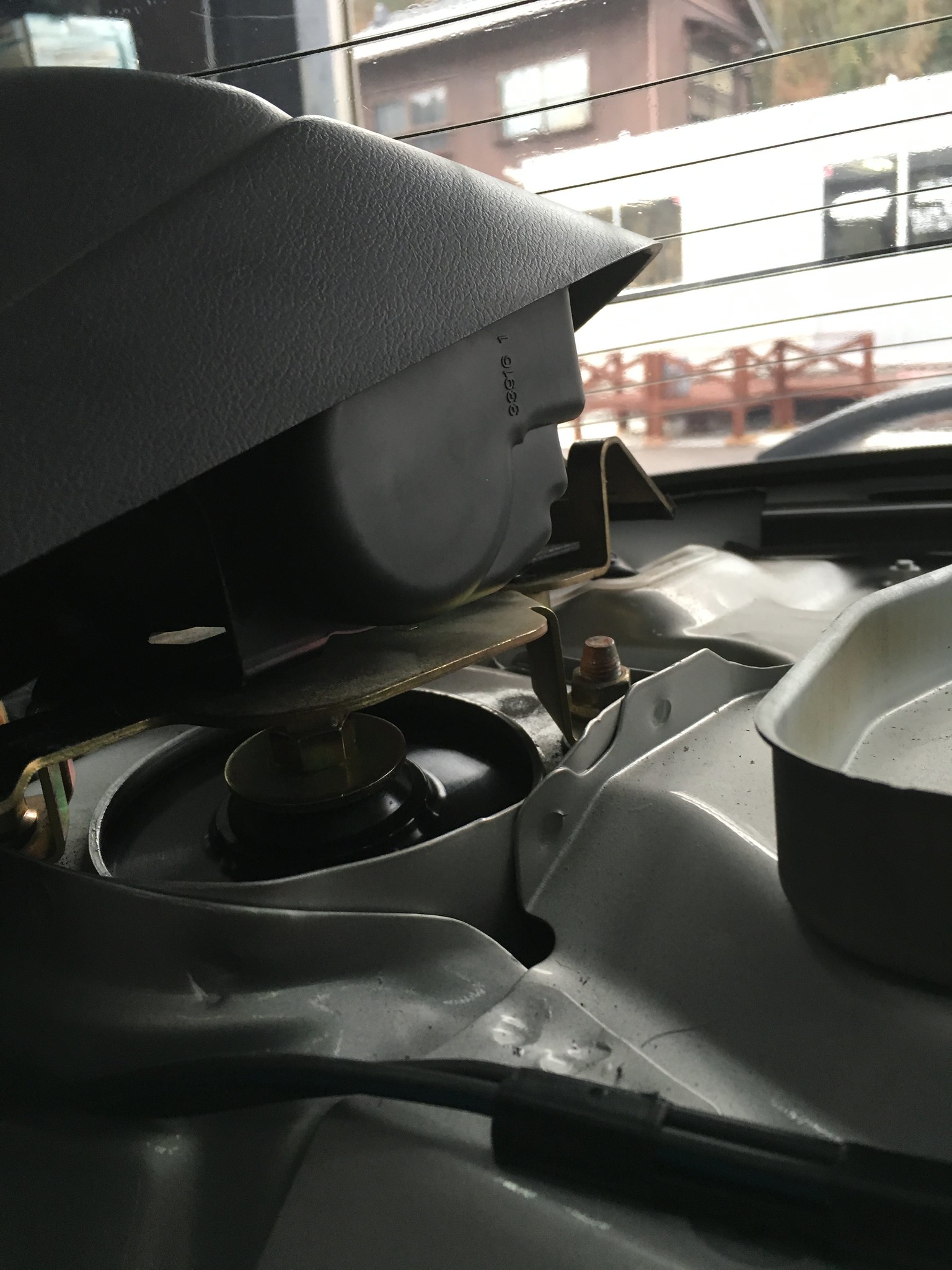

Yes! Unfortunately we did not go ahead with my trunk idea because as you know, the rear seat belts mount to a bracket that sits right over the rear suspension mounts and if I want to keep my Cosmo street legal in Japan, I have to keep the belts mounted as they came from the factory (if I understand the rules correctly). That fact combined with my desire not to cut holes in the factory interior made "operation rear coilover adjustment" just about impossible. :(
So for now, the rear interior will need to be taken out in order to adjust the rear coilovers...Fortunately, I'm liking the current setting so not a major deal at this time. :)

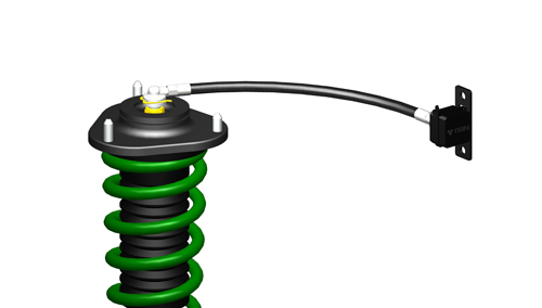

Thinking about it some more, there is probably a way to make it all work without cutting things up (such as that Tein EDFC system). Wait a minute...After just checking the Tein website, I spot this...Tein "Motor Extension Kit"...Here are pics from the site...
https://www.tein.co.jp/e/products/img/ext/ext_01.jpg
https://www.tein.co.jp/e/products/img/ext/ext_02.jpg
Info page... https://www.tein.co.jp/e/products/motor_ext_kit.html
Very similar to my trunk idea but have it be manual...Hmmm...Food for thought! :D

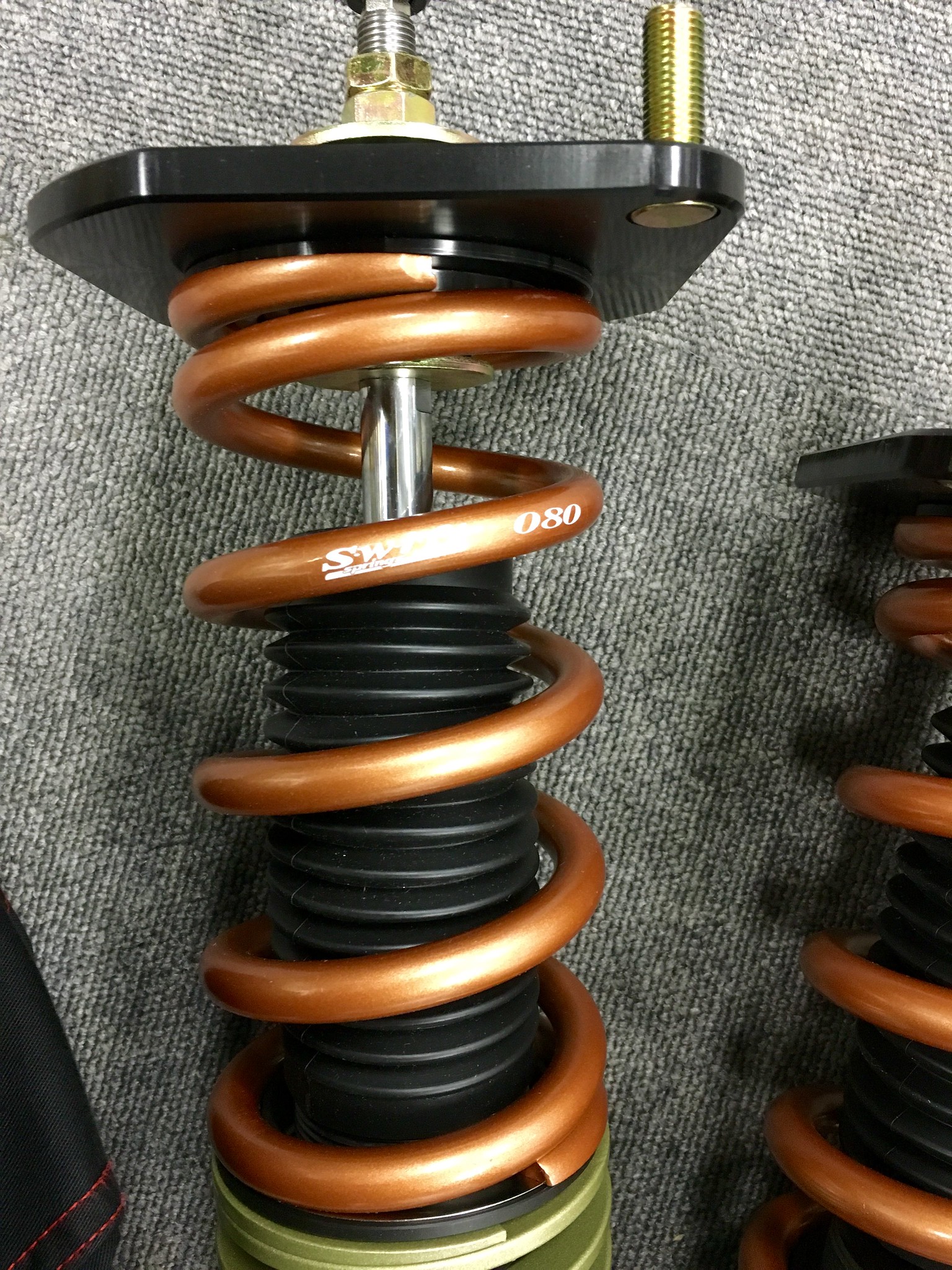

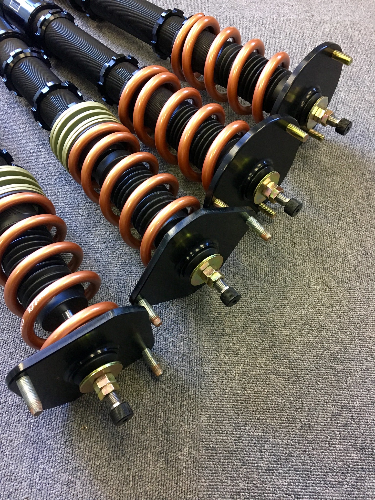

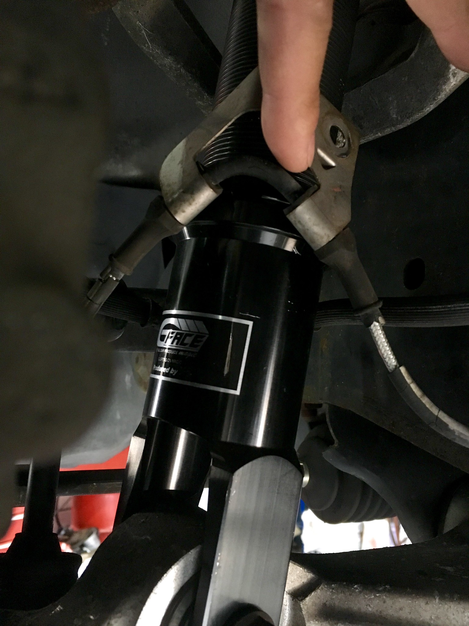

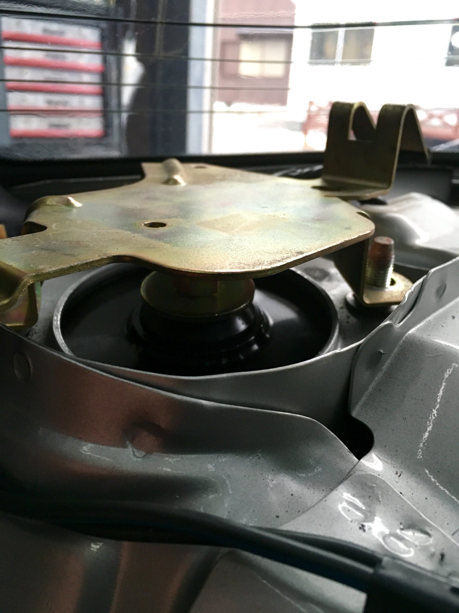

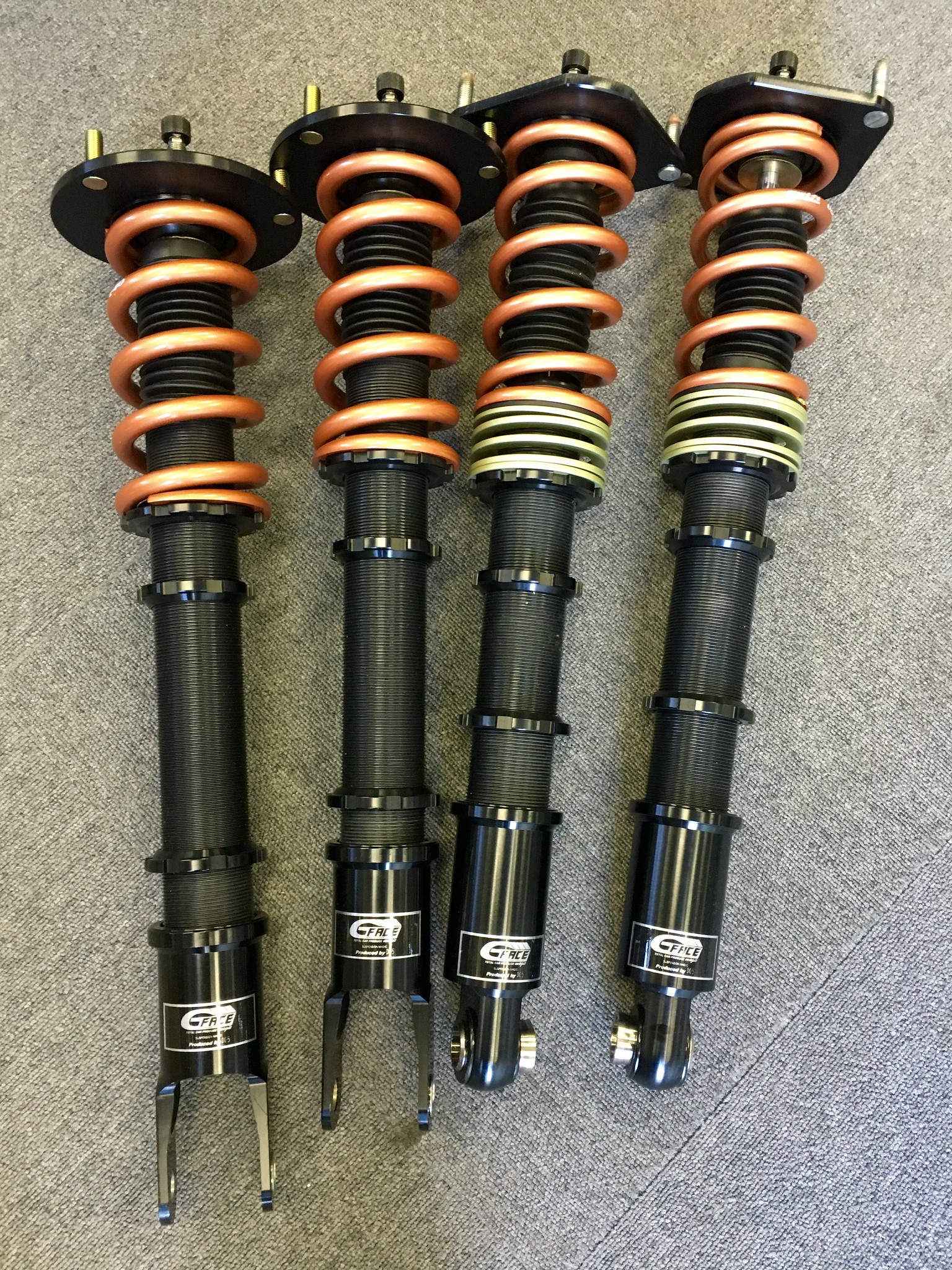

So it turns out that a few "adjustments" needed to be made to my custom DG-5 coilovers after initial receiving them. They needed to be lengthened and have the top mounts changed in order to "become one" with the Cosmo.
Below you can see a couple shots courtesy of Kawato-San showing the freshly updated coilovers ready for install...

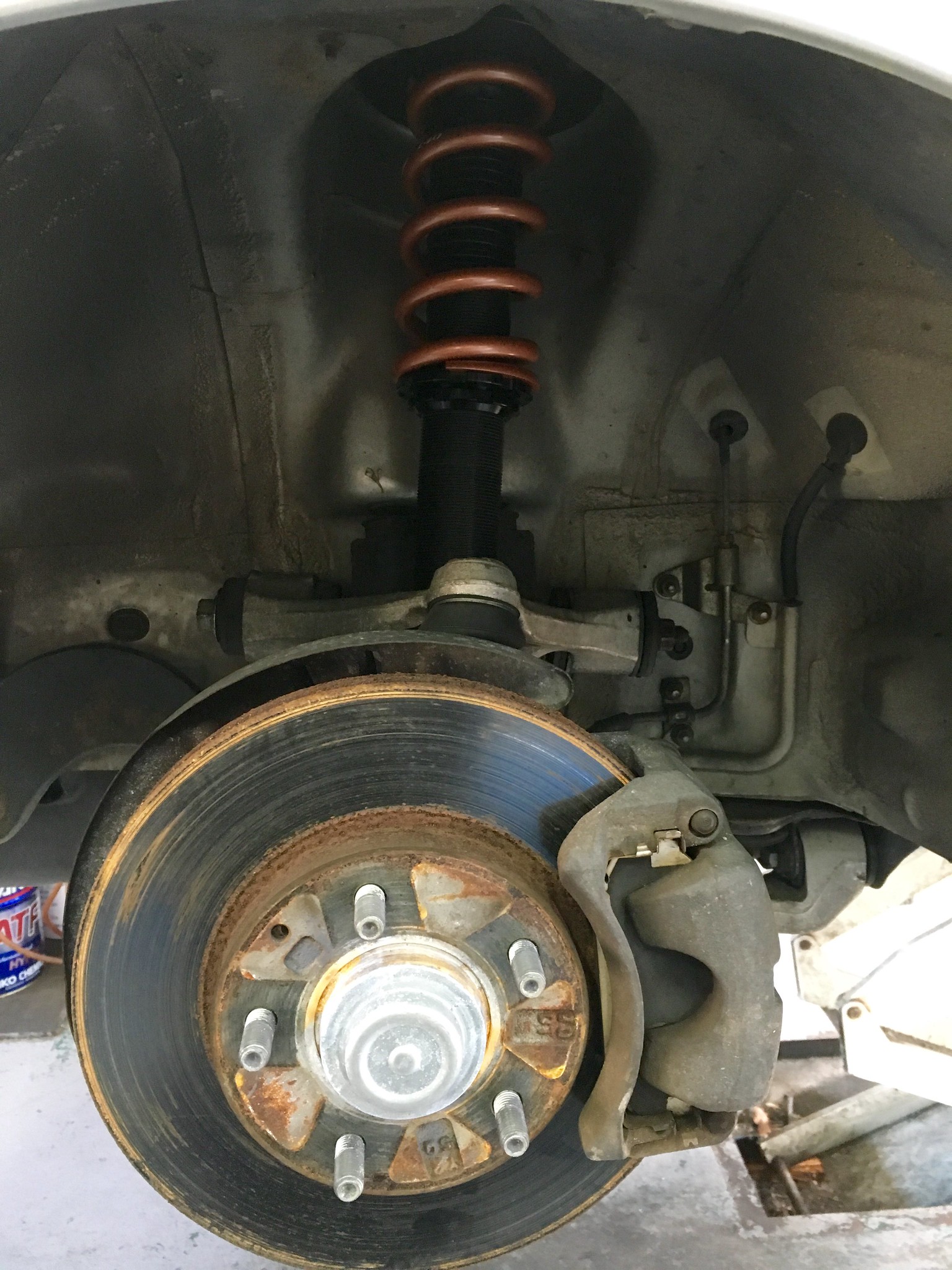

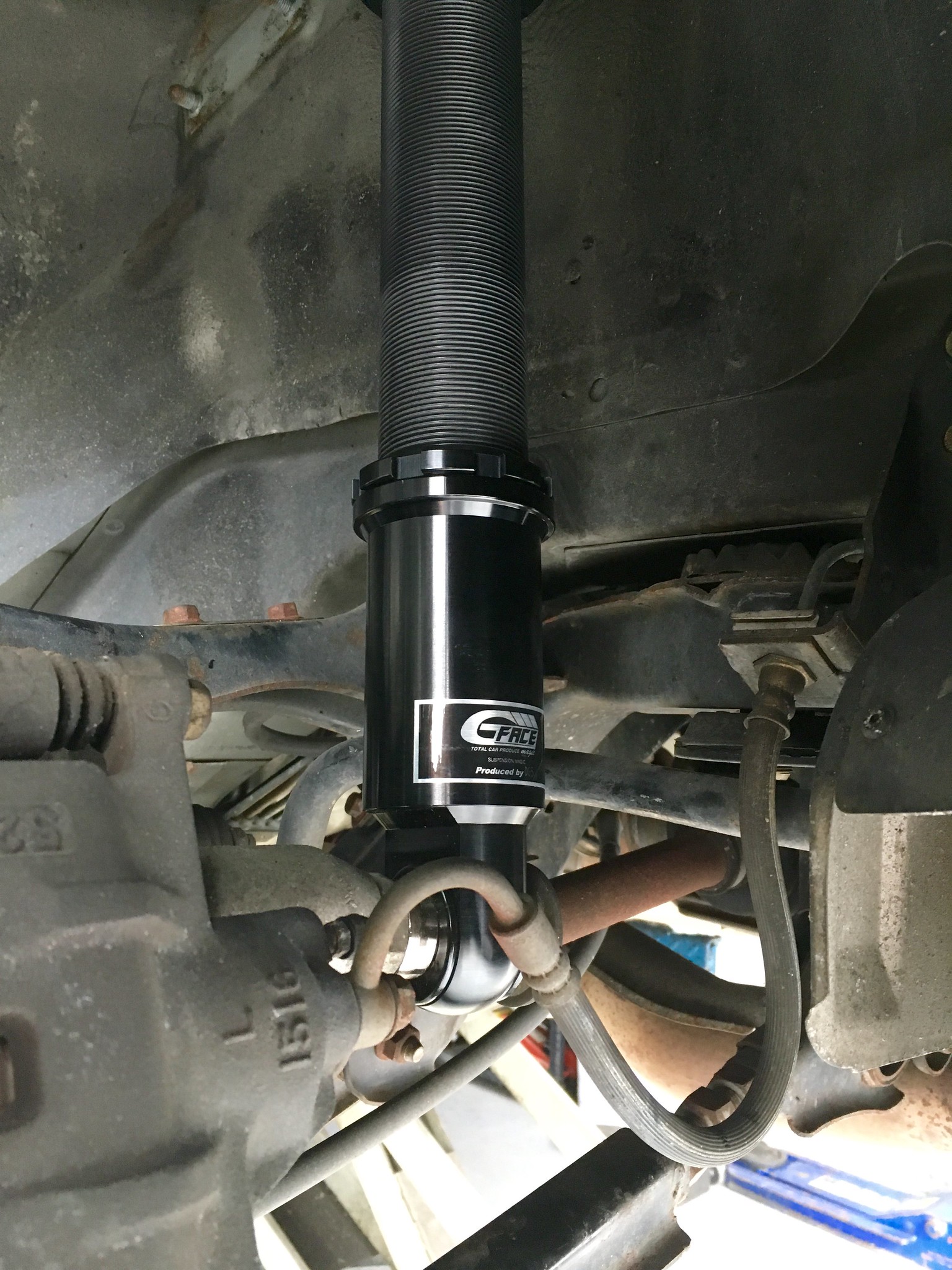

Here are pics of the updated coilovers mounted on the Cosmo thanks to Mr. TCP Magic...

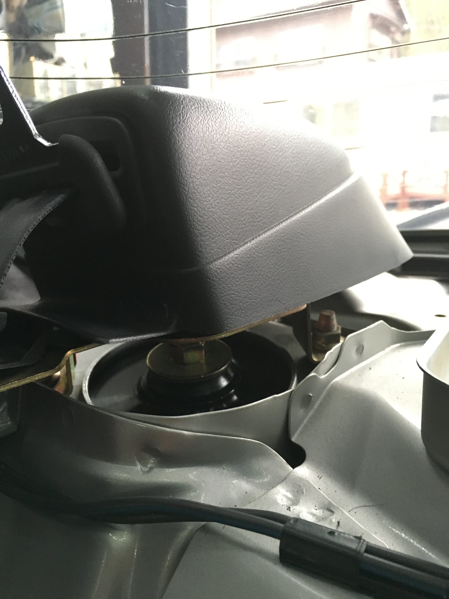

These are pics from Kawato-San showing how the rear seat belt mechanism is mounted and where the coilover adjustment knob is located (sadly)...

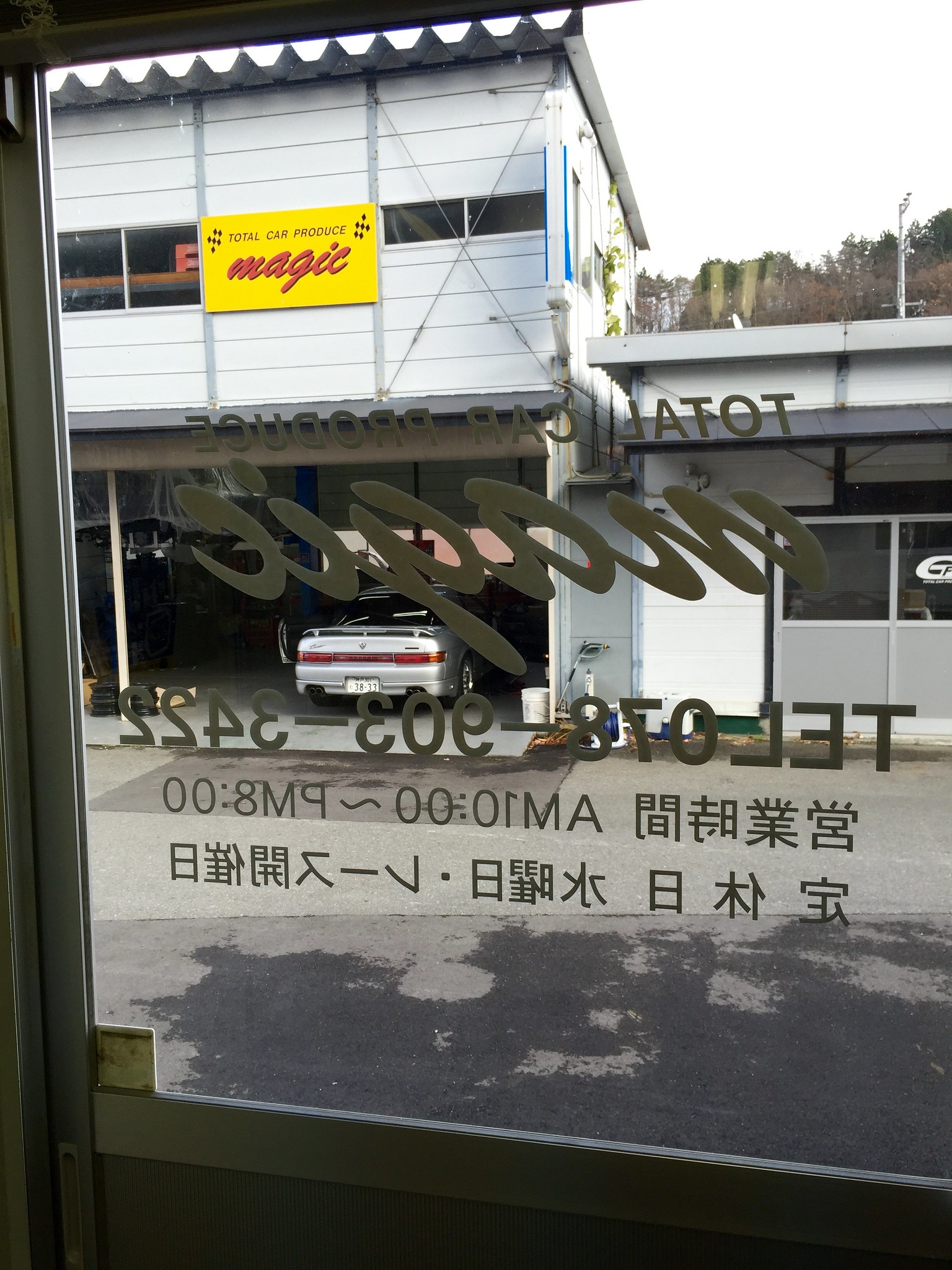

This is the view from the TCP Magic Office of the Cosmo having the interior put back in, fortunately it only took an hour!
Here's the office and a view of the showroom where the TCP Magic Race Cars are kept...

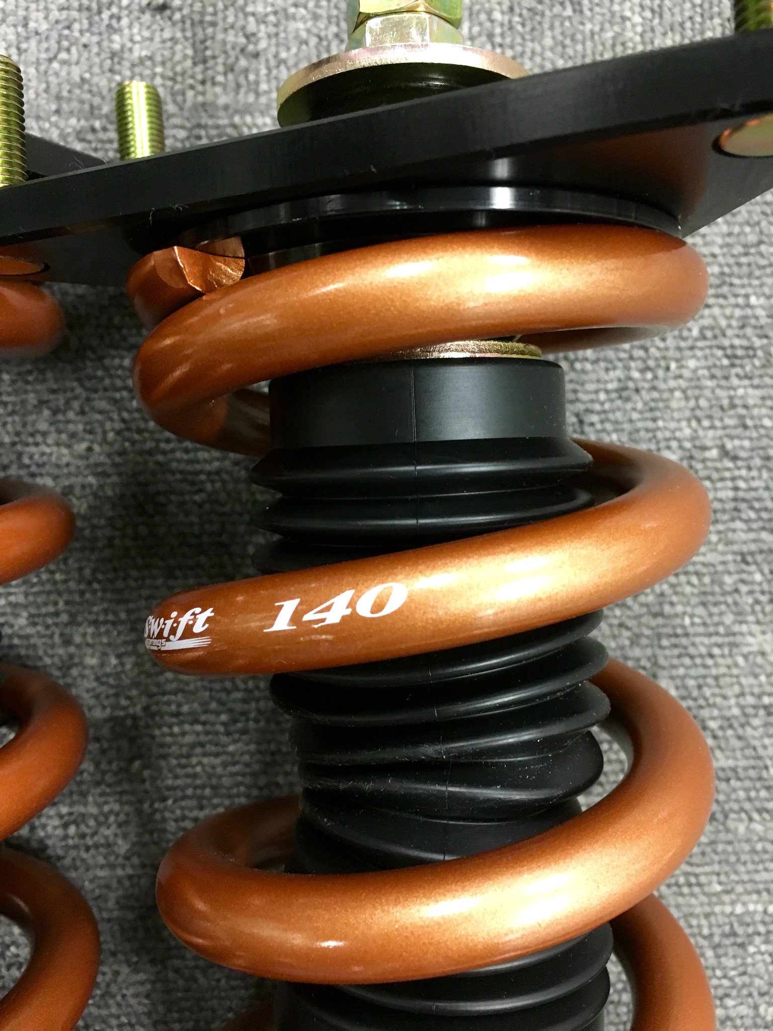

If anyone is interested to know the spring rates and current settings, they are...
* Front Spring Rate: 14kg
* Front Dampening Level: 12 (0 to 30 range and lower equals harder)
* Rear Spring Rate: 8kg
* Rear Dampening Level: 17 (0 to 30 range and lower equals harder)
For those of you that are still with me, lol...Here's how the Cosmo sits now, which is not much different actually but to me it looks and feels COMPLETELY DIFFERENT and that is not an exaggeration! The rear has been dropped a bit and the front has been slightly raised and leveled...

Wow what the...that's the first time I've seen the rear seat belts like that! My rear are just lap belts, and they tuck nicely under the seat cushions, so are all the other Cosmo's I've seen. Do you have pictures of the rear belts with all the interior trim back in?

About the Belts...Really? Yours are just lap belts? Got a pic? Unfortunately, I can't seem to find any pics of the rear deck at the moment but I can assure you mine are not lap belts! You can see them for a second in this video I made years ago (literally) when I first got the Cosmo (a few changes to the interior since then)...
<iframe width="640" height="480" src="https://www.youtube.com/embed/ZoWzj4hdwmU?rel=0&controls=0&showinfo=0" frameborder="0" allowfullscreen></iframe>
Could it be because mine is a '95? Perhaps there was a law change or just a next year model tweak?
