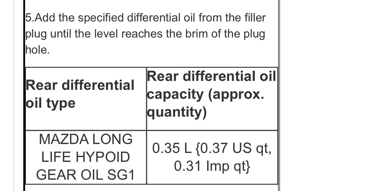

not bad to do at 30k-its pricey but only takes a quart to do job...i used a jack/stands and it took an hour-parts guy asked why i need to buy 4 quarts-said i have owned honda/acura they always had me chasing my tail to get more fluid,and i may do it at 15k just cause i can
Darn Mazda diff and transfer case fluid is $30. Takes 1 quart to do both.
STILL $30 vs being down and the cost to replace. I'll change mine...

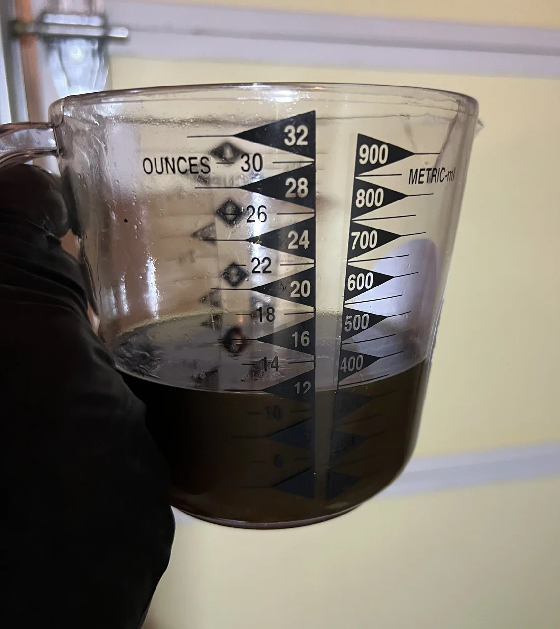

When I drained the fluid out of my CX-9 at 70k kms, it looked like brand new engine oil. Darker than the brand new fluid, but not bad by any means.

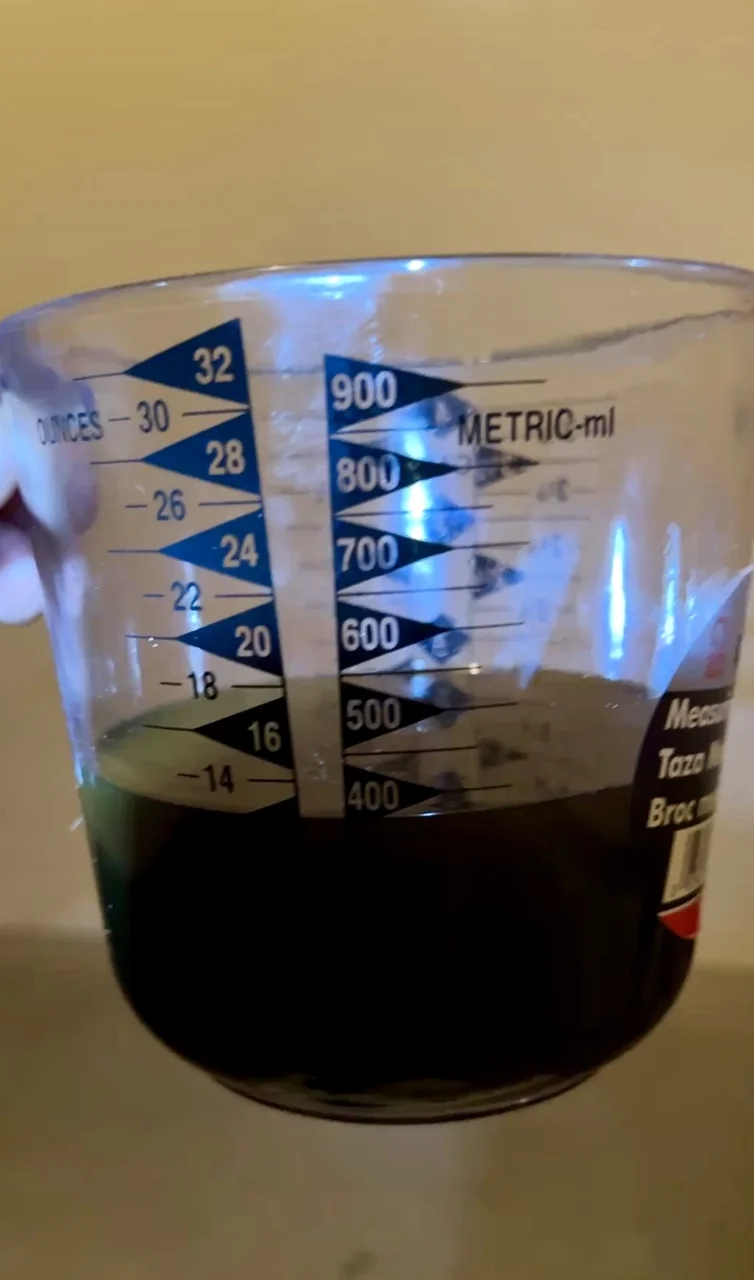

For me, change in color indicates contamination. We can debate if this is enough to damage the gear boxes or send in a sample and have it analyzed and know.
I'll send a diff sample on our CX 5 at 30k and report back. We were in a time crunch to change the fluids on my friends 2nd Gen CX 5. So no sample collected.
I've seen contaminated fluid, diff, power steering and hydroboost wear out seals and the shafts. So bad that we changed out the P steering pump, hydraboost and diff pinion. Bearings were running ruff in the P steering pump. The shafts had grooves where the lip seals "seal".
When inspected, the differential or PTO oil is dark or black. During production, differential ring and pinion gears receive a manganese phosphate coating (commonly referred to as black oxide).
This coating forms a porous, oil-retentive surface that improves boundary lubrication and reduces adhesive wear during initial contact cycles. Designed as a sacrificial layer, it is gradually removed under load throughout the break-in process.
As a result, after the first few hundred miles, or at the initial gear oil service interval, the lubricant may appear darkened by the worn-off coating. It will contain trace ferrous particles from the normal run-in of the gear teeth and bearing surfaces
