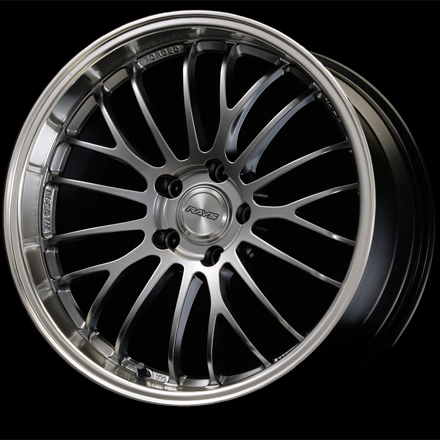

Another final note...Unfortunately my rims are starting to show their age (they were on the Cosmo when I bought it and may be from the 90's)...The surface is starting to bubble / flake off (especially between the spokes) and to restore them might cost the same or more than a new modern set of Rays / Volks...So, I'm thinking of replacing them with...
C345 Primes
or if I can find SF Winnings still in stock (discontinued)...
Not sure yet...First priority is the suspension now...Stay tuned and thanks for checking out my update! :D
Definately the C345 Primes - they are very similar to the ones that I used to have until I upgraded the brakes and they didnt fit anymore!

Yeah...I'm leaning heavily towards the C345 Primes but good point to make sure there is space for future brake upgrades!
