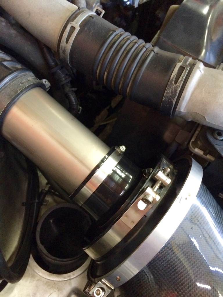

Hey Ant I have a question about your intake. I ordered the AutoExe unit also and its arriving soon. Did you keep that stock air diverter tube there after you remove the stock intake?
Do you think the intake is getting sufficient air being behind the headlight? I was thinking of cutting out a section of that rubber strip thats on the underside of the leading edge of the hood.
Sorry for the late reply, I've been super busy this week! Did your intake arrive? If so, how do you like it? I've had mine for years now and it has been trouble free...As for your questions...Do you mean this large open rubber tube coming up from the bottom there..?
Is so, yes...I've kept it there...What are you thoughts? Better to keep it or not? I'd prefer a cleaner look but I haven't thought yet about how to achieve that...Hmm...Food for thought!
Yup that's the tube I'm referring too. I don't really see it doing any harm being there. I was just wondering if there was a way utilize that pipe with the new intake, I haven't gotten yet so I was unsure of the fitment.

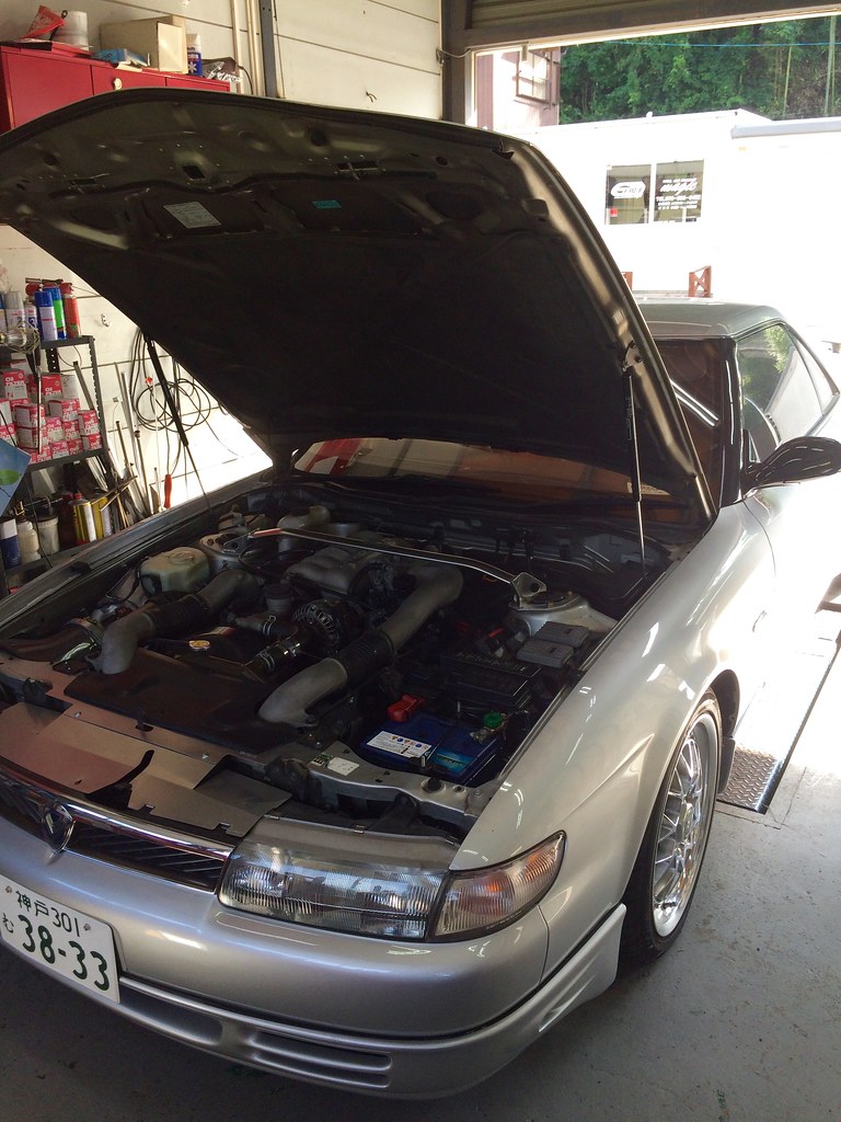

Time for some love and maintenance!

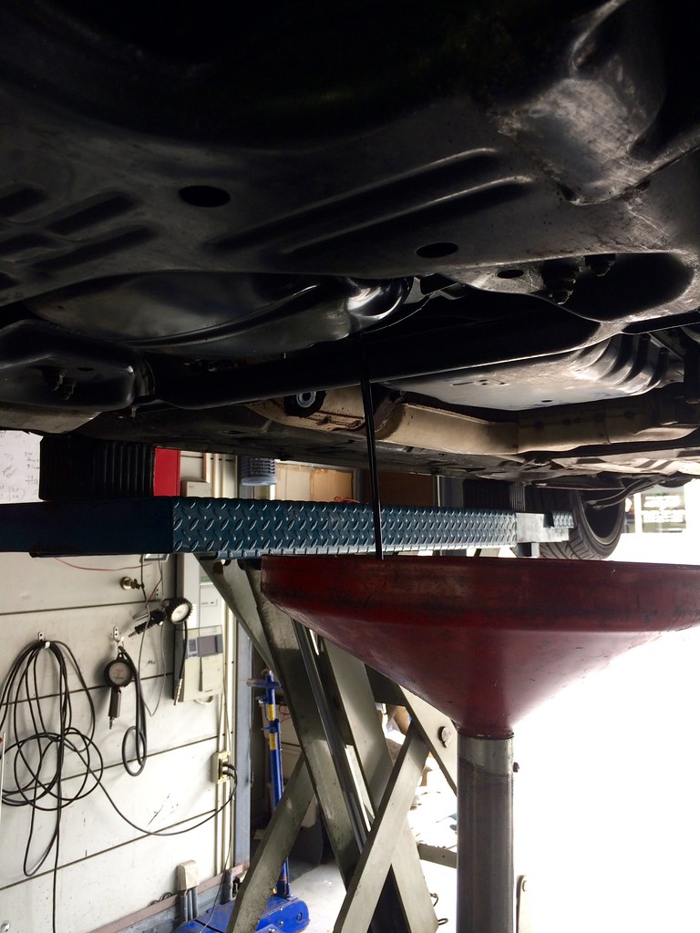

Sticking with Speedmaster for engine oil...
BuhBye old oil...

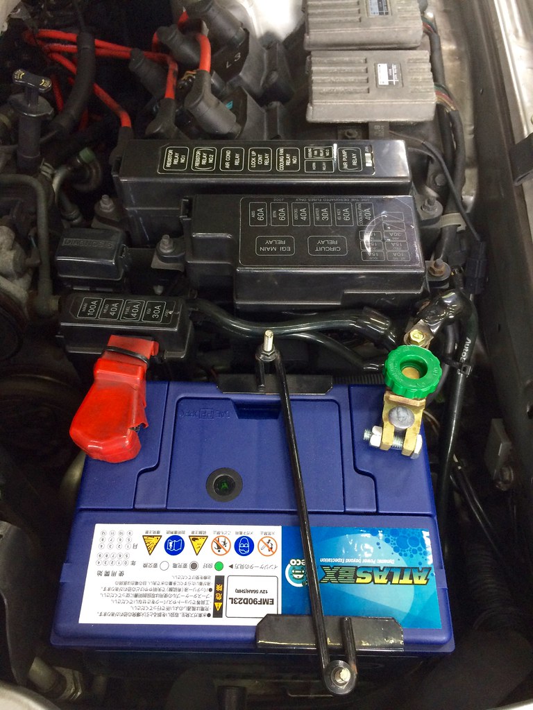

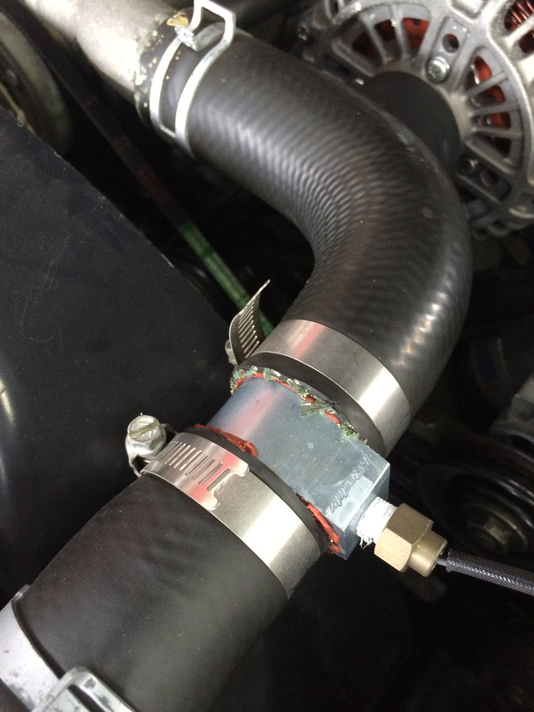

New battery...Also sticking with the brand ATLASBX because it has proven to last longer in the Cosmo than any other battery I've tried including Optima and Mazda's own "premium" option...PLUS, it's cheaper...A LOT cheaper!
Radiator hoses checked and still good to go for now...

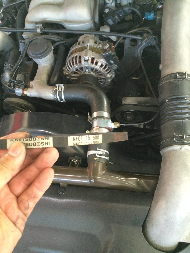

New air conditioning belt...Last summer I started hearing a loud squealing sound under acceleration and no it wasn't a family member, it turned out to be the air conditioning belt stretching / getting old (at least that's what we think)...I'll know for sure when I pickup my Cosmo this Friday, put on the air and wake up the 20B. ;)

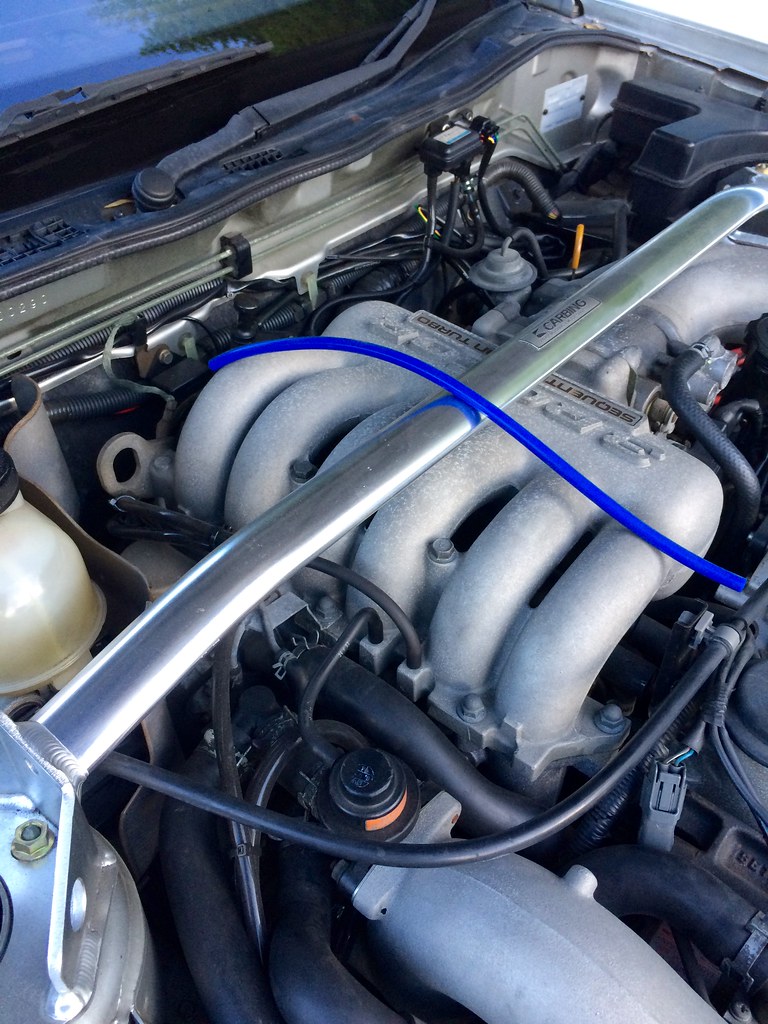

Replacing the blue silicone tube from the HKS F-CON V Pro and Boost Controller install with a black one simply for aesthetics...
Replacing this piece as well and I must say, I really like the look of that glossy black silicone (in the engine bay okay :p )...I think I might use it to replace more hoses and tubes in the future, seems to brighten up the engine bay nicely!
Here's another angle of that sweet silicone... ;)

Nice update. I too went for the glossy black silicone recently while doing some updating. Samco radiator hoses and the elbows/connectors for the 505zoom air intake box, MAF, TB. Of course it's no Eunos Cosmo but it is similarly silver. Always a treat to see new stuff in this thread.
NLA parts is always frustrating. I'm finding that's occurring more and more with my RX7 as well. Even what I consider to be "collision" parts are NLA, which is unfortunately should any of these cars be in an accident. Ebay Motors and Yahoo Auctions will become your friends.
Thanks! Cool, yeah I've never been a fan of the blue silicone, that glossy black really seems to compliment the EC engine bay and I'm planning on using more of it in the future. Next on my list to receive the black silicone treatment are the intercooler hoses. The plan is to use one normal hose piece and connect it to another hose that has a "ripple" (not sure what you call it) for flexibility using titanium piping. It should not only look cool but be more than capable of handling higher than stock levels of boost. (2thumbs)

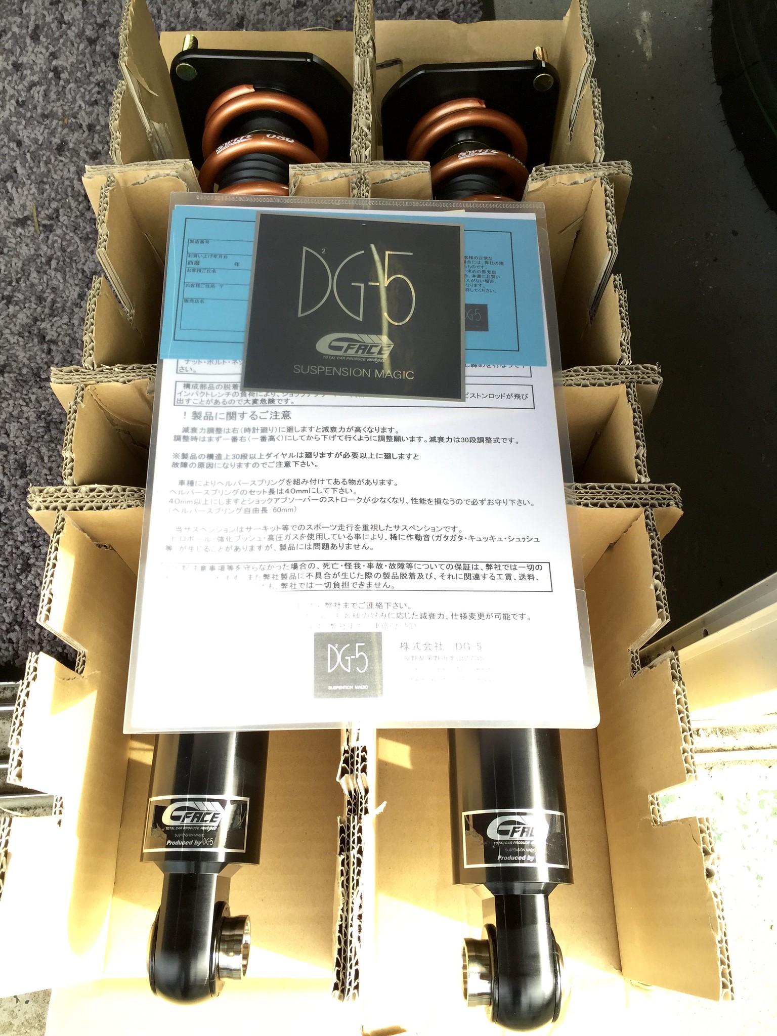

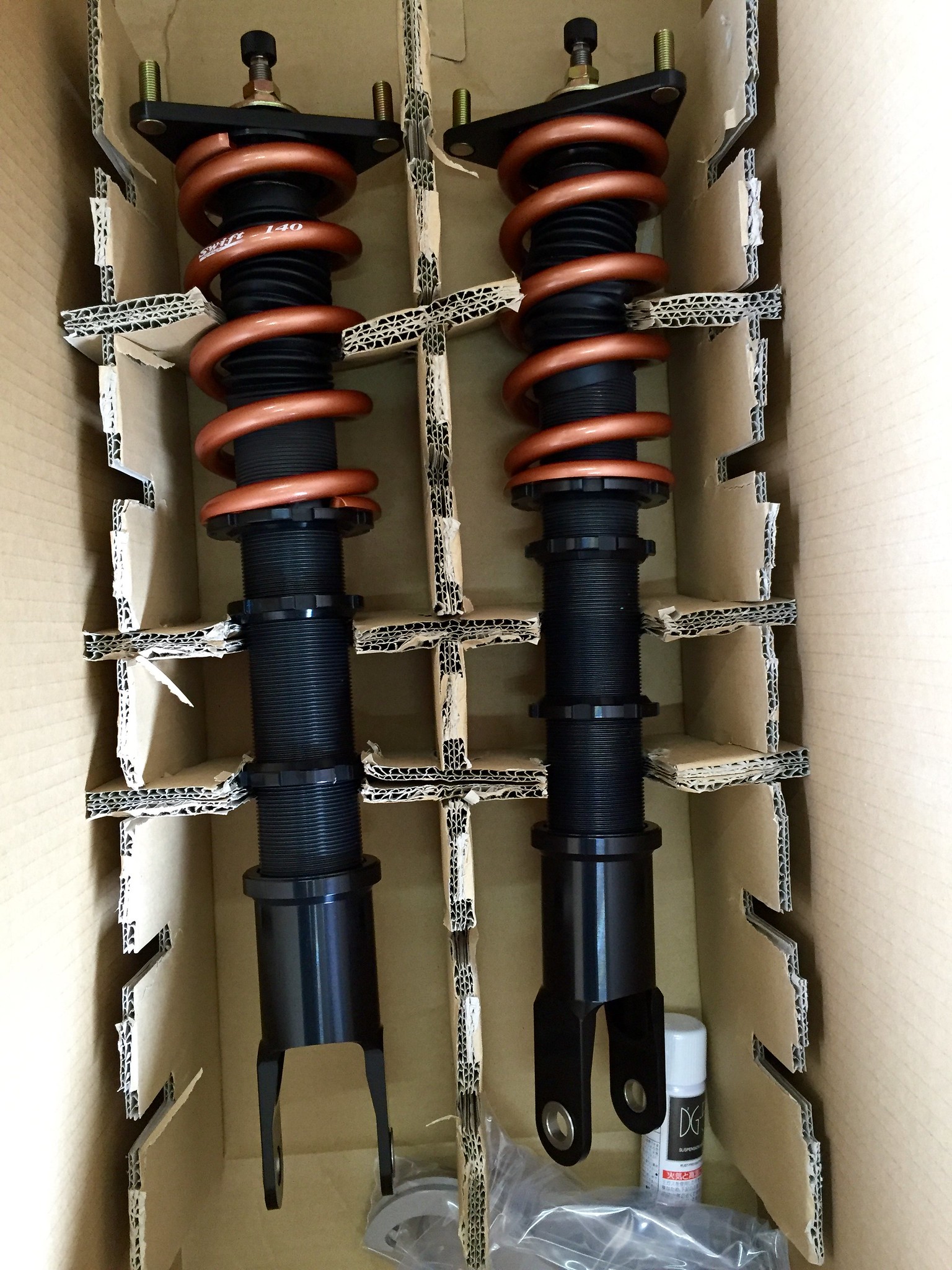

Now on to the update...It's official, the Cosmo is getting a long overdue suspension upgrade in the form of new custom DG-5 Coilovers. They are being made as I type this post, DG-5 is using the stock suspension off another Eunos Cosmo for reference. Kawato-San recommends the DG-5 coilovers as that is what all his RX-7 race / drift cars use including the twin turbo 4Rotor monster that Mad Mike currently pilots. DG-5 is a Japanese suspension brand and the coilovers are also made in Japan and use Swift Springs. Although they are often used for drifting, they can be set up for street and race use as well.
Here's a DG-5 Flyer from TCP Magic with more info...
I'm interested to see the quality of those DG-5's and how they ride. What're the spring rates? I have the Aragosta units with Swift springs and it's an amazing feelings set up for our cars.
It's interesting the image you pasted above shows an application for the FC3S RX-7 but I couldn't find anything on their site. It sounds like an interesting option if your mechanic recommends them on the shop race cars.
Me too especially considering how much they cost! Hopefully I will have pics of the coilovers and the install process from Kawato-San to post but note that I'm still waiting on delivery...At least I have my Cosmo in the meantime. As for the spring rates, good question...Let me confirm first and then I will post the details here...I've heard that driving a Eunos Cosmo with coilovers provides a "night and day" like difference compared to the stock suspension. While I'm running AutoExe Springs, they're probably from the last century (literally) and my shocks / struts are making noises when I drive over bumps etc...As you can imagine, I'm extremely eager to experience this difference for myself!

It shows up there. At about $2100 USD it's a pricey alternative but one I'll keep in mind. The spring rates are pretty much the same as those from other companies so it'll be interesting to find out what differentiates them from the others. I'll be paying attention when it's time for your upgrade.

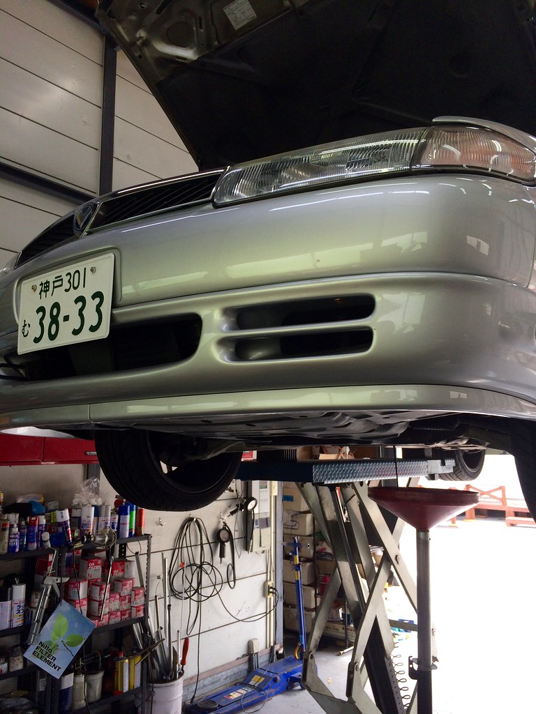

Finally...The Cosmo is currently "under the knife" at TCP Magic and I have photographic evidence with more to come (provided Kawato-San hooks me up with juicy shots of the install)...:D
I knew it was time to bring the Cosmo in for surgery when this pic popped up on my phone...;)
Here's the man, master mechanic and rotary guru himself holding up my freshly fabricated coilovers!
Here's a closeup of the DG-5 Coilovers from TCP Magic custom built for my Eunos Cosmo...
Now for some fun facts...Kawato-San says these coilovers are significantly lighter than the stock suspension. Perhaps even as much as half the weight of the stock setup! He also says DG-5 designed these coilovers specifically for my application and took into account all sorts of values such as the Cosmo's weight distribution etc. In other words, they didn't just slap together parts off the shelf and call it a day (at least I hope not eek lol).
Also, we realized that in order to adjust the rear coilovers, a hole would need to be cut into the rear deck (on both sides) to access the adjustment knob if I wanted to retain that option (instead of setting and forgetting). Being a fan of the "clean looks like factory look", I was not keen on having holes in the rear deck...So, while looking at the rear suspension via the trunk, I got the idea to custom mount a cable to each knob so that adjustments can be made by simply opening the trunk. To my surprise, Kawato-San nodded and said it might be possible and he will certainly give it a try...Note that he may conclude that it's not and then I'll be back to square one! Another option would be to install some sort of electronic "on the fly" system which would be cool but would add additional cost, complexity and risk of failure...Plus, I really like the idea of a simple and stealthy way to adjust the rear suspension. Also, I don't plan on making adjustments so frequently!

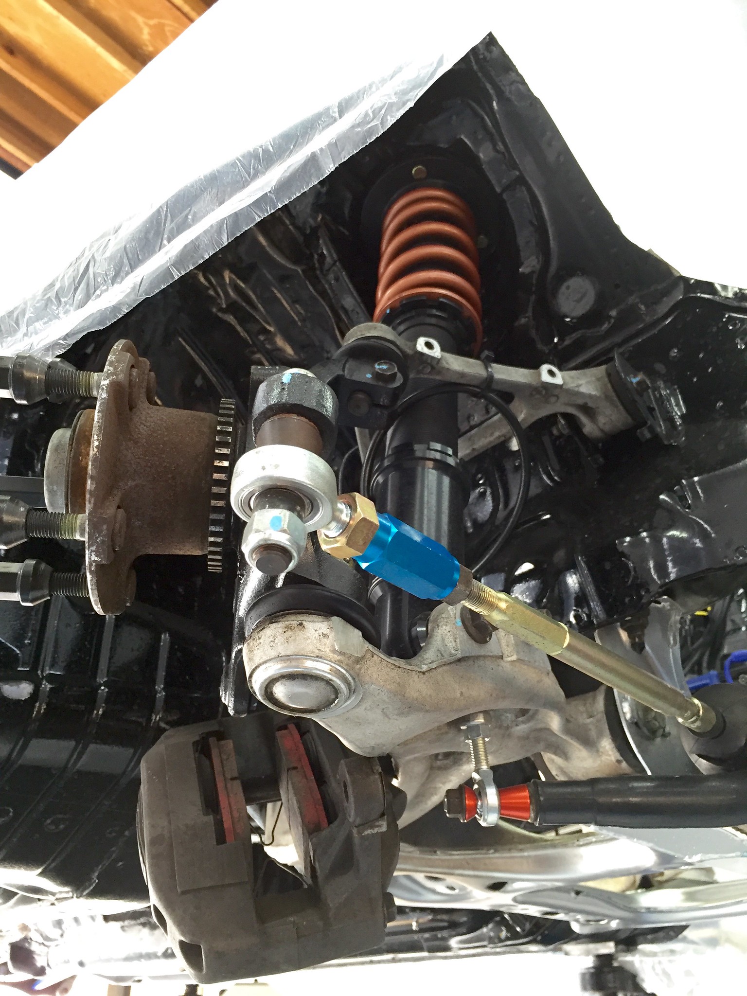

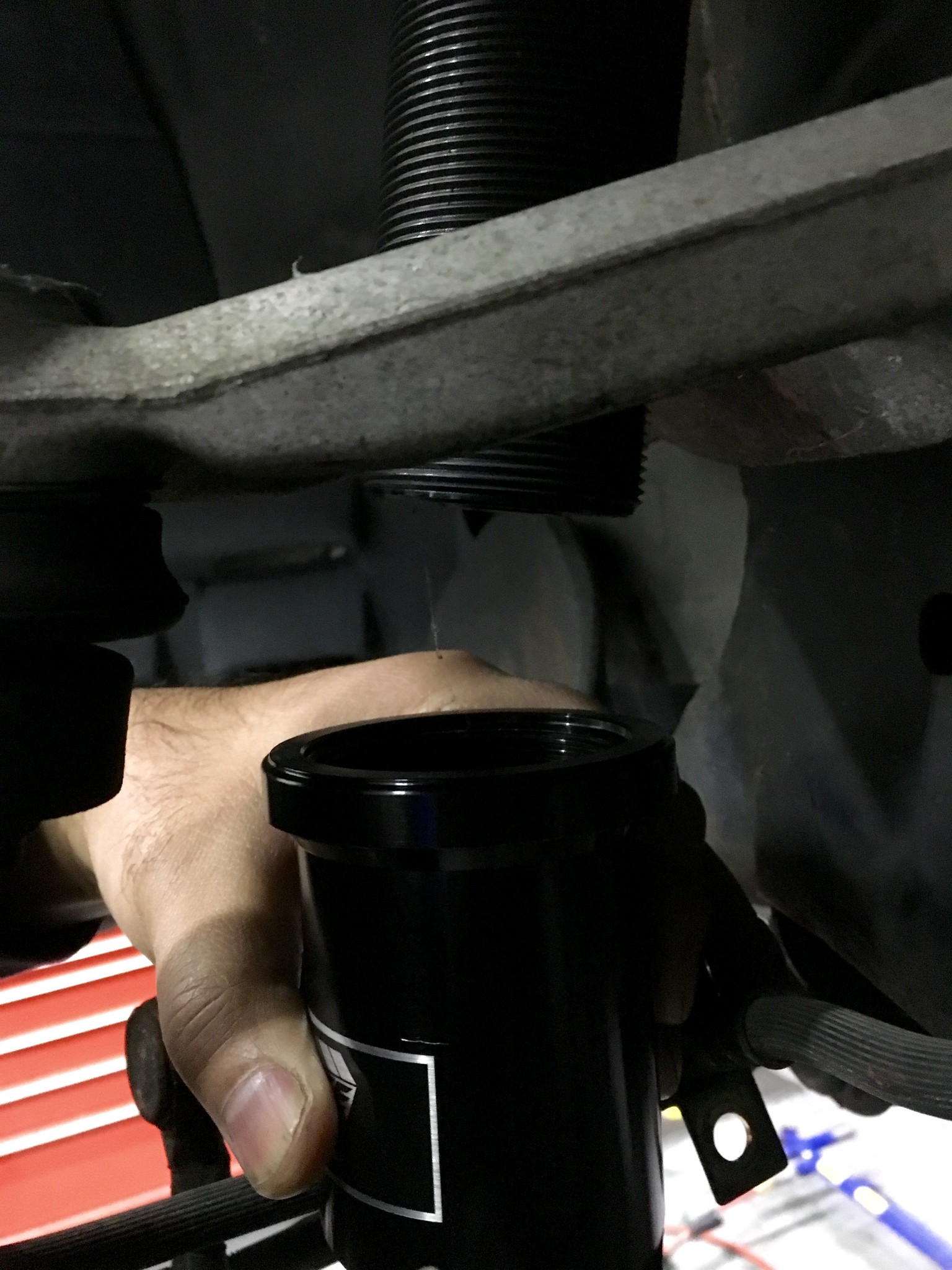

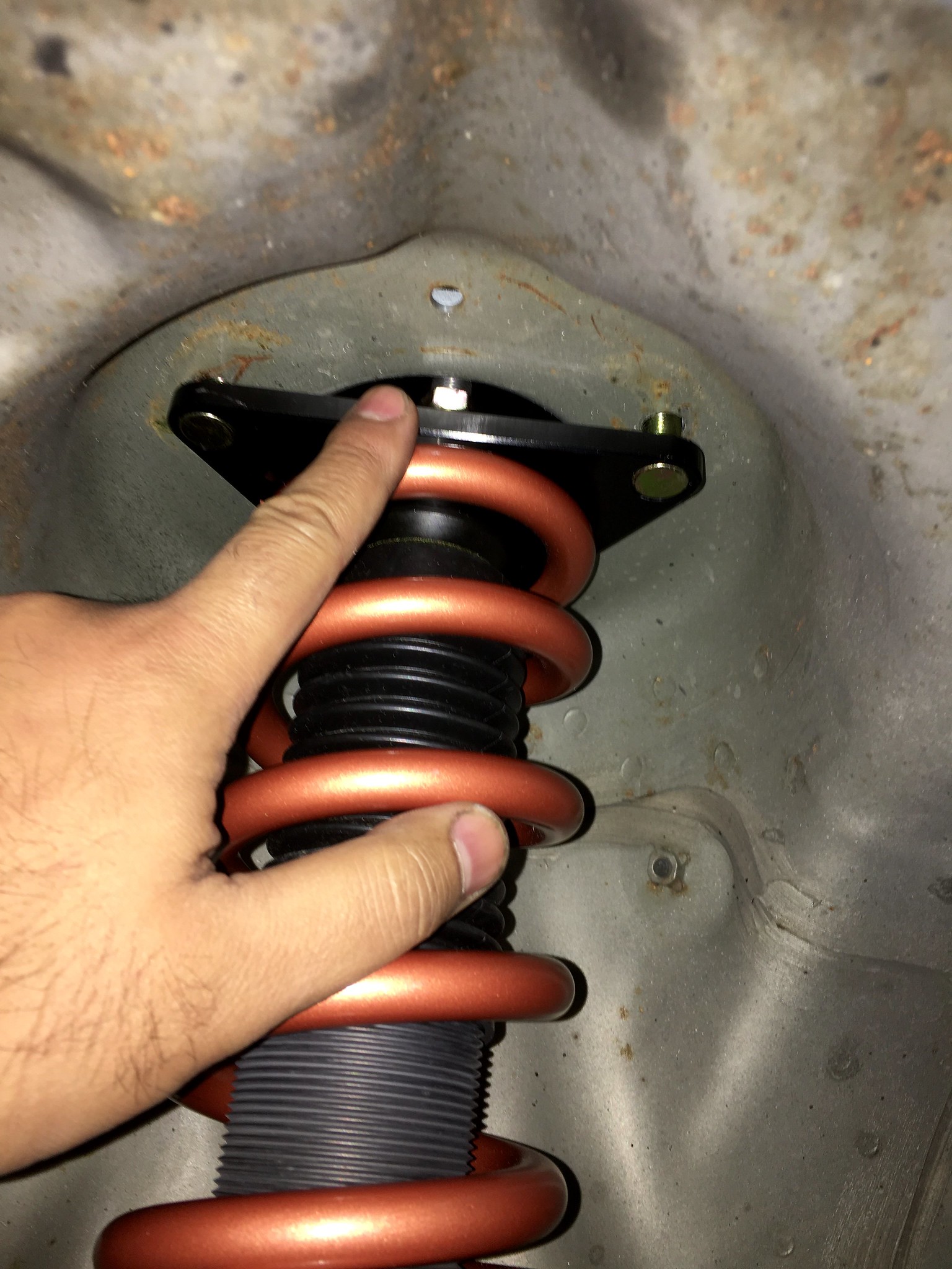

Unfortunately, the DG-5 install is taking longer than expected...It turns out further customization is needed to make the coilovers fit my Cosmo. It appears simply basing the custom coilovers off of a set of original factory struts etc was not enough as a couple major issues have popped up.
One issue is that they are not long enough...As shown to me in the pic below...
The other major issue is the upper mount which can be clearly seen in the pic below...
I was originally told it would take a week or so, it has now been two weeks. I'm not too concerned because I trust Kawato-San will sort everything out and I would much rather he do the best job possible than try to hack things together to save time. That said, I'm hoping his next text message contains good news and more juicy pics...We'll see!
