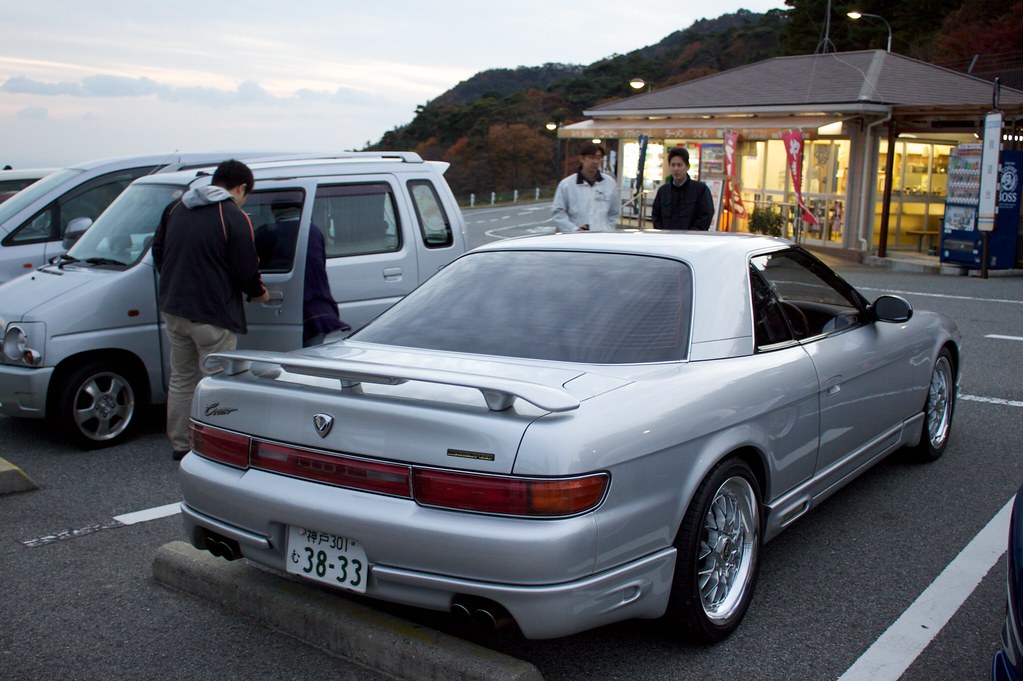

While the RX-8s could whip around the bends with ease...My EC required a bit more "man handling" yet I must admit...I was VERY impressed with my EC's ability to handle the curves and accelerate or decelerate on demand...I'm sure with upgraded brakes and proper suspension (in addition to strut bracing front & rear), you could really take on the mountain with confidence and easily keep up with any RX-8...(drive)
Here are a few pics from the rest stop near the top of the mountain...:D

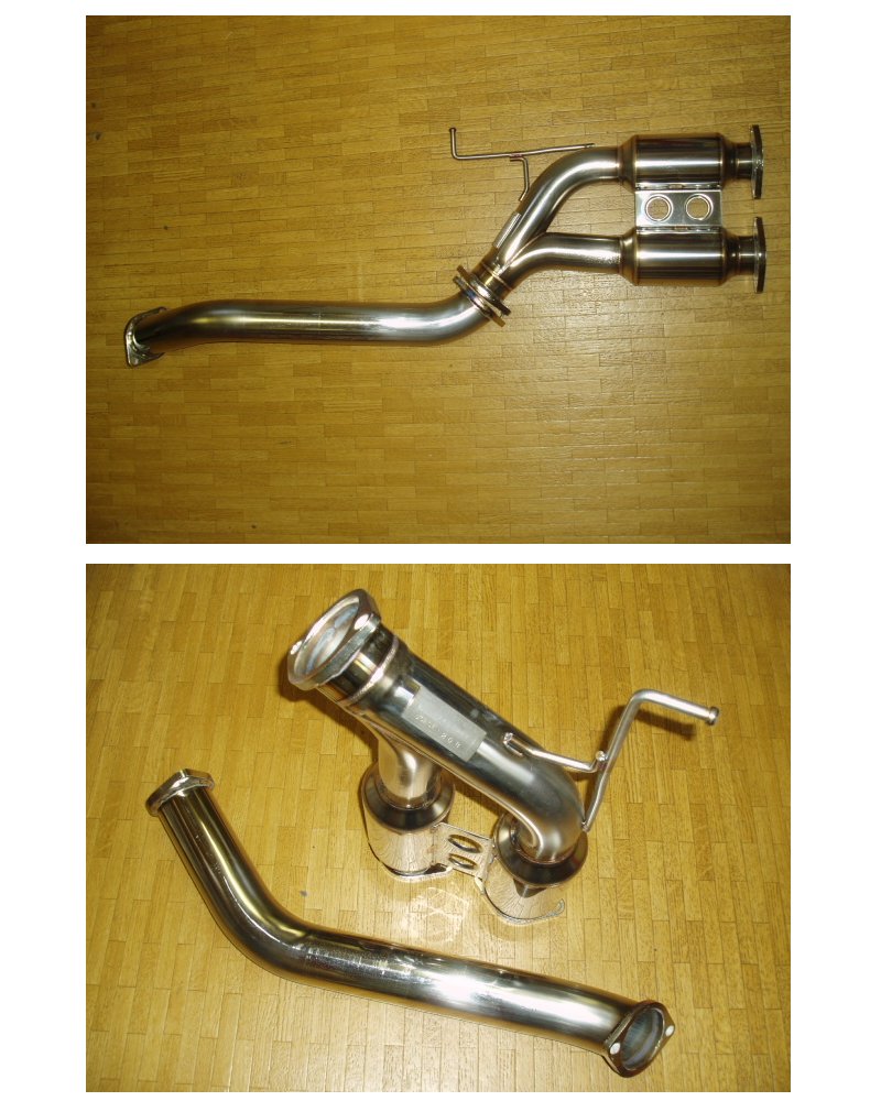

From http://www.stardust-factory.com/ *Look under "Shopping"
They are asking from around $2,400 to $2,800 (U.S) for this badboy and I'm not even sure it's really street legal!?
I heard that in Japan you have to get highflow / non-factory cats tested & certified for street use which can be very expensive...I haven't confirmed this information yet but I will when I'm ready to upgrade my exhaust setup.
Another "universal" option might be this lil' badboy from SARD:

Looks to be a very high quality unit but I have no idea if it's able to handle a rotary engine and if it won't throw any codes etc...Hmm...
