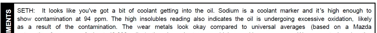

Just received my transmission fluid analysis back and surprised to hear they found a small amount of coolant in the fluid. This explains the poor shifting performance and quick deterioration of my transmission fluid. Can anyone suggest where these two fluids cross paths in the engine so I can replace? I see there is a transmission cooler, but I'm not sure if the fluids can mix there, if a seal was bad or a crack. 2018 CX5 2.5. Thanks for any help

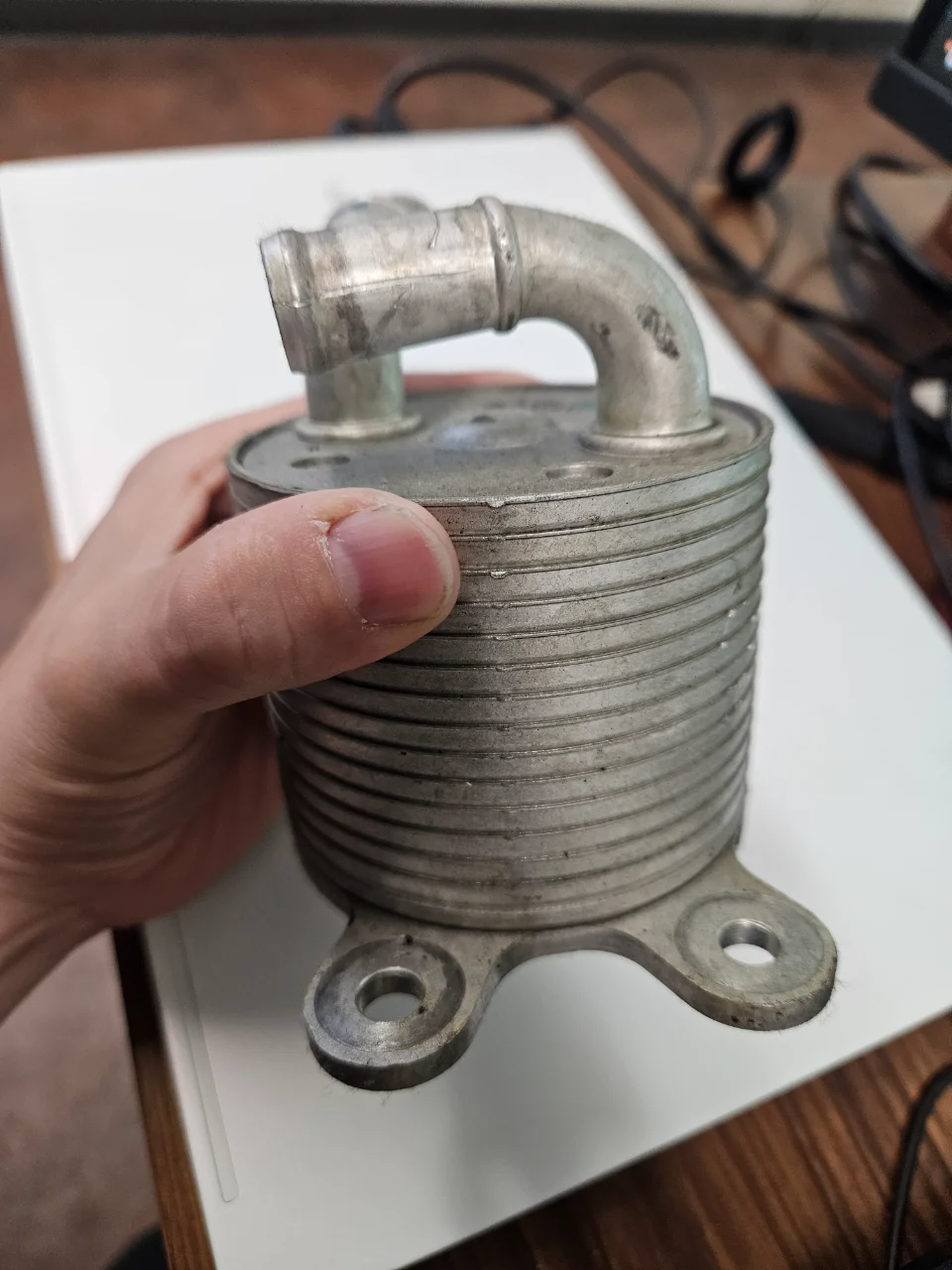

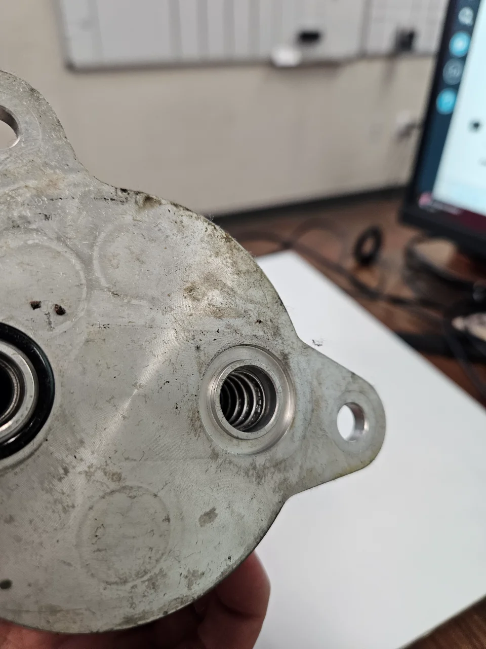

The only way other than someone putting coolant into the transmission itself is the heat exchanger intermixing. Inside the exchanger are multiple passages that have coolant, if one of those starts to leak you will get coolant in the fluid, this effects all brands that use exchangers. The problem is that any coolant inside transmission fluid damages the clutches, glycol specifically starts to attack the glue that binds the friction together.

Very helpful insights, thank you. I'll replace the heat exchanger and hope that the very low contamination hasn't yet destroyed my transmission clutches!
