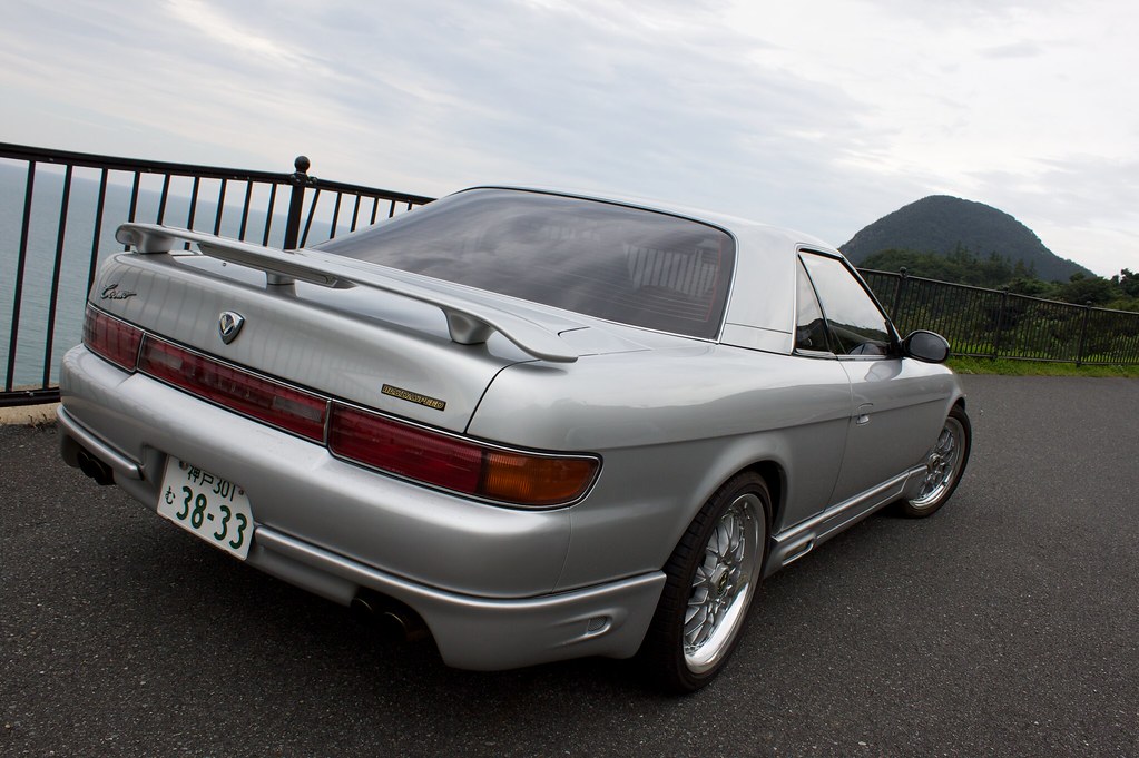

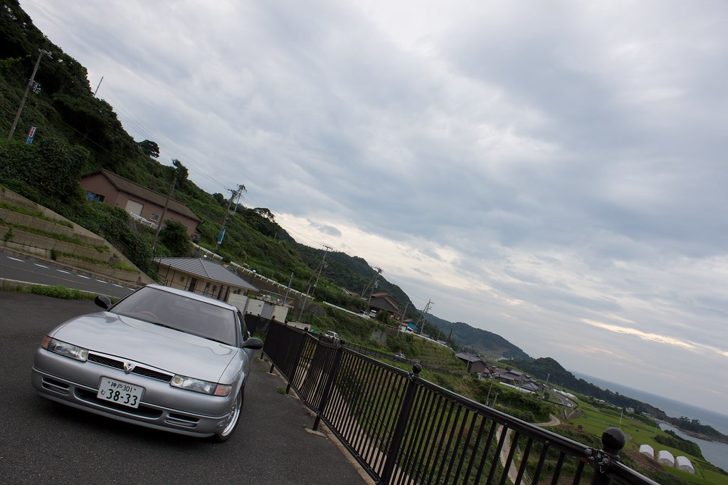

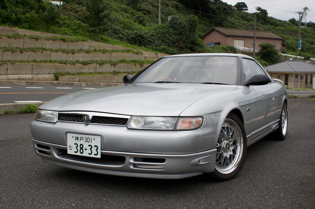

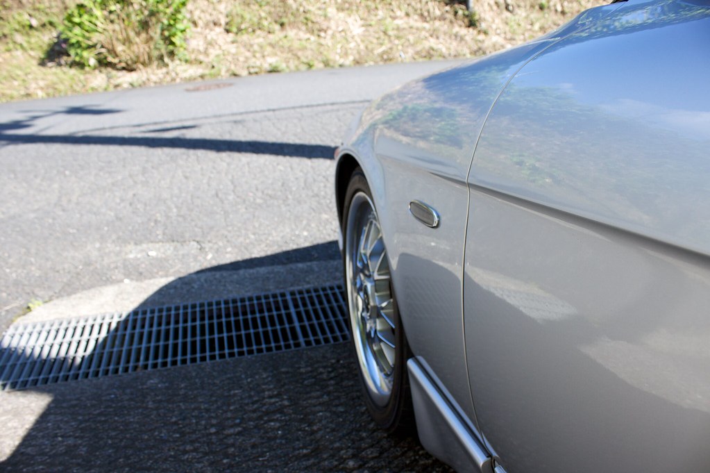

Here are some recent pics of Pay2Play taken in Kyoto...Enjoy...:)
On the upgrade front...Project Pay2Play is now HID EQUIPPED! (woowoo)
I'm going to see the Cosmo for the first time with the HID system fully installed today and my upcoming trip will be a great time to test them out...Can't wait! (2thumbs)

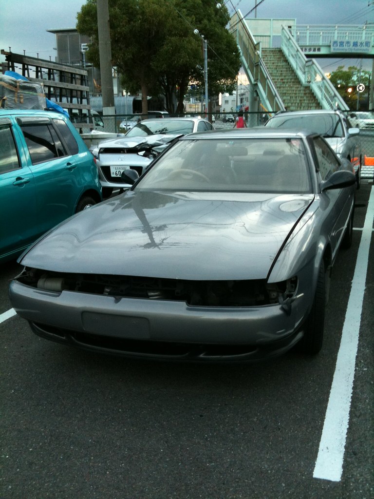

On a related note...I shot the above pic with the iPhone while at my Friendly Mazda Dealer below...
Here is a shot of the Eunos Cosmo "parts car" that has a blown 20B...Sad sight but at least some of its parts may take on a new life in my Cosmo...:D

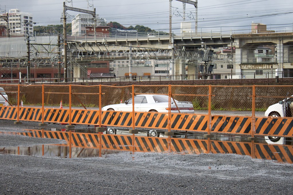

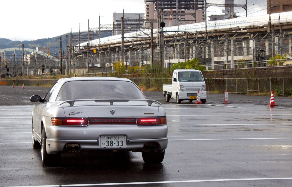

Here are a few pics of the Cosmo parked in a several locals around Hiroshima...:)
Near the "Mazda ZOOM ZOOM Stadium"...
Peep the "Shinkansen" (Japanese Bullet Train) zooming by...

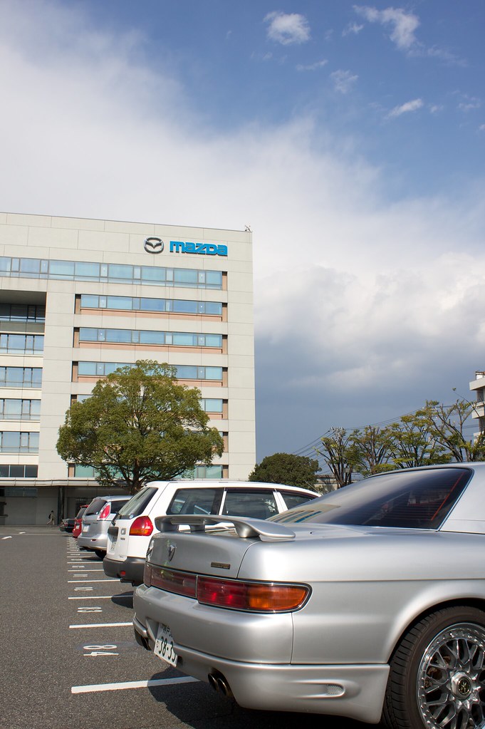

Here's a lil' sneak peak of Mazda HQ...

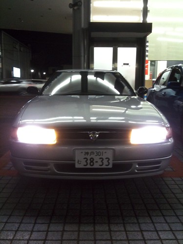

The day before heading out to Hiroshima, I picked up the Cosmo from my friendly Mazda Dealer and snapped a quick pic via the iPhone with the HIDs in action...
Here's the lowdown on the HID setup...
* Hard Set @ 35W / 6600K
* "TS" Three Stage system has NOT been installed due to the fact that there is no more room to snake the wires through the stock firewall passages...The addition of the DEFI goodies and BLITZ EBC have maxed out all the available wiring passages...:(
* The "TS" Three Stage system is currently on HOLD until another solution can be found or I may have to create a new passage..?
* Luckily, 35W is the overall most useful power setting and provides plenty of lighting power...I may just keep the current setup...We'll see...:)
* Hi & Lo Beam work seamlessly with the new HID system...Without the "TS" Three Stage system...There are ZERO additional switches to mount...Works through the factory controls.

The install was a custom job via an extra pair of Cosmo headlights saving my original ones in good condition...
* I hope they don't start fogging up!
* Alignment...I think the right one is slightly off...Going to bring it in to make sure everything is kosher.

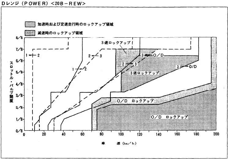

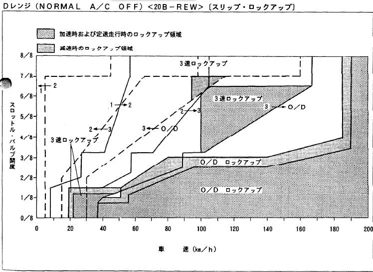

Curious on your reference to using "power" mode as this only alters the Auto-trans computer program meaning higher change points going up through the gears.

I thought the 'power' mode locked out the final overdrive gear, made throttle response better and shifted at different RPM. I don't use powah mode very often. Canberra is mostly 80km/h and 60km/h zones. The power button is not so useful for me.

I'm not sure if putting in 'POWER' mode actually increase throttle.. If so, I haven't noticed. I do notice that it shifts at higher RPM. But I like to get the RPM up at least once when I'm driving. So, i tend to put it on "HOLD" to red line.
I read that power switches something on i forgot the name of it, it's in the top section of the gearbox. bad terminology.
and it definitely increases throttle response, doubles the amount of load points on the accelerator pedal. thats what i saw in a diagram. meaning its not a simply wire based?
I start and cruise in normal and press power button whenever i'm not doing a constant speed or at lights.
So are you saying its doubling the TPS sensor reading? Its hard to believe its doubling it.
I know more about MAP based ECU vs MAF, but I'm trying to picture how it will increase better throttle response. As if you mash down your pedal to the ground, the TPS will only read up to a point and not exceed beyond its opening, ie if 100% opening, it can't go beyond 100..
Also, there are several ways to so called increase throttle response, but I'm trying to picture how else this button will make a difference. One way is to lean out and increase timing, but that gets bit dangerous.

yes the throttle position sensor. I was sure it was in the workshop manual?? but cant find what I was looking for. numbers were from 8 too 14 i believe.
simply more precision.
no extra over 100% just more precision inbetween. I'm begining to doubt myself i looked through the manual but can't find it.
have to print off all 613 pages and go through it slowly.
this is the basic diagrams of the gear modes. on the y axis is the throttle position.
now imagine that is 8 points. in the diagram i think i saw in power mode there was 14 points on the y axis. it specified this feature with 2 small images side by side.
i cant find it, it's a strange thing to imagine...
until i find it just disgard what i have said.
