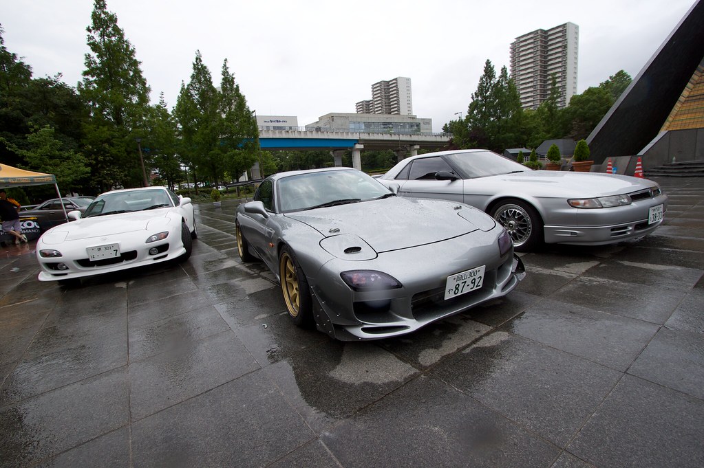

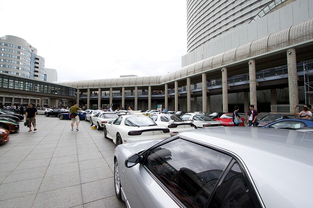

Got some new juicy pics of the Cosmo while attending a big Rotary Meet last weekend! I'll be posting a full thread in the News Forum soon...Here's a quick sample:
Antoine,ypou have a absolutely awesome car and a mazda beauty!!!congratulations!!!!(yippy)(yippy)(yippy)
seeing this car cant help to avoid tears in my eyes!!!
I like the 1st & 3rd gen RX7s too. I'm a sucker for the 3rd gens... in appearance at least. 'Never had a chance to try one out.
I'm not spotting a lot of 2nd gens from that picture though? Are they out of the shot, or just not as prevalent there as they are here? Or are my eyes just that bad? :D I can't make out much past that second line of "whites."
There were a couple of super sweet ragtop 2nd Gen RX-7s there along with some other wild ones...Have a look if you haven't already...:)
