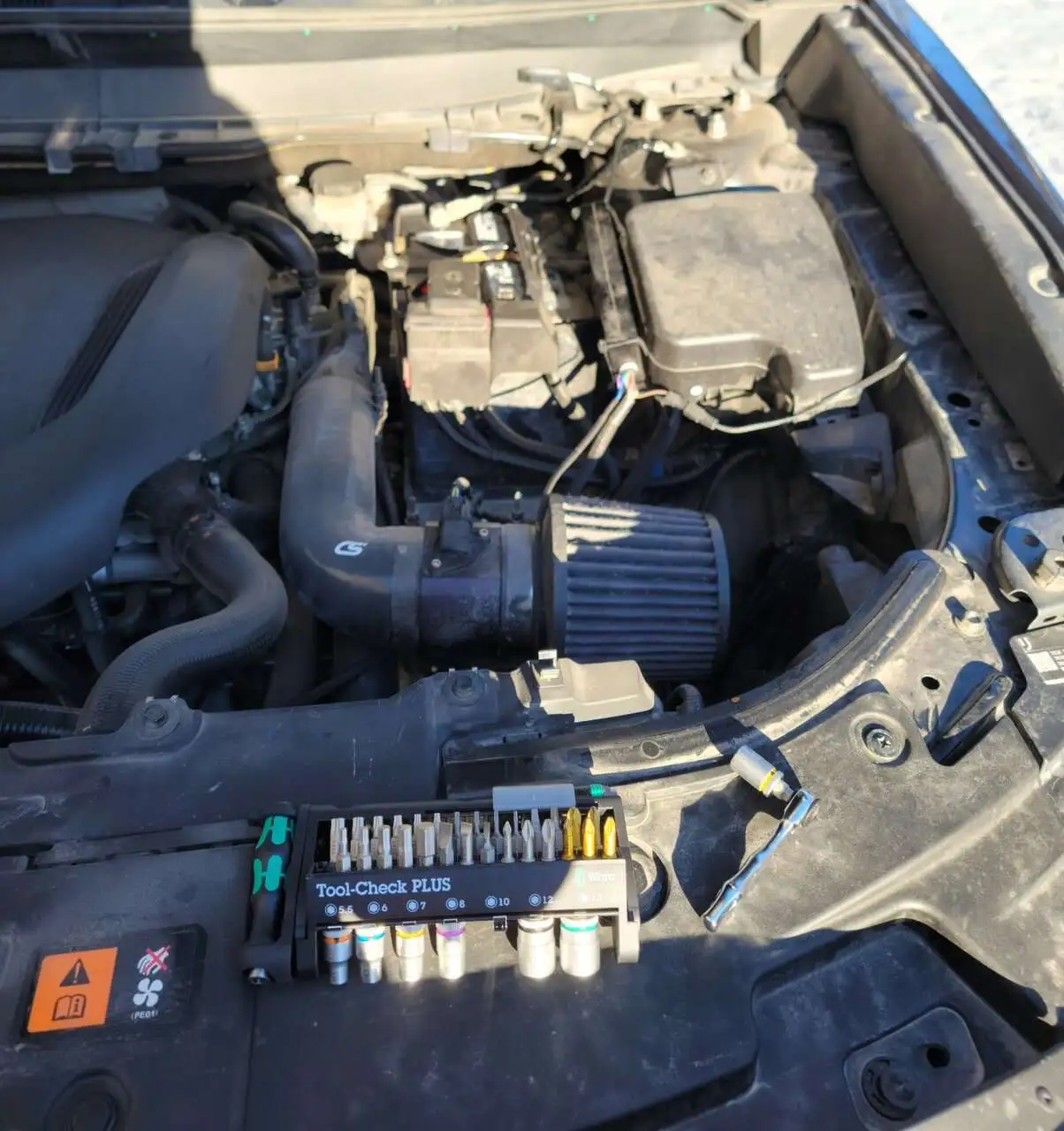

So far, so good! Don't sweat the battery, its a consumable and batteries in general don't seem to last as long as they used to for whatever reason. At least we're not forced into using a more expensive AGM battery, I've had to replace the AGM battery on my dad's 2018 Equinox twice already. For the cost of those two batteries, I could have bought a brand new battery for my CX-9 every winter since I got it! lol
