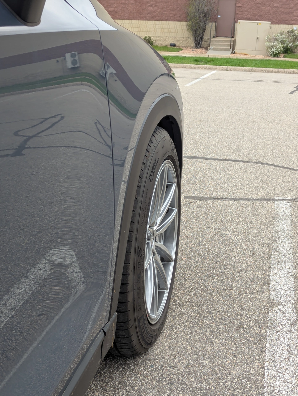

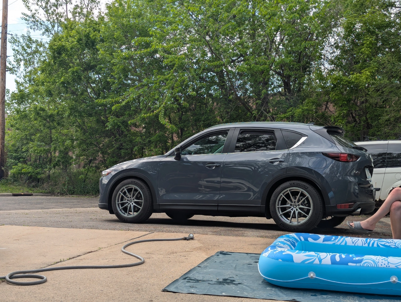

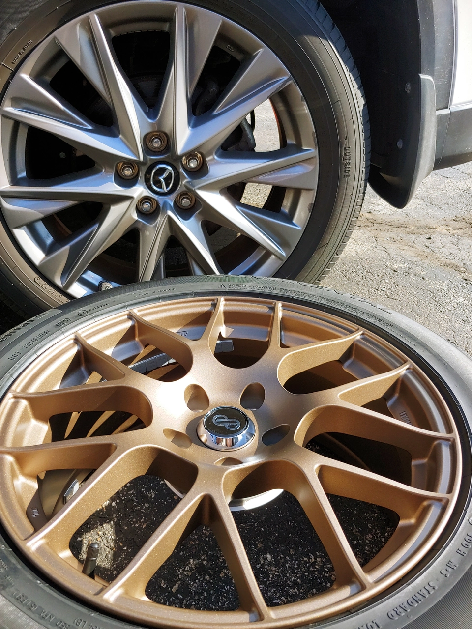

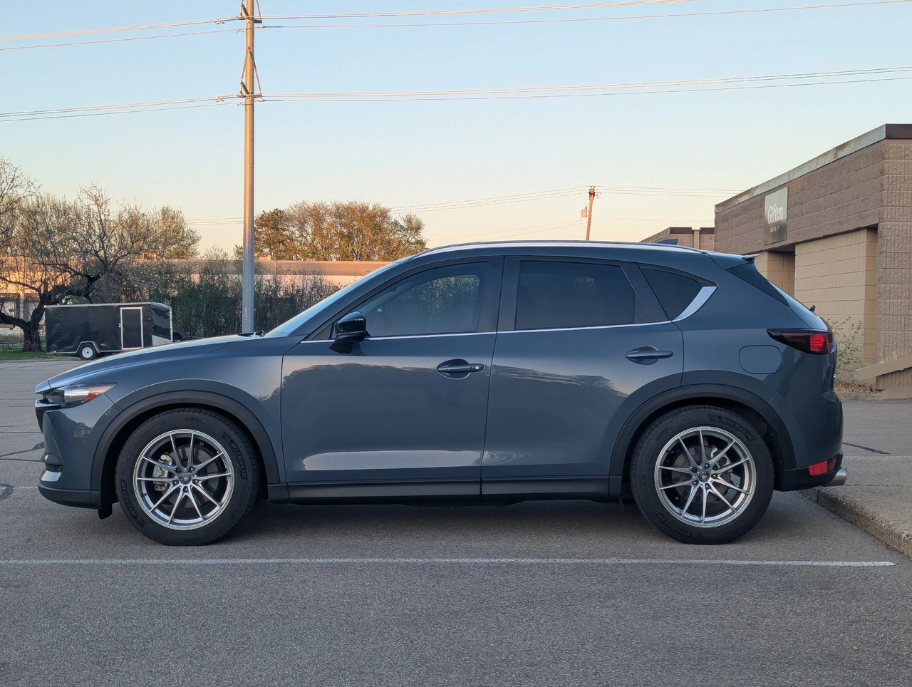

So in terms of wheel you're in 6mm (half of 1/2") and out 15mm, for a total of +9mm compared to my 9" at 45 offset. Now how your fitment is will depend on the section with of the tire, which you're running pretty lean at 225 so it shouldn't be too chunky. But yeah, there probably is a bit of poke. I assume those are not available in higher offsets?
That is a great looking setup though.

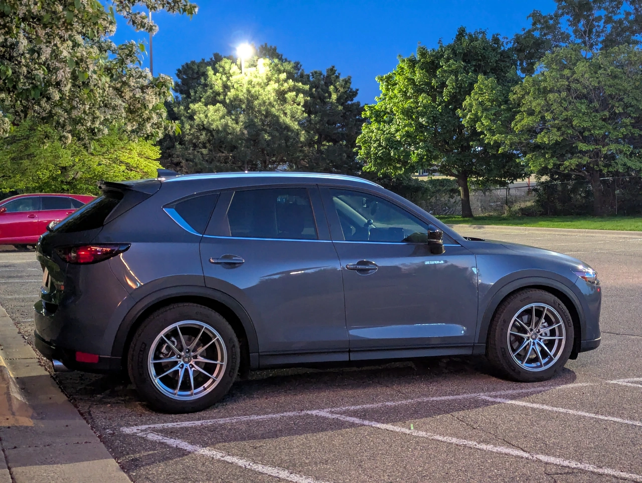

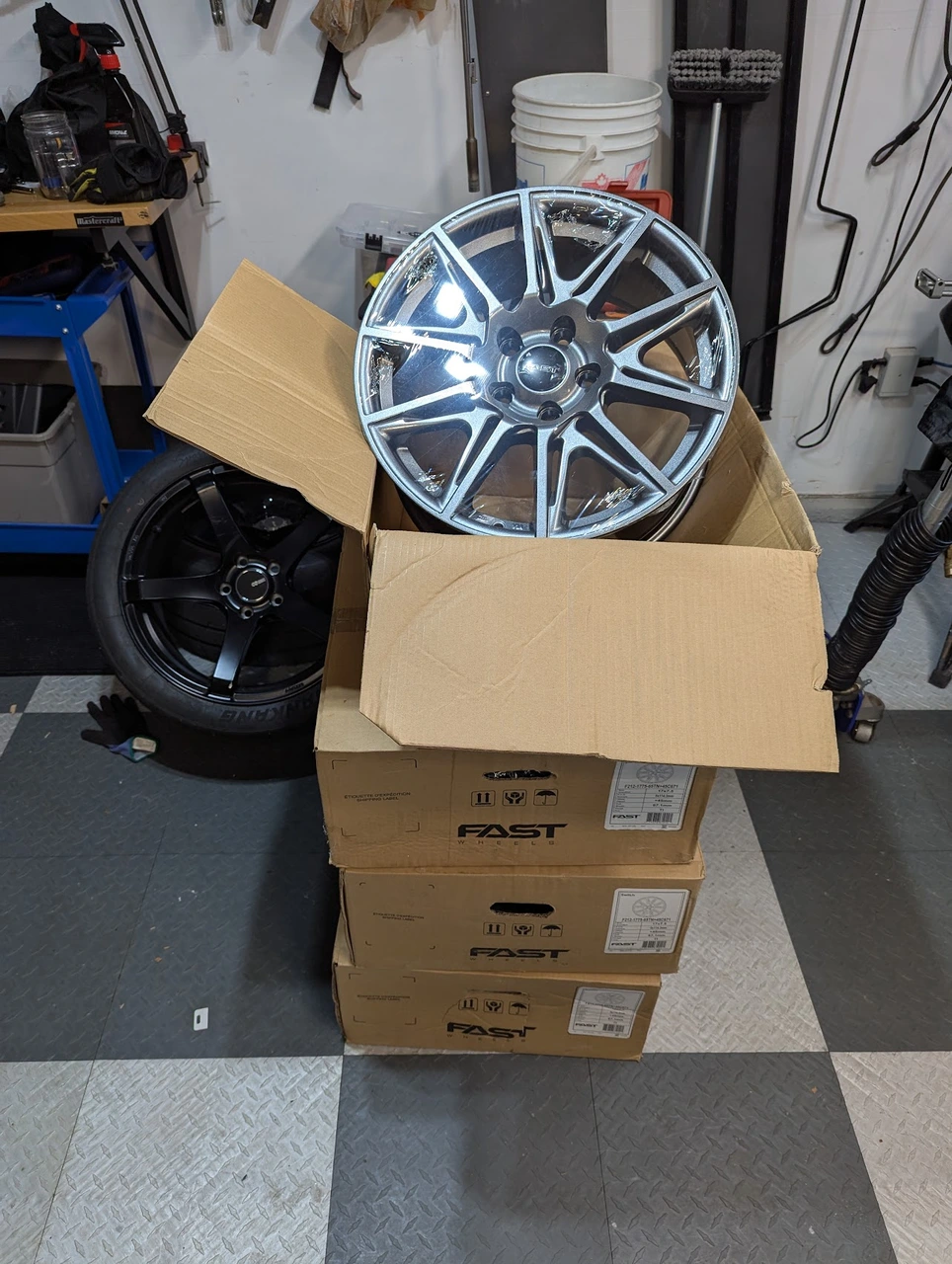

Yea, I wanted something that I didn't feel like I needed spacers after getting new wheels. The setup definitely fills the wheel wells pretty well. I'll get some more photos when I get time.

I was curious how the stock size 225/55 would look on an 8.5" wide wheel. Do you feel like it is stretching the tire? Looks great from the pictures.
Tire is slightly stretched. Still plenty of tire to protect the wheel.
However with the pilot sport all seasons, the "stretch" firmed up the sidewall enough to the point where what I thought was soft sway bars (I also have the hard race rear swaybar) was actually soft sidewalls. Turn-in is much more direct.
I was super nervous about the wheel size vs tire size, as well as the offset. I did the math so many times! The only real variable was the tire size on an 8.5" wide wheel. But, I'm super happy with the result.
As I think I stated before, I didn't want to put money into wheels and feel like I still needed spacers. With this setup, I'm a happy camper.
Only part I would change is that lip behind the spokes. It makes the wheels look smaller than they are. I may apply some black vinyl over it, and see what it looks like.
