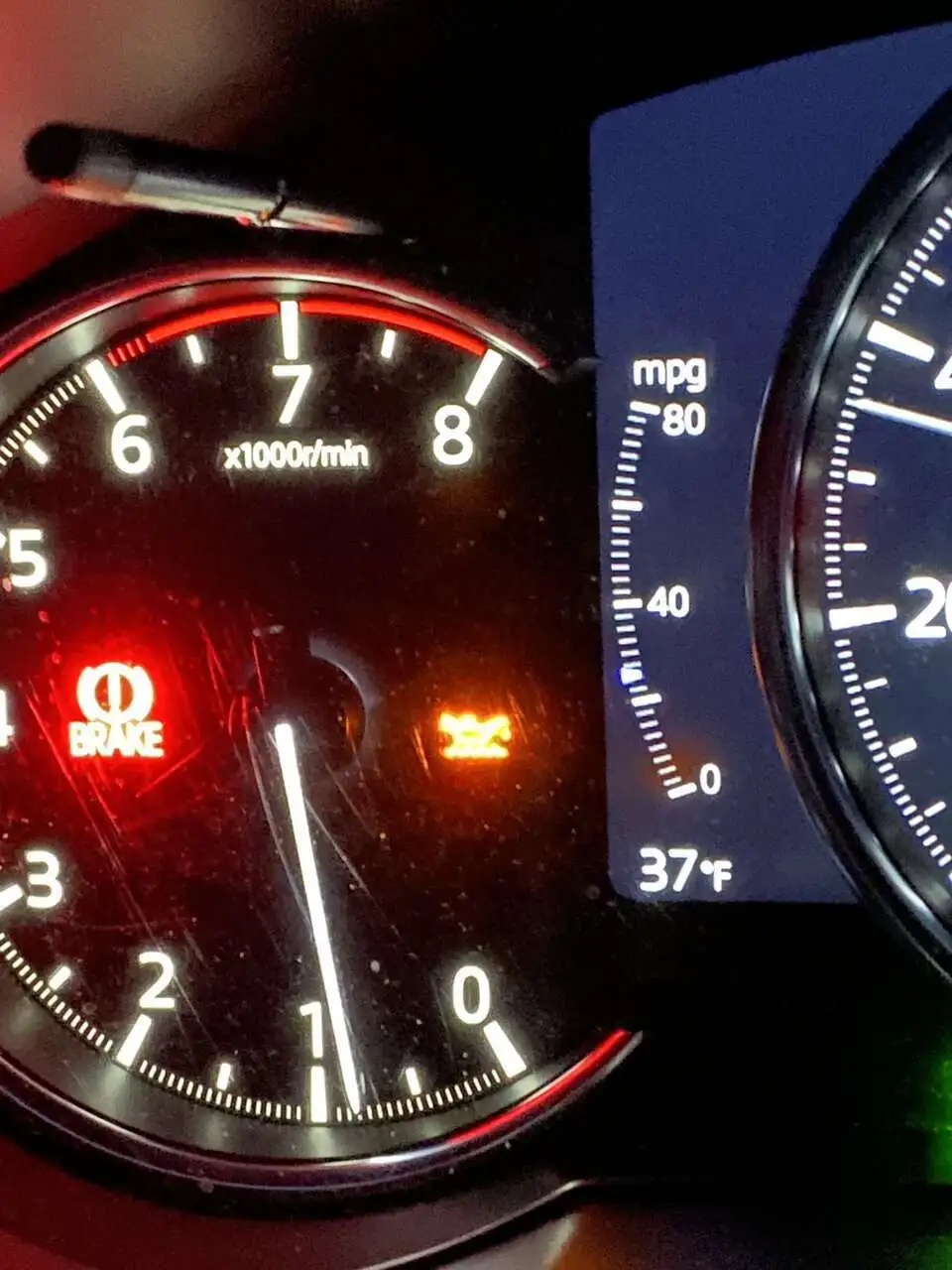

If you’ve ever had Low Oil Level Warning Light on and message displayed, you can talk to Mazda dealer to replace the valve stem seals under warranty based on the TSB. The DTC P250F code would be registered when the Low Oil Level Warning Light was on. You don’t have to wait and use class action lawsuit settlement.
TSB No.: 01-003/23 CHECK ENGINE LIGHT ON WITH DTC P250F:00 DUE TO LOW ENGINE OIL LEVEL
