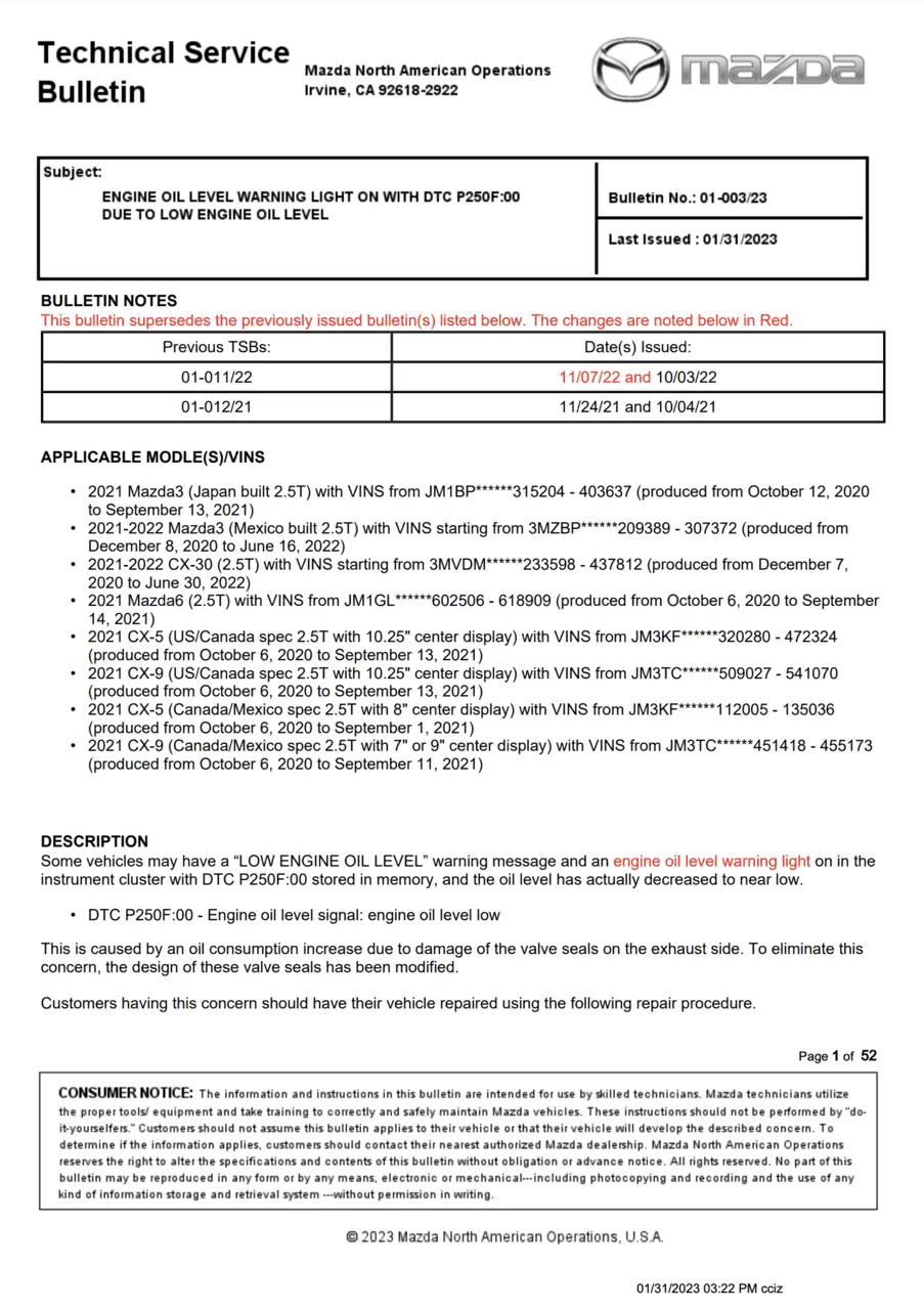

TSB update from 1/31/2023
  • MC-10230891-0001.pdf
WOW! what a tedious and detailed repair using special tools. After seeing all of the steps, why do I envision "ol' Bubba" taking short cuts, popping out the old seals and driving the new seals in with an old socket. LOL
There's no shortcut for getting all of the valvetrain stuff out of the way, which is required to be done before the seals can be accessed. And that's what Mazda wanted to streamline with the special tool set. Also, they certainly wanted to stay away from pulling the head (and all of the extra baggage that goes along with it), on all of the affected vehicles, which they accomplished with their tool set as well.
I believe that Mazda put together a really fine package with that set of SSTs, along with the highly detailed procedure (which includes LOTS of warnings and cautions). Yes, it took them around a year to build the whole thing, which seems like a very long time for something like this. However, I believe that's a reflection of just how queasy Mazda feels about the idea of their dealer service departments doing large scale, significant engine warranty work. And that idea is reinforced by the bit in the TSB which limits the job to Master techs only. They most likely went through lots of testing iterations and revisions, trying to make this as idiot-proof as they possibly could, before releasing it to the dealers.
And, based on the absence of negative reporting from owners who have had this work done, I believe they've successfully accomplished everything they were trying to do with this project. I'm no Mazda fanboy, but I do try to call 'em as I see 'em.
Yeh however the throughly thought of the procedures and special service tools in this TSB which is to fix the inferior valve stem seals, you have to wonder why this kind of oversight happened at the first place? Vender change? Revising the seal making to save a penny? Quality control engineers didn’t do a good job to find out the inferior seals? It ended up costing may be millions of dollars to develop this “perfect” procedure to fix a problem which is not supposed to happen. There’s nobody else to blame but the Mazda itself!
If Mazda didn't change the seal design/spec but unknowingly received substandard seals from their vendor, it would at least (hopefully) allow them to recoup some of the associated costs from that vendor. But if Mazda did make a change, then it looks like another example where Mazda shoots themselves in the foot again by the inability to adhere to the "if it ain't broke, then don't fix it" maxim.
After the CD/HLA problems and then the cracks/oil leak, this is the third 'assault' on the engine cylinder head. Maybe if Mazda would have left well enough alone and never introduced CD, their bottom line would be a little better and have more happier customers. I still wonder how much their CAFE numbers improved with CD in real world fuel savings versus savings on paper. And I guess we can put some blame on the Federal government dictating harder to attain CAFE requirements on the auto manufacturers who have to come up with designs to eke out tiny improvements in fuel mileage.
No disagreement from me that Mazda was ultimately responsible for the stem seal issue, and also that it should never have happened in the first place. And my comments about the procedure were merely expressing appreciation of what they did to resolve the problem, from a technical perspective.

The TSB says the oil consumption are caused by a batch of inferior valve stem seals. Mazda had revised the seals which to me means that batch of seals eventually will fail.
