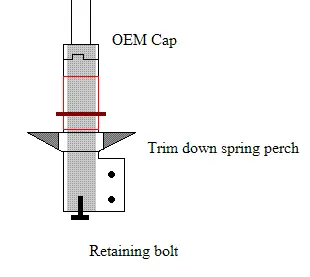

About the Strut Inserts, they will be held in by a gland nut.
At the bottom? I'm thinking about just using some hi-temp locktite to keep the top in place, there's only about .040" difference in diameter so it should work.
Oh no, at the top. Basically use a tap and thread it and use a gland nut and volia. Atleast thats what I hope..
that's a big tap. the gland nuts are available in a variety of thread pitches, which should make things easier.
I don't think the gland nut idea is going to work. The OD of the insert is 1.71," the ID of the OEM strut body is ~1.75"(can't find my calipers). That leaves you with a nut that would have to be .020" thick.
What I'm gonna shoot for is reusing the top caps by reaming the hole out to fit the Koni shaft. The bolt through the bottom should handle all the forces with the top cap keeping the shaft from deflecting. Once the struts are trimmed down to fit the Konis, the caps may hit the Ground Control collars, so I'll deal with that if and when it happens.
I'm a little unclear on the construction of the inserts...do they have a threaded hole in the bottom (like the cut-a-strut inserts do)? or are they designed for rebuildable struts, with no method of attachment to the existing tube?
no, the way these race inserts were designed is to have a gland nut that holds all of it in. These are desgined to be a rebuild strut insert... Basically custom.
Okay, here we go. The ID of the Strut body ~45.5mm and the strut insert is 43.5mm.
The Gland Nuts that are available from Koni would be 48 x 1.5 or 48 x 1.0. So what you would need to do is fine something that is big enough to fit over the stock housing that has a 48mm ID and weld it on. Then you would make a spacer for the bottom so it doesnt rattle around. Volia, you are done.... I won't have my strut inserts until a little while.
Yea, you're right about the gland nut. I was thinking the 8610s could be fastened from the bottom, but looking at the catalog again, it appears they only use a gland nut aswell.

Attached is the master plan.
low_psi said:
Just left a message with Koni. I'm going to see if they can find a bottom mounted 8610 series insert from another application that matches our stroke/length specs. I think a WRX insert will work.
Jeff, the DAs are too much work, just do a SA lol.

Making a threaded section for the gland nut is much less time consuming than trying to track down bottom mount inserts with the correct dimensions.
EDIT:
Koni called today, sweet, but after talking with Jeff last night I had already answered all my questions. Its good to know I can get ahold of them easily if I need to in the future.
I measured the stroke lengths of the struts on my car this weekend again, since I didn't write down the dimensions last time. I didn't want to mess with the endlink nuts so the sway bars stayed attached, which limited the droop, but I was able to measure how much stroke the car uses during driving. The Konis are well within range and the addition of a 10-20mm spacer under the rear inserts should allow the rears to droop a tad more(possibly curing my inside wheel lift issue before I change to a 450/350# spring set). Once I weld the threaded portion for the gland nut onto the top of the strut, I won't be able to remove the GC collar, but I don't plan on going back to Tokicos once I get the Konis anyways.
