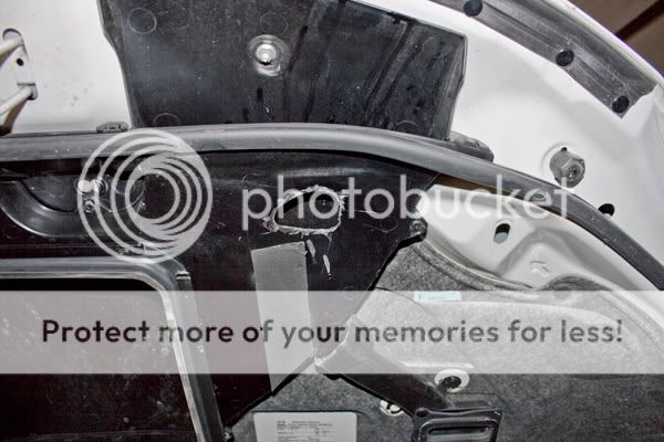

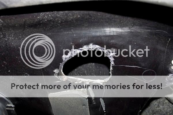

OK, I'm not an artist...so the cut is a little rough. I am going to spend some time getting it a little more polished looking, but it is what it is right now...and it works. No more cut lines since I did it.
Again, you may not (probably won't) need to cut away as much as I did...like I said before, just put some stiff grease on the vacuum line when you get everything connected and see where it's touching the hood duct, then cut bits away little by little until you don't see any more grease transfer to the hood duct. I figured that out about half way into the process, which is why my cut is a lot larger than probably is necessary. Again, though...it worked.
Also, I haven't noticed any increase in boost temps after cutting the duct.
right where you foam corner piece is peeling down is where mine is rubbing on the hood.

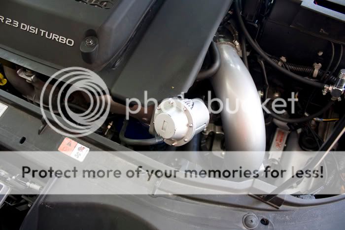

BTW...I think I found a way around the hood vent cutting. I was still having issues with the line getting cut, even after I enlarged the hole in the ducting. I eventually just took the back off the BPV and turned it 90 degrees so the vacuum port was down more. Haven't had an issue since. Just took a hex wrench and a small open ended wrench (I didn't have the right size so I used an adjustable wrench).
BEFORE:
AFTER:
Just take off the cap-nuts on all those small hex screws on the end with the vacuum port and reinstall it with that end cap rotated 90 degrees clockwise (so the vacuum nipple is down instead of on the right side). 1/2 hour job and it fixed the issue as far as I can tell.

great pics thanks for documenting. I would like to avoid cutting my hood ducting, but this will help on making the vac line tube out of the way as well.
