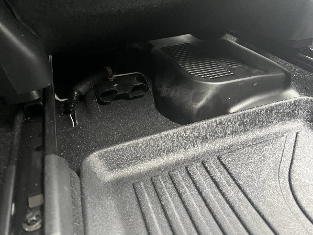

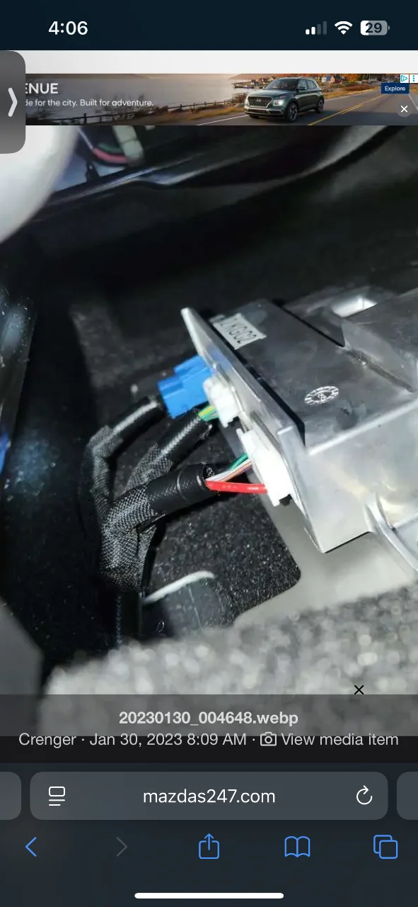

My cx-5 is the non-Bose version, and I confirmed that I do have the amp under the passenger seat. I am looking at the powered sub pictured below. It’s very close to what I am looking for: small, cheap enough, easy to remove temporarily, decent sound boost. I’m not looking to shake panels, but I want to supplement the stock sound system and fill the cabin better. I’m not the biggest fan of how it sounds now.

1 - Where should I tap into the stock wires? I’m assuming it should be after the factory amp?
2 - What colors should the speaker wires be?
