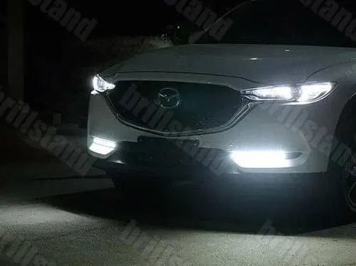

Yep kind of strange, not even offered as an option. Not the end of the world though, going to add some led DRLs with sequential turn signals.

How are you going to add sequential turn signals? I assume it will be added on the outside of the housing? That was one big reason I went with a GT in 19 and a GTR in 21. I like the Carbon edition but it is essentially a Touring trim without all the nice features I like (better LED lights, ventilated seats, rear heated seats, HUD). Silly to me you can't add that to the Carbon.
You can add LED turn signals to what you have now. I bought built in resistor bulbs for the rear and had to go with VLED's in front with an external resistor. You would also need to swap your rear brake bulbs for LED. Your fog lights are already LED. You can also get an interior LED kit with all the bulbs you need as well.
You can add LED turn signals to what you have now. I bought built in resistor bulbs for the rear and had to go with VLED's in front with an exterior resistor. You would also need to swap your rear brake bulbs for LED. Your fog lights are already LED. You can also get an interior LED kit with all the bulbs you need as well.
These kits available on Ebay, Aliexpress etc $60-$100
Interesting. I think I would disable the incandescent light in the headlight(or swap to LED) if I got those) Looks strange with LED and standard bulbs as they don't flash the same way.

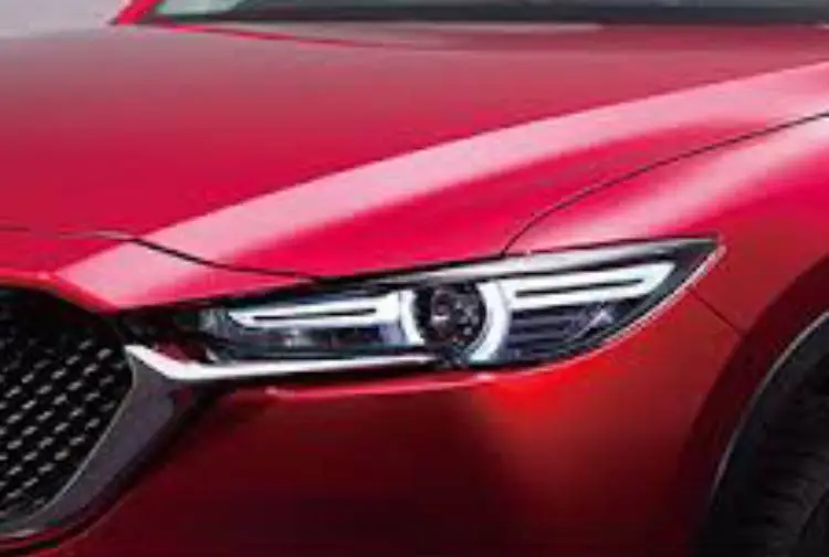

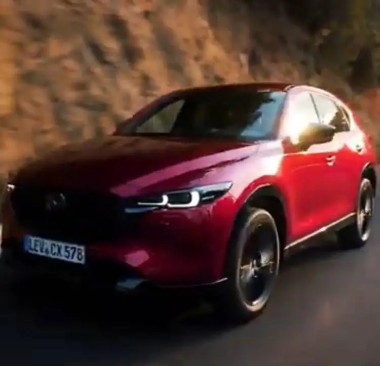

You can have your front and back thin daytime running lights on without the headlights if you have the stick in the parking light setting, if you do the video game trick.
So on my new 2022 Premium (2022’s equivalent to the old Grand Touring) that I’ll be picking up in a few weeks, do I have to do the video game cheat code to get the look in this picture? I did it on my 2017 Grand Touring and it worked perfectly for five years. Gives you total control of the light knob in the car. Only downside is that to have the thin DRLs on, the taillights (which are cool, so it’s not a problem) are on too, because the light knob is turned to the parking light setting. If I’m not mistaken CX-9s come with this front daytime running light already activated but I might be wrong about that.
you can try and let us know if the procedure still works on 2022.
The US headlights have different wiring somehow and somewhere so they can not have only the led signature lines act as DRL. Headlights light up too.
at least on all gen2 up to 2021 and if I am not mistaken the 2022 is the same.
Yes the cx9 use only the led stripes as drl if I recall too. As to why the US cx5 is different no clue. Some stupid marketing or other decision or they cut some cost somewhere as it happens.

I live in the US and when I did the series of instructions on my 2017 years ago, it worked perfectly and displayed only my thin DRLs (pictured) and my rear parking lights when I had the parking lights on. If I had the knob turned to OFF, everything was off. The video game cheat code makes the lights knob in the car function correctly to whatever you turn it to, instead of the headlights always being on no matter what. In five years of having that car (a drunk driver ran into me and totaled it a couple weeks ago), I was the only one I ever saw driving around with only the thin lights illuminated, or with all lights turned off.

If you’re saying the headlights are always on on US models, then what do you mean by “let us know if the procedure still works on 2022”? I live in the US and it worked perfectly on my 2017 to only show the thin daytime running lights (and the taillights) when I had it set to parking lights.
