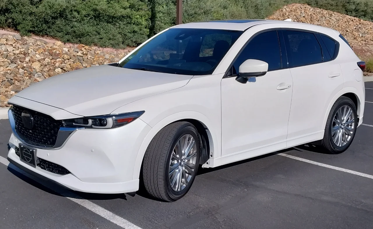

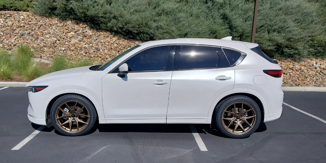

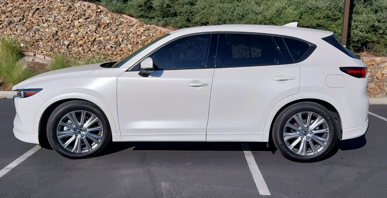

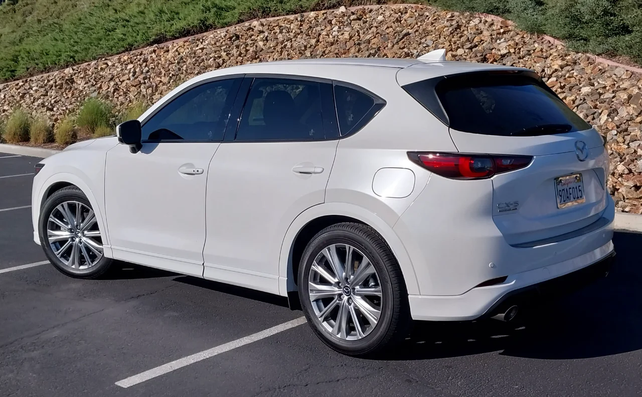

2022 Signature Turbo with Corksport lowering springs. Rides and handles better than stock IMO.

Looks really good, don't agree with the better ride but I do agree with the better handling (y)
Probably right. My other car has kinda that sports car feel, and I've gotten use to that. The 5 felt top heavy stock. Mine will likely never see more than a dusty paved road. Lol

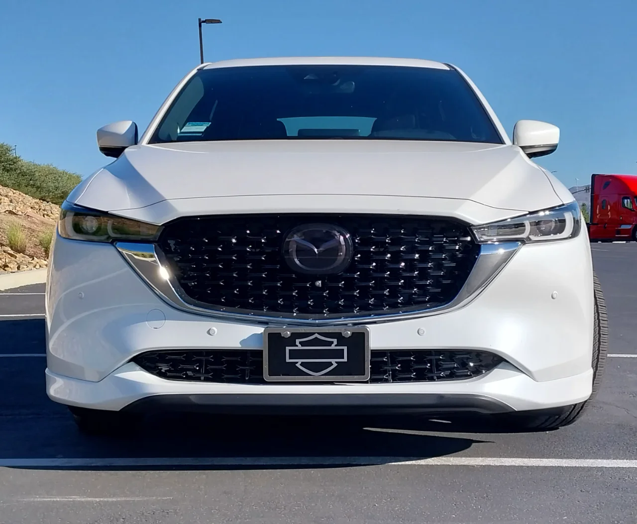

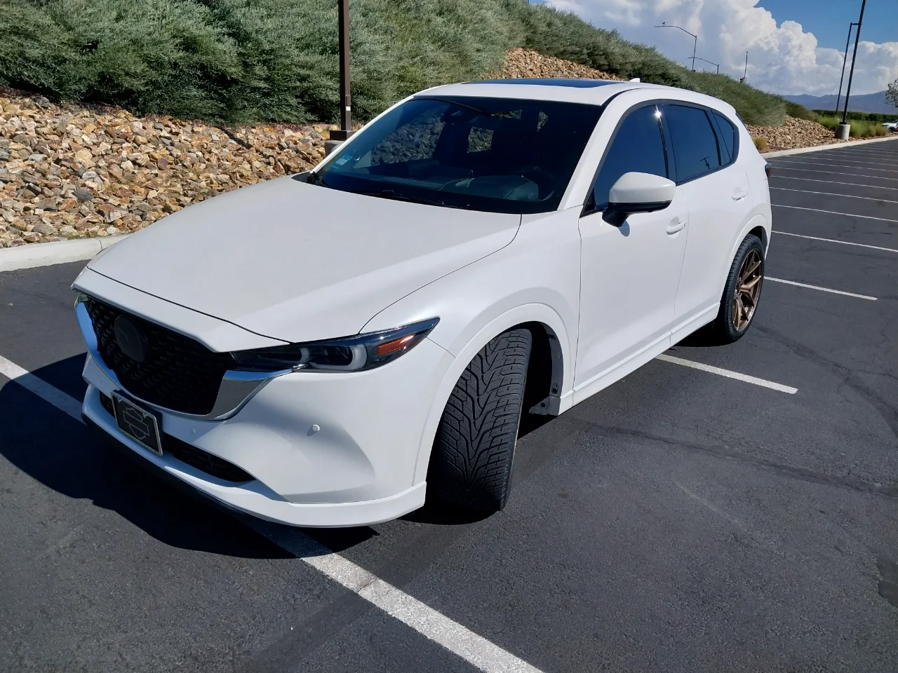

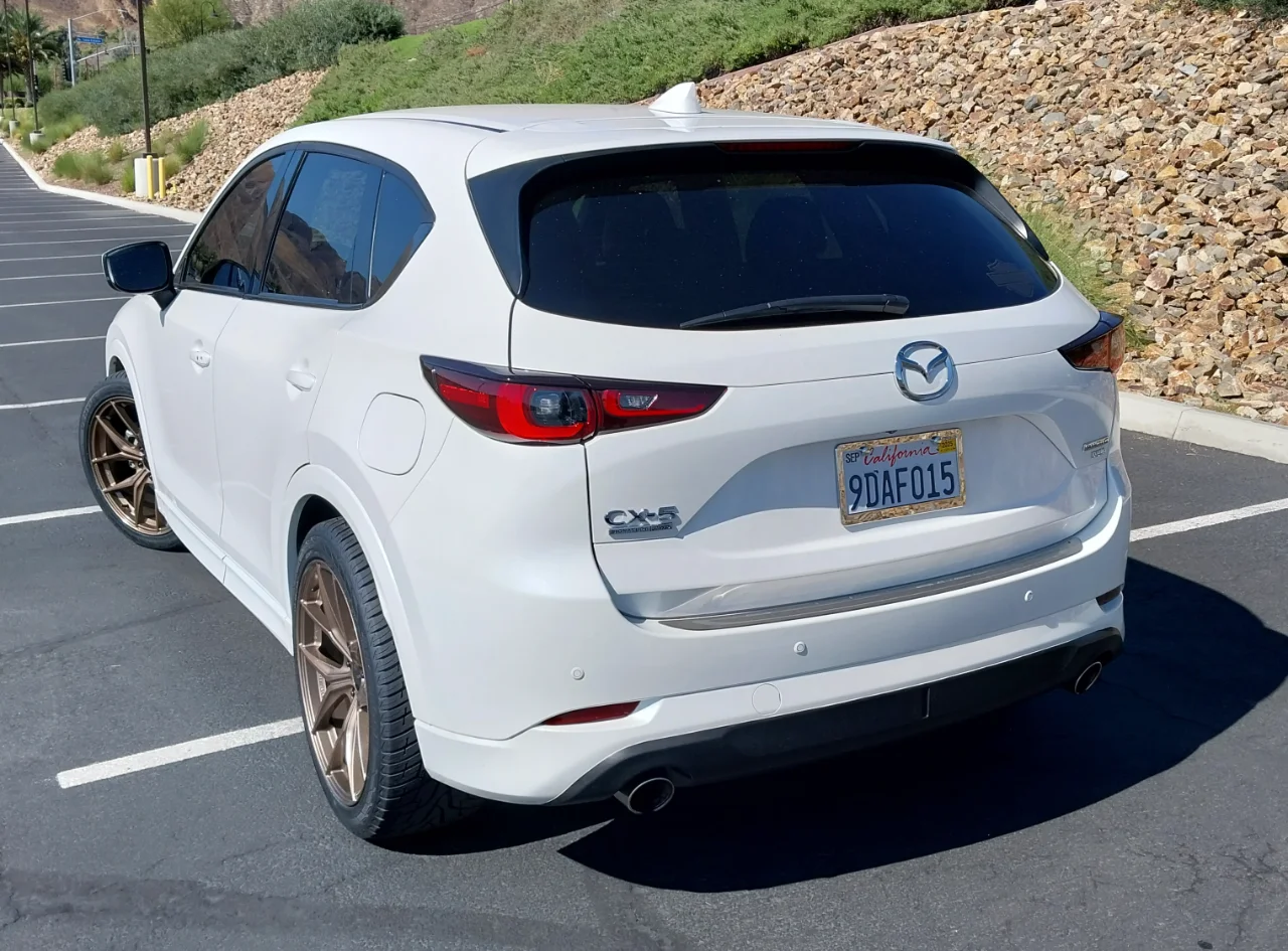

Got the corksport springs installed on my 25 signature last week, love them. Looks much better , handling and ride is a bit smoother.
Just so everyone understands, the spring rates on the Corksport springs are stiffer than stock by 17% up front and 35-70% in the rear depending on what the OEM rear spring rate actually is (4.1 kg/mm from online sources vs Corksport who claims ~5.5 kg/mm).
