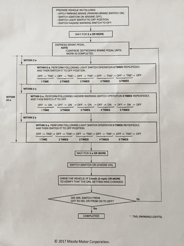

“Switch Ignition On (Engine Off)” in the Mazda’s official document just means that, turn on the ignition (by pushing the start button twice) without start the engine (without the foot on brake pedal). You’ll see most warning lights on in the instrument cluster.
If you push the start button only once without the foot on brake pedal, it’s in accessory mode, the ignition is not on.
It’s like old mechanical ignition key. You turn the ignition key to the first stop, that’s accessary mode; turn to the second stop, the ignition is on.

These are the exact steps:
1. Apply Parking Brake.
2. Hit Ignition Twice (fast double tap).
3. Wait 2+ seconds.
4.Hold brake until you start the vehicle.
5. Off>Parking 5x. then off. (about 2 on-off switches, per second, for this step and next two).
6. Hit hazard lights 10x.
7. Off>Parking 5x. then off).
8. Wait 5+ seconds, foot still on brake, start vehicle.
The thing that I think made the difference is the speed of the procedure. This time, I went very fast on the movement of the switches, and that seemed to do the trick. Also, zero delay between steps 5-7.

Ha, you finally nailed it! I thought the video posted earlier on a Mazda3 actually demonstrated 2 differences you made this time for a successful DRL setup change. The official document also says you have to do the switch on-off within 2 seconds between each group.

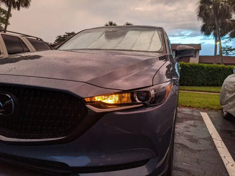

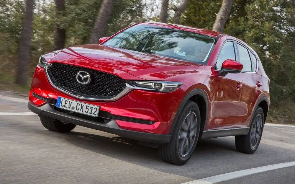

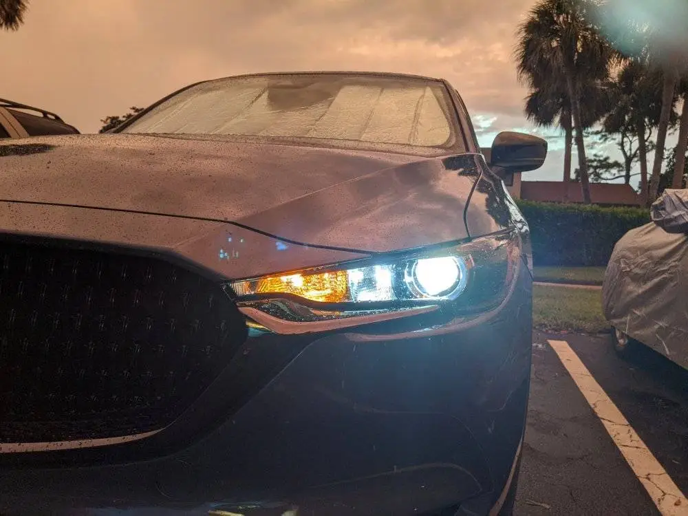

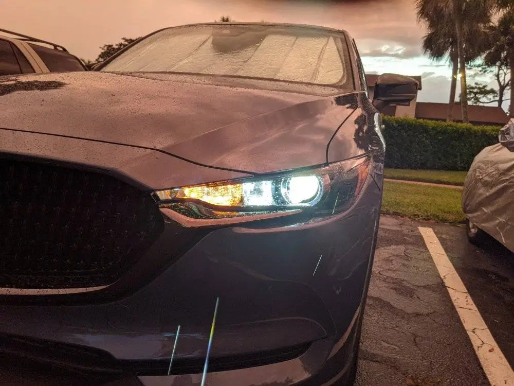

Anyway, I have read most of this thread, especially the most recent posts. But I am kind of confused. I took photos of my cars front lights switched to auto, parking, and bright. I don't see the halos on in any switch mode. I definitely want my DRLs to look like the photos in post #202 and have printed out the insane Rube Goldberg instructions to have the halos only as DRLs and am fine with having to switch on headlights manually, but I want to be sure that's what I will get if I do the hack. I also don't see the horizontal leds on either side of the halos like on the red CX 5 in post #202. Are headlights different on 21 CT AWD?
Any help most appreciated.

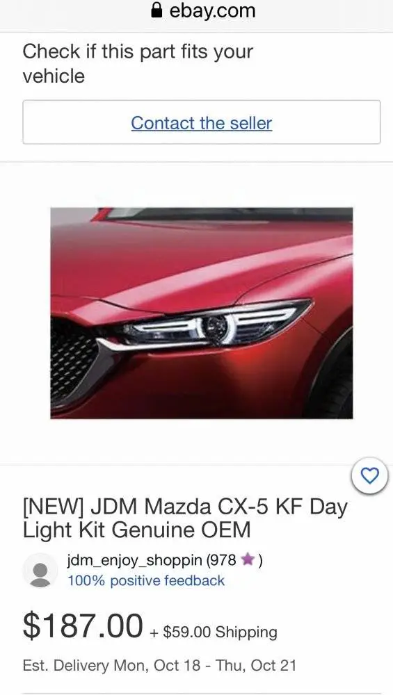

Bummer, so the hack will do nothing for me?
Guess I could buy a pair of these on Ebay, not sure if they work on a 2021
https://rover.ebay.com/rover/1/711-...2&toolid=10001&campid=&icep_item=264757238463
No, you can’t do that. That eBay kit is just a kit from Japan for CX-5’s to enable DRLs which already have LED accent strips (halos) in the headlight units. But based on pictures of your “2021 CT AWD”, your headlights are just base LED headlights. If you really want halos, you need to get entire LED headlight units with LED accent strips build-in which will cost you at least $1,200 a piece!
