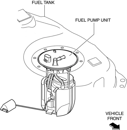

The CX-5's don't have an accessible/serviceable fuel filter, correct?

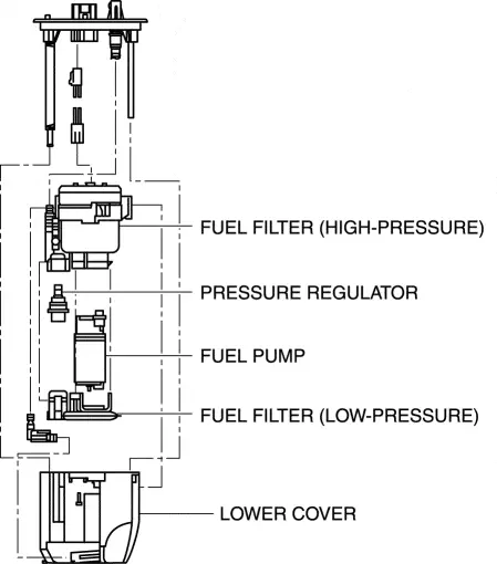

Yes, it has. A pre-fuel-filter or low-pressure fuel filter is in the gas tank and there’s a YouTube for that.
Mazda CX-5 Fuel filter strainer replacement
The high-pressure fuel filter is the canister-type filter we usually see. It also is in the gas tank on the fuel gauge sending unit above the low-pressure fuel filter.

Of course Mazda doesn’t offer any maintenance schedule for both fuel filters.

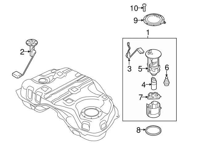

I think there is an access panel under the rear seat , driver side.
I would not bother with changing whatever filter there is in the tank. I changed the screen on a 10 year old Maxima and so little debris in the tank and effectively nothing on the screen it was a waste of time. Perhaps using fuel sources in markets outside of NA may benefit though.
Appears to be nearly the same setup as schematic above.
