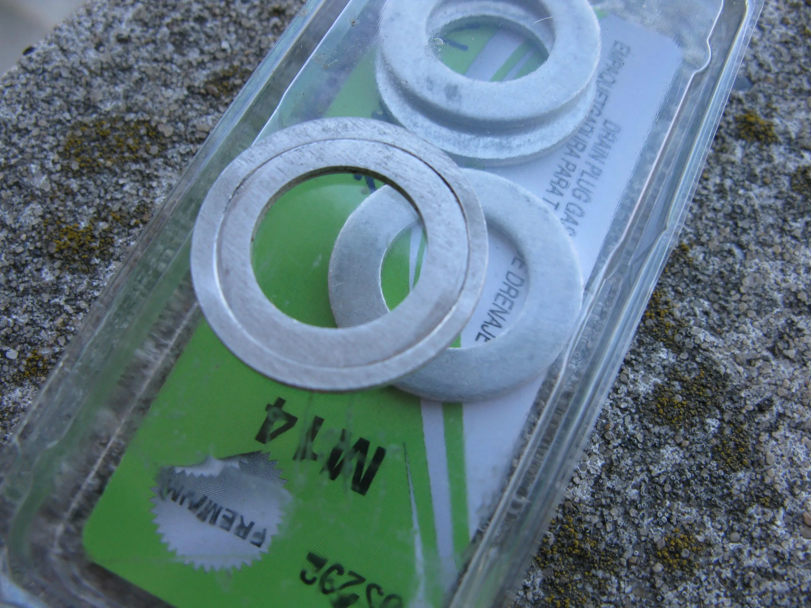

Technically these are not "Crush "washers but, flat aluminum washers. Ed
...looks plenty crushed to me...
...but technically, you might be right...

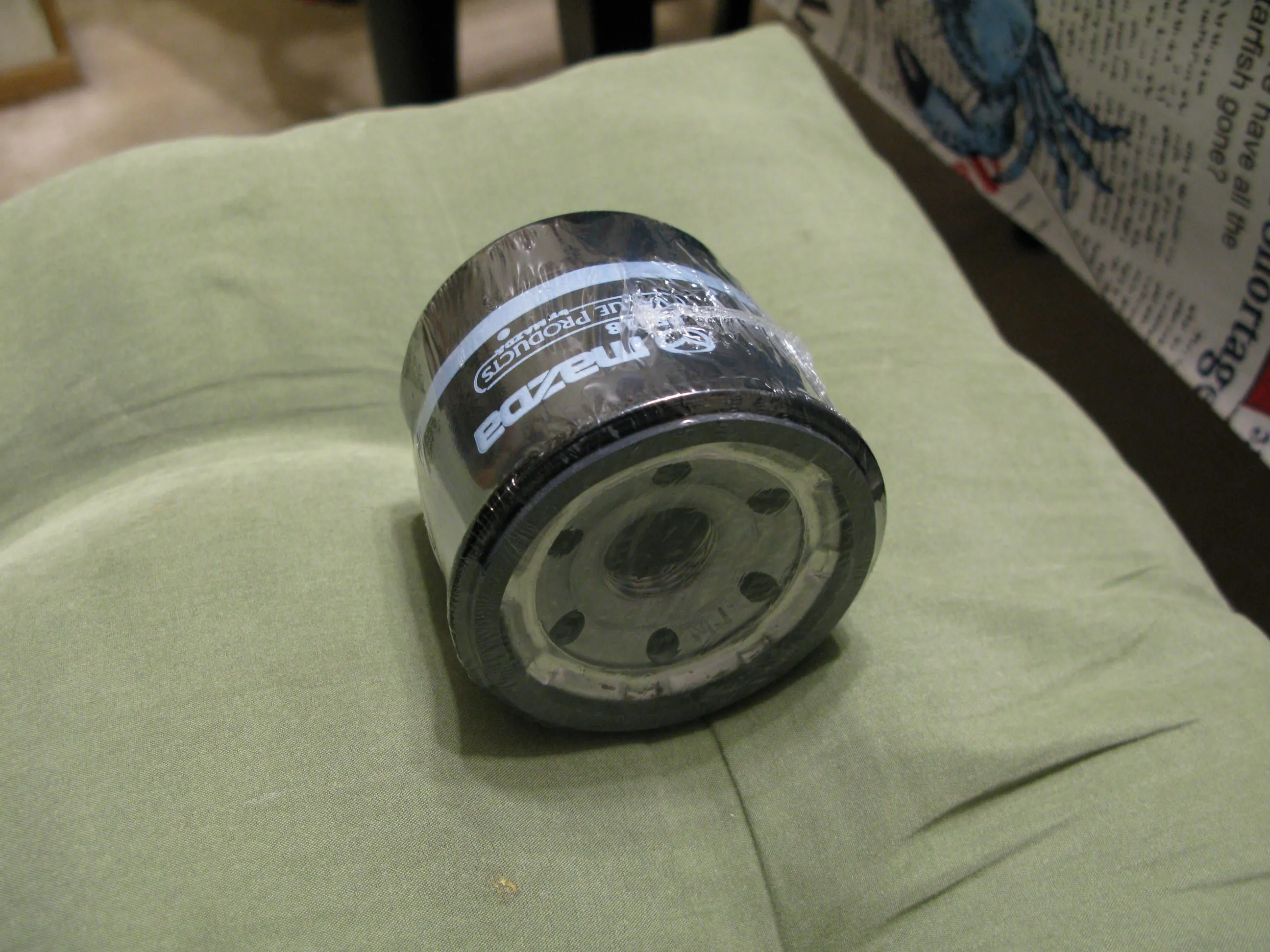

Bought one of these oil filters from the dealer, don't even come in a box anymore. Happens to be one of those "value" filters from Mexico, gasket wasn't even lubed like the Japanese ones.IMG_3660.webp

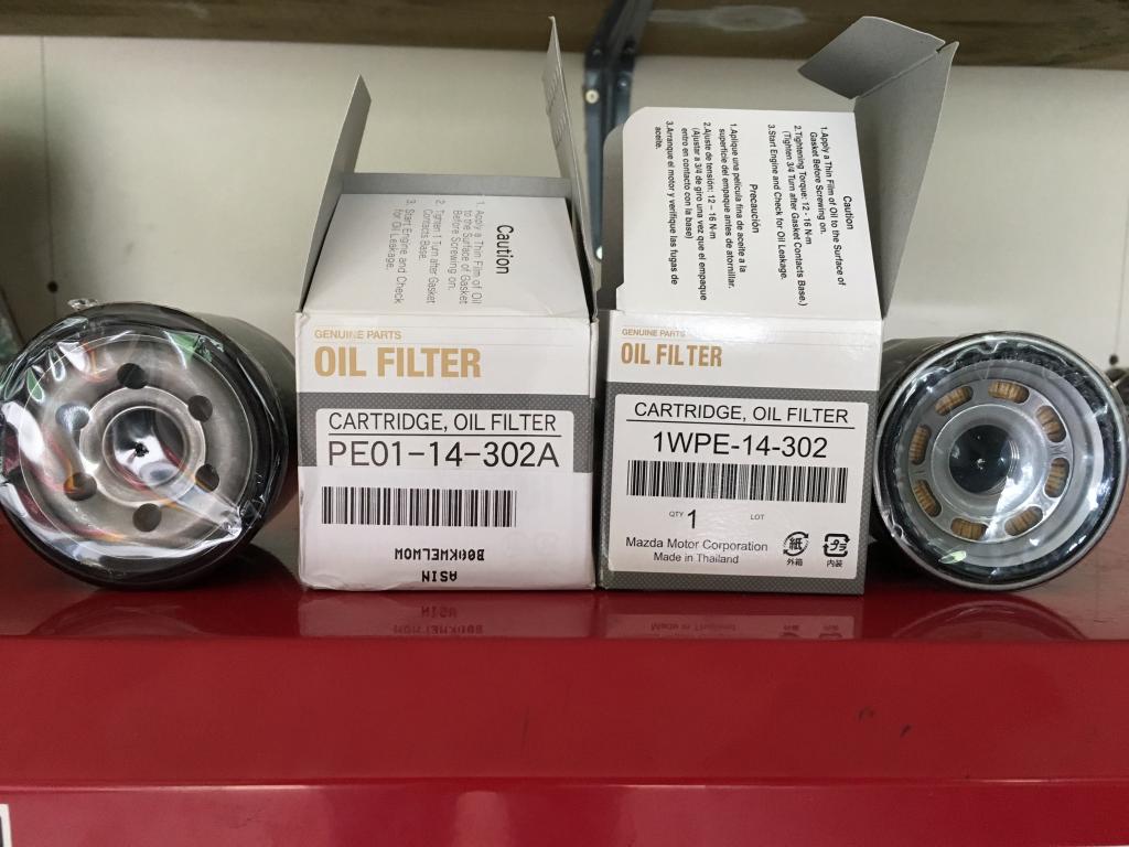

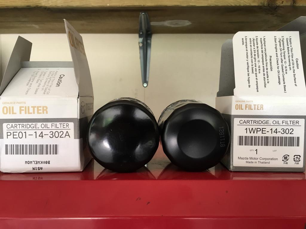

Mazda superseded Japan made PE01-14-302A to Thailand made 1WPE-14-302 oil filter several months ago. Both of them come with paper box and lubed gasket. But the sizes are a little different between them and you can tell the difference on quality! I bought all leftovers of OEM Japanese oil filters from Med Center a while ago. What is the part number for this "new" oil filter from Mexico? This has to be another cost cutting by Mazda! (boom08)

PE01-14-302A-MV , saw another thread on here somewhere about it...maybe MV means Mexican Value?? lol.. Definitely has a cheaper feel to it, disappointed this is dealer stock.

There're now 3 OEM Mazda SkyActiv oil filters:

[td]Made in Japan with the best quality.
Comes with greased O-ring type gasket、
shrink wrapped seal on top preventing dust、
and packaged in a sealed paper box.[/td]
[/tr]
[tr]
[td]1WPE-14-302[/td]
[td]Made in Thailand.
Smaller in outside diameter than PE01-14-302A.
and packaged in a non-sealed paper box.[/td]
[/tr]
[tr]
[td]PE01-14-302A-MV[/td]
[td]Made in Mexico.
Comes with non-greased flat gasket、
shrink wrapped seal on entire filter、
and no paper box.[/td]
[/tr]
[/table]
