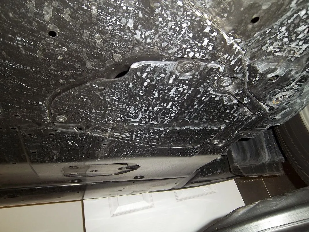

Its the second door from the front in the under cover. It takes two Phillips screws or 10mm sockets AND one fingernail. First pop the plastic pop rivet by pulling down on the center circle and then pull out. Next unscrew the 10mm/Phillips bolts. After that you have to bow the plastic in the center and the door will come down with out breaking the tabs that hold it in place. I recommend using the screw driver on the screws as they only screw into the plastic and can strip very easily.
attachment.php

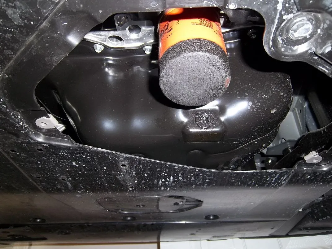

First remove the filter. Before putting on the new filter remove the 8mm drain plug. (Make sure to wait for all the oil to drain out. do this in the am before the car is driven. That way there is no oil up in the head. Being that it is 0W oil it should take approx one beer to completely drain out.) Snug up the plug. I say snug cause it has a aluminum washer that can get easily distorted if tightened too tight. Then replace with your choice of filter making sure to oil up the gasket before installation and hand tighten.
attachment.php
Next use a 8mm allen to remove the oil pan drain. Drain. While your waiting for that go ahead and remove the filter. Re install oil pan drain to snug. I say snug cause it has a aluminum washer that can get easily distorted if tightened too tight. Replace with your choice of filter making sure to oil up the gasket before installation and hand tighten. (Make sure to wait for all the oil to drain out. do this in the am before the car is driven. That way there is no oil up in the head. Being that it is 0W oil it should take approx one beer to completely drain out.)
