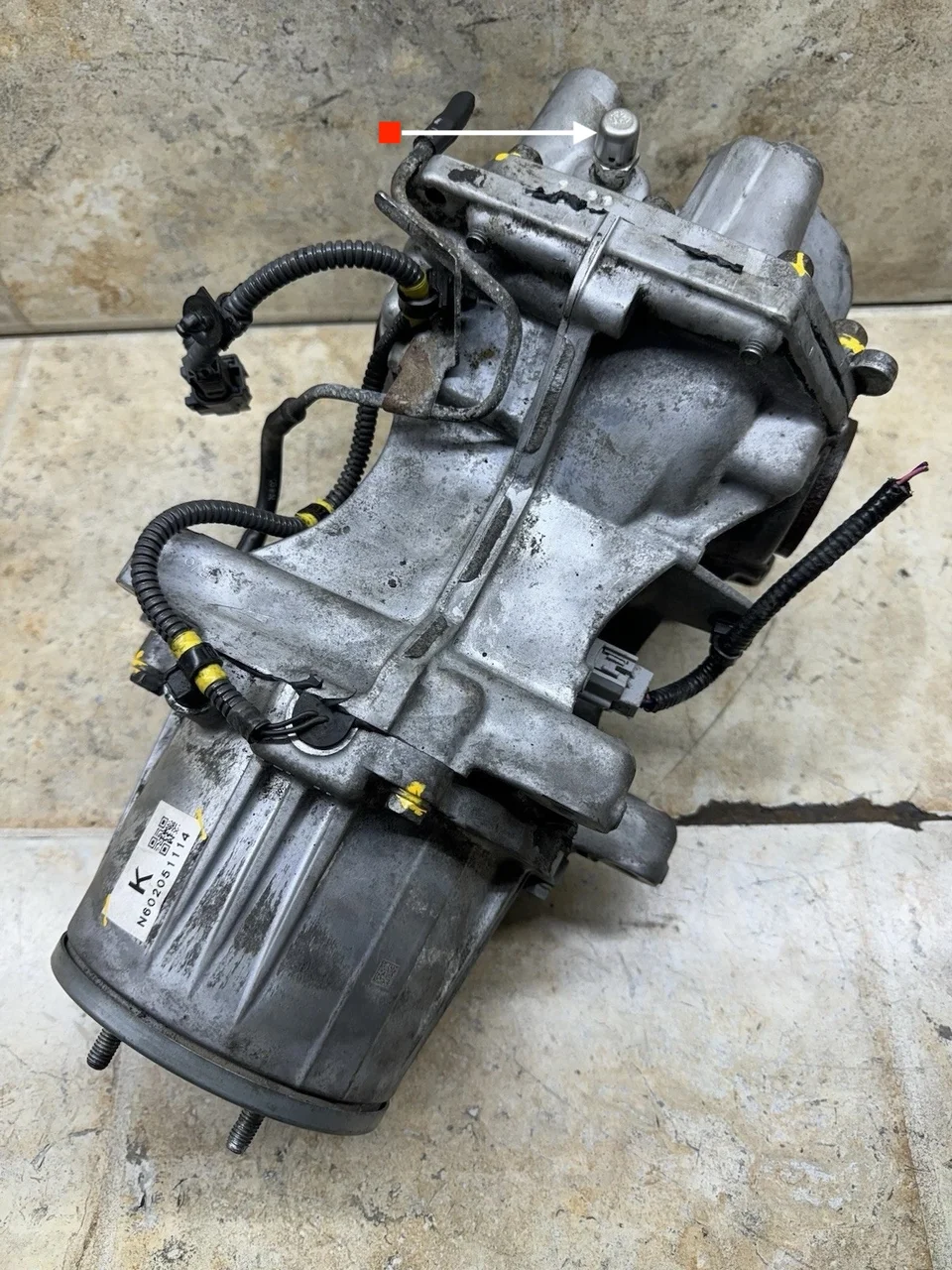

there is a vent line on the top I do not know where it terminates at. it is a very small line.
Probably terminates in similar areas as the ‘13-‘16.5 models.

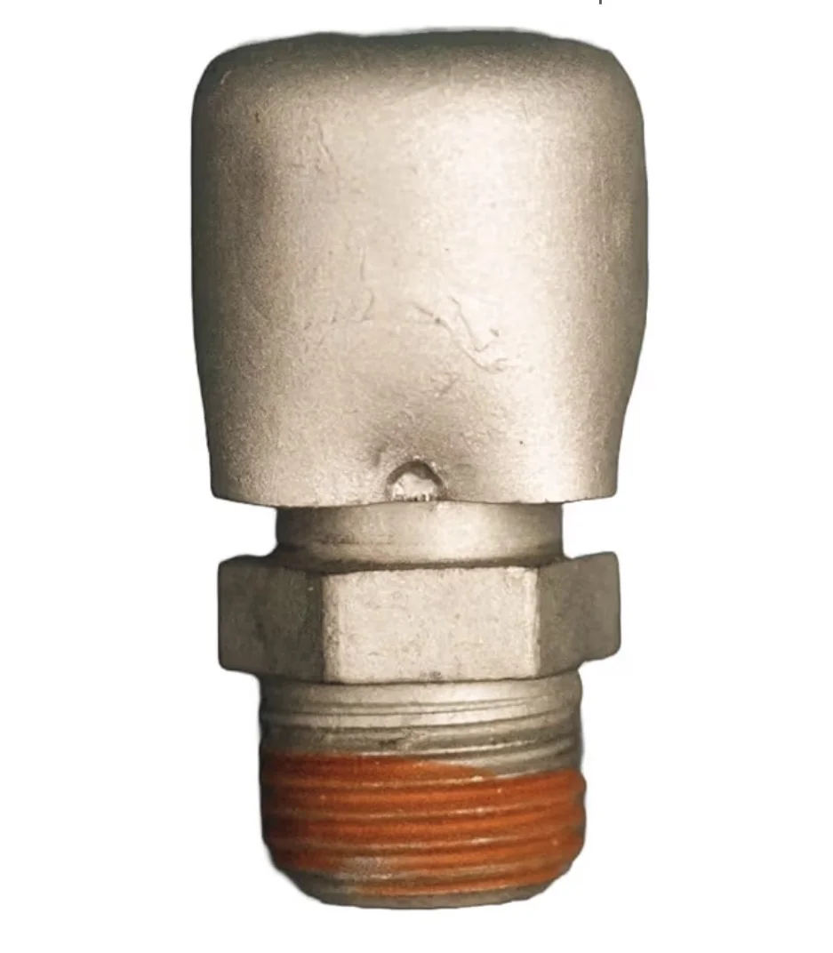

I doubt it’s what Mazda uses, but I have seen these small vents that screw directly into an axle or gearbox. No hose needed. That little cap on top fits loosely, but doesn’t come off.

i traced the rear diff. vent ,it looked similar to kedis82ze8 post above,the front i dont know yet....but i see a transmission vent hose in engine bay

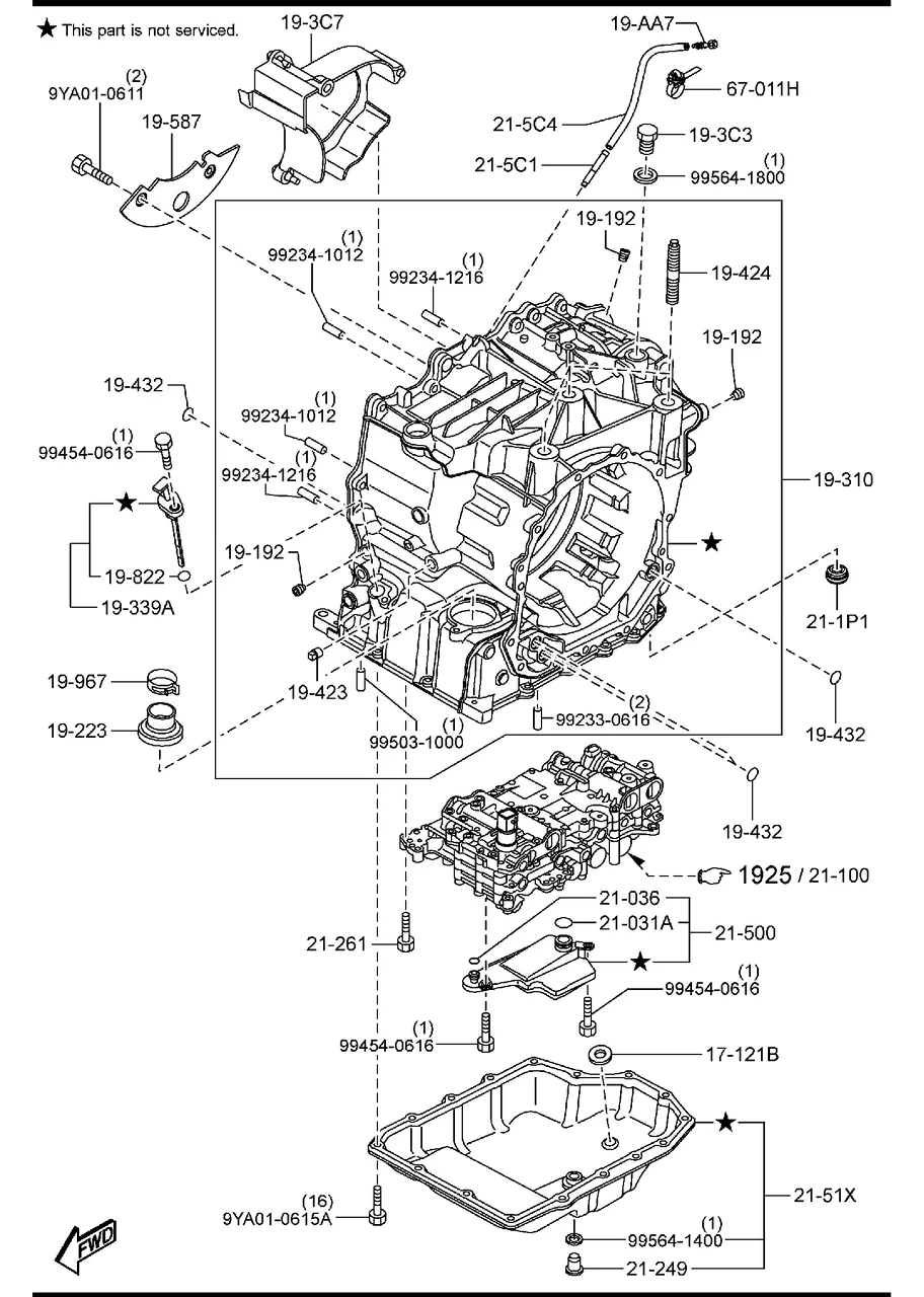

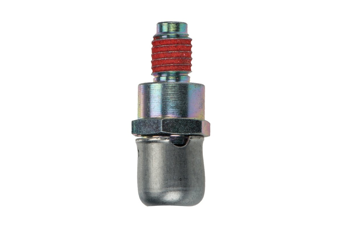

The one in the trunk area is the intake. The exhaust vent for the diff is on the top of diff . I ordered one of these back in 2016 to confirm it was an exhaust only diff valve using some vacuum tests. On the top of rear diff somewhere.. think I located it in the day but can't remember now. It was from this thread but pics and links broken now.
PN: B39M26060
#9 in schematic

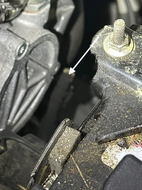

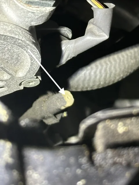

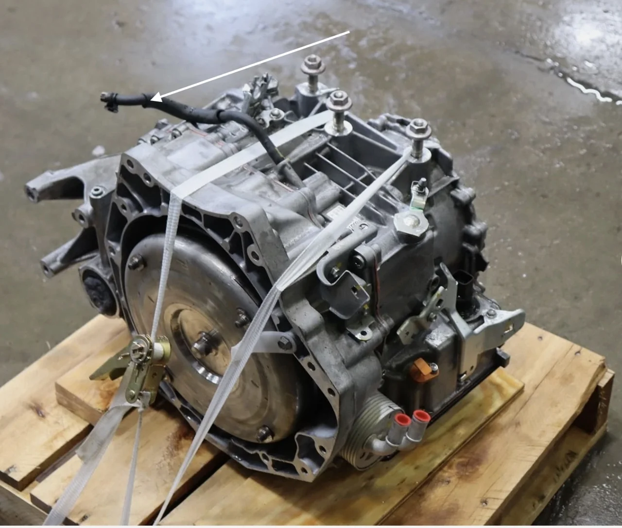

I see the AT vent on my '15 2.5L. I think it is clamped to a heater line. Look just to the left of the battery.
What do you know, it is literally right next to the battery, attached to another tube. Is there any mechanism that prevents liquids from getting in? This is good to know for when I wash the engine.
