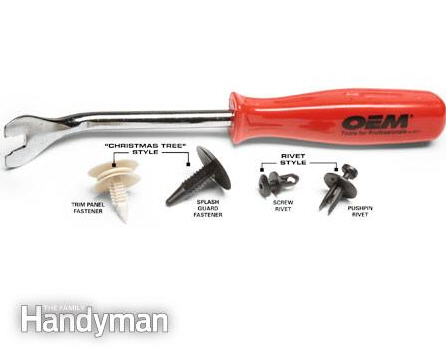

Is this the same rivets that we use to take off the cover when we change oil? If not where can I get them?
https://www.amazon.com (commissions earned)
that are close, not exactly the same

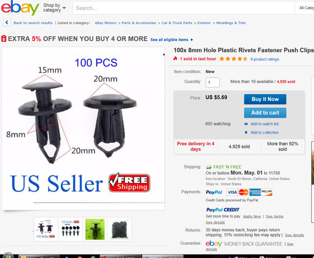

I got these, they work well, you get a lot more for the same price,
no need to spend $$$ on panel fasteners, they all pretty much work the same way as long as they are the 8mm diameter type...
just use a flathead screwdriver to pop them and they loosen then use a non-marring fork shape panel tool or pliers to remove the fastener
http://www.ebay.com/itm/100x-8mm-Hole-Plastic-Rivets-Fastener-Push-Clips-Black-for-Car-Auto-Fender-/272047153704?hash=item3f57462228:g:3uwAAOSw~oFXNtDX&vxp=mtr

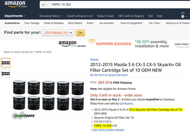

You are lucky in the states or canada you can find cheap OEM filters. I have no idea where to find them here in Australia and they are not being sold in any spare parts shops.
Actually you want to get PE01-14-302A if you can find one!⋯ you want p/n 1WPE-14-302 for CX-5
There're now 3 OEM Mazda SkyActiv oil filters:

We only have 1WPE-14-302 available in Australia.

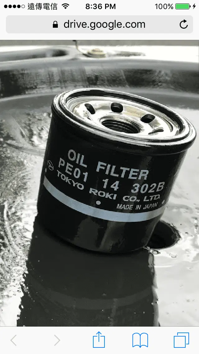

THat's what I've found: PE01-14-302A is made in Japan. PE01-14-302B is made in Mexico. 1WPE-14-302 is made in Thailand.Actually there's a newer PE01-14-302B oil filter in Japan used in 2017 CX-5. Not sure if this revised "B" version Japanese made oil filter would be available in the US?
That's really strange. Our "Value Line" OEM PE01-14-302A-MV oil filter is made in Mexico.THat's what I've found: PE01-14-302A is made in Japan. PE01-14-302B is made in Mexico. 1WPE-14-302 is made in Thailand.
Doesn't make any sense, seeing that that one on the pic is made in Japan.
Thanks for the info. So apparently there's a running change in Japanese oil filter from "A" to "B" during 2016.5 production cycle. Now I assume we won't see any Japanese filters until the stock of all older version filters is nearly exhausted.I changed the oil in my 16.5 CX-5 last week for the first time. The oil filter that came from the factory was the PE01-14-302B oil filter made in Japan, as pictured above. The filter that I bought online was the PE01-14-302A oil filter made in Japan.
