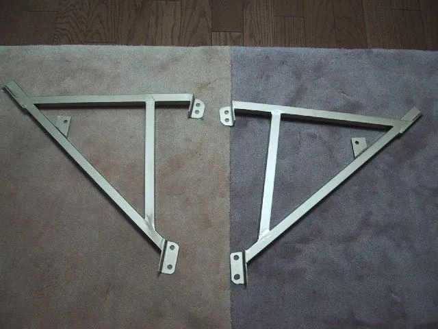

Berty, I was wondering if they are member brace or strut braces. Also if you have any pics of them.
I noticed most cosmo parts are not available these days.... even from AutoExe.
They are strut top, but I am considering having the front one modified so that it braces to the firewall also.
I have also attached some images of the triangle braces that go underneath the front quarter panels.

Berty, Thanks for that info.
regarding in fender braces... I was told by some FD owners that the fender braces are noticeable upgrade.. I have a set of R-Magic braces for me FD, but haven't had a chance to put them on.
I might get my local fabricator to make some under braces like the old AutoEXE for my cosmo.
