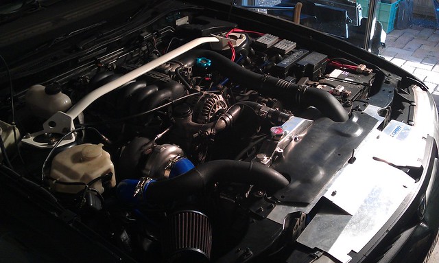

No videos as of yet, but I have got it to start and idle on the factory computer. It has made the car a lot louder than it was - seems like the twins absorbed a lot of sound energy.

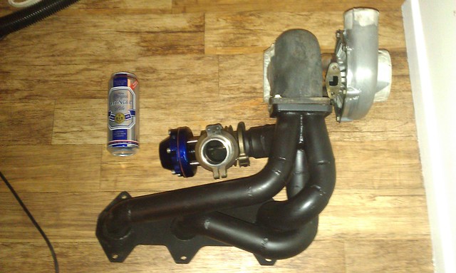

Here are the specs;
  • Garrett T04E 0.7 A/R front and 1.15 rear. (opted to go smaller than the 1.32 I previously had)
  • Falcon BA Turbo XR6 thermo fans and Davies Craig digital controller. (sooo much better than the previous set-up)
  • Turbosmart Pro-Gate 48
  • South Coast Rotary manifold
  • Braided lines
  • Xtreme Rotaries block-off kit.
  • Innovate LC-1 and XD16 wideband.
  • 3.5" dump pipe
I still need to put the fuel system and computer back in to tune it, but it is driveable in its current form with very safe AFR's so long as it doesn't go above 4K RPM.

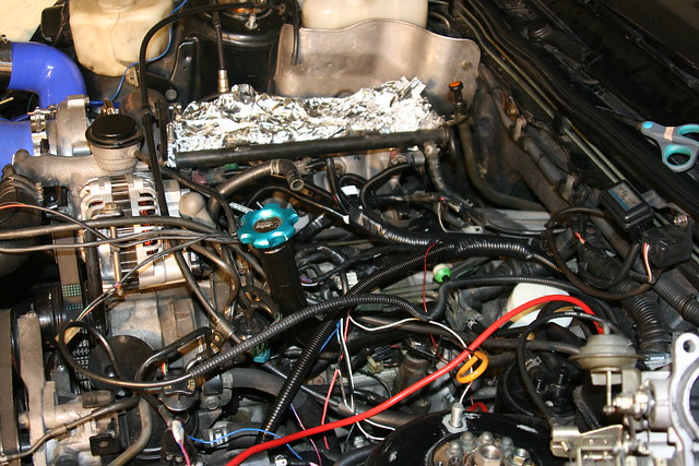

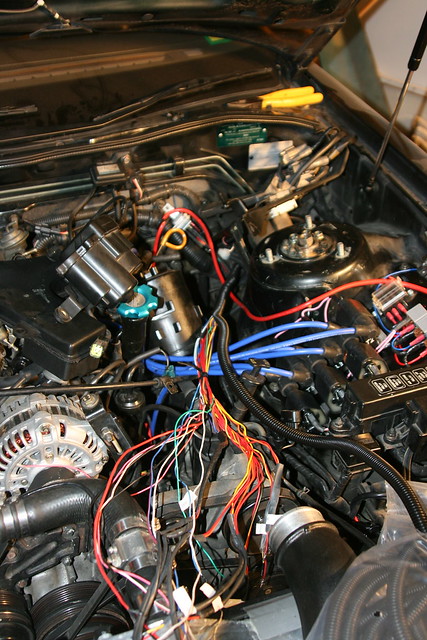

It is pretty amazing how heat takes it toll on wiring and electrical components. To give you an idea, nearly all of the connectors on the factory harness are brittle to the point were they crumble in your hands in you apply any force.
One of the more in interesting things though was when I have stripped back factory wires, the copper wires are actually corroded - not badly but enough that solder wont stick to them unless you give everything a quick sand.
Anyway, for the most part the wiring is complete. I just have the CAS to go now. One of the main headaches has been needing to retain the factory ECU and to piggyback some signals. If I could just rip the factory loom out things would be much cleaner.
Before...
IMG_8552 by bertybeatle, on Flickr
After...
IMG_8553 by bertybeatle, on Flickr
Still messy but getting there slowly.

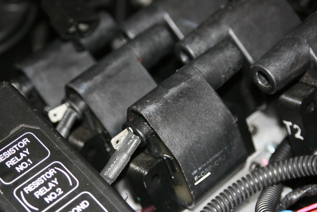

I also made a custom bracket for the new coils which includes a fuse box for the new ECU features and a bunch of relays.
IMG_8554 by bertybeatle, on Flickr
Install is looking fairly neat so far... electrical cable conduit is a great thing. 8--)
