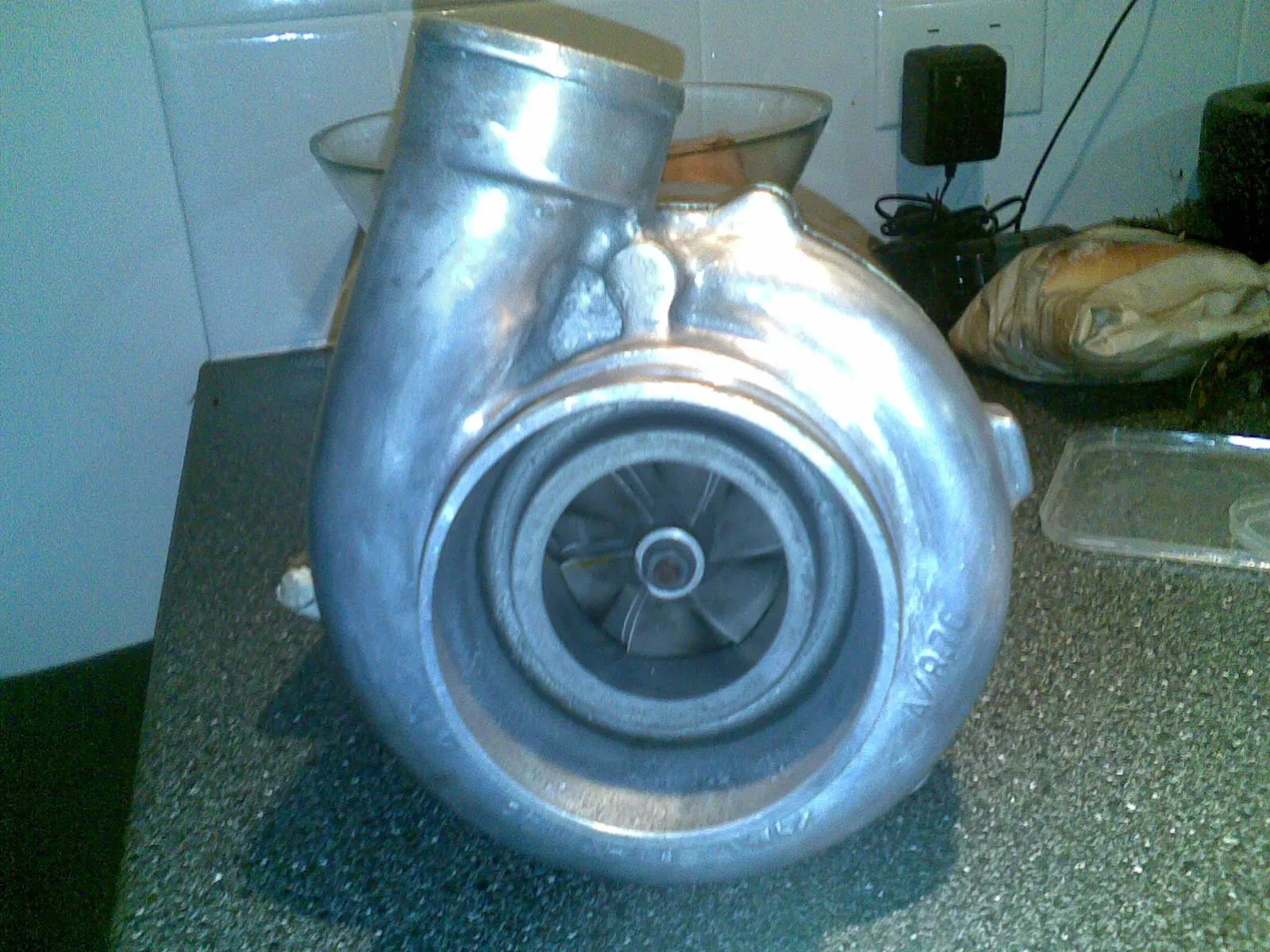

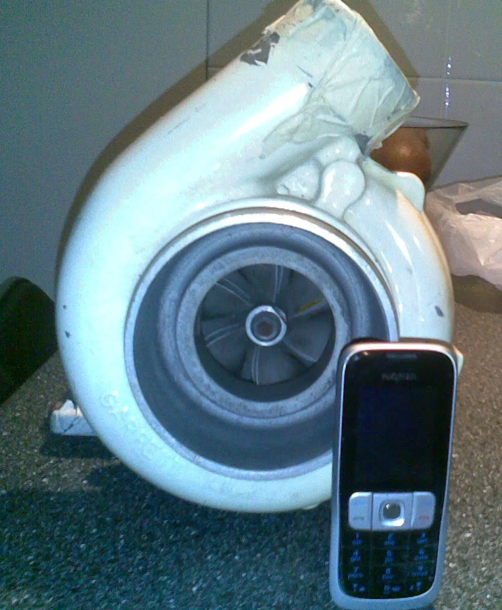

I wouldn't say that I fixed my boost issues, rather I managed to tune them out as much as possible using the computer and boost controller. I think that the vacuum network is nearing the end of its life so that is why I was having random boost drop outs.
I am only going to be running a single with the new setup, but if you take a look at the pic you can see why I only need one.
Bloody Hell Berty thats a monster,, are you going to have any lag issues with that ??,, when it comes on you better hang on,, and you have some bloody good tyres,, and I definately wouldn't want to be out on wet roads when that comes on song lol

Oh, and I just finished cutting the paint off the turbo!
She's looking good sat on those new rims,, That's some set up your putting in there Berty should make some serious power I just hope it is not all at the top end for you or could be a pig on the road or permanently in 1st gear lol.
