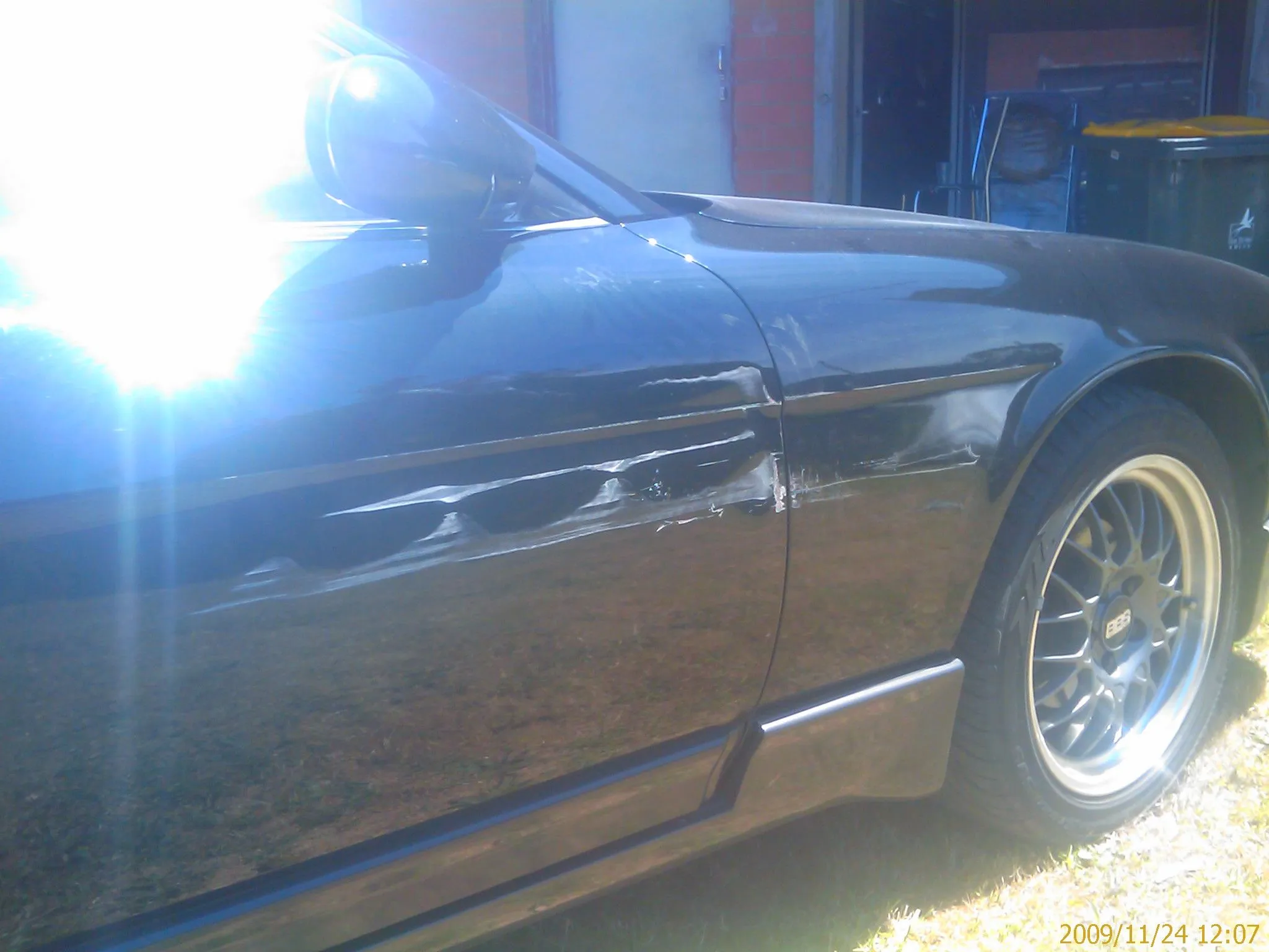

a truck reversed into me today.

Sorry to hear about the accident... are you and the car alright?

I'm fine wasn't in the car nor' did i park it where it got run into.was getting my ac fixed at an auto-electrician.
it broke the driver side mirror. and some scrapes. just barely dented. i'm glad it just missed the wheel well as that would have been hard to make look rite again.
the paints expensive...roughly $2300 just for that

Sucks to hear a Cosmo got backed in to!
Of all the cars to back into there are plenty of other options that would be much nicer for everyone!
