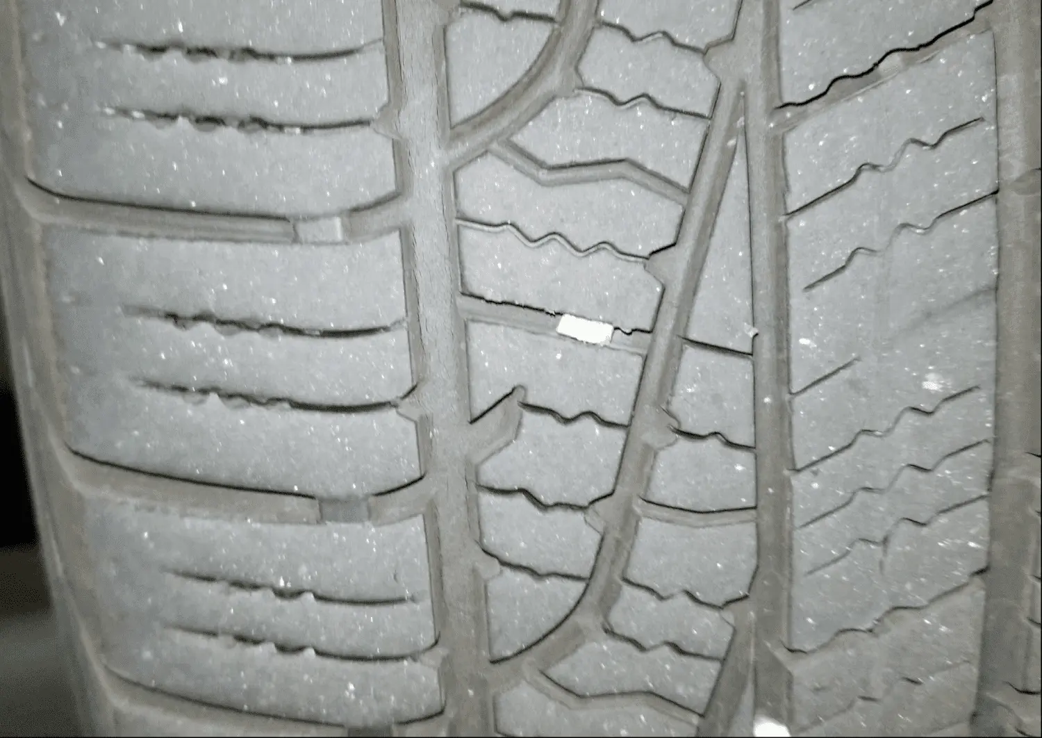

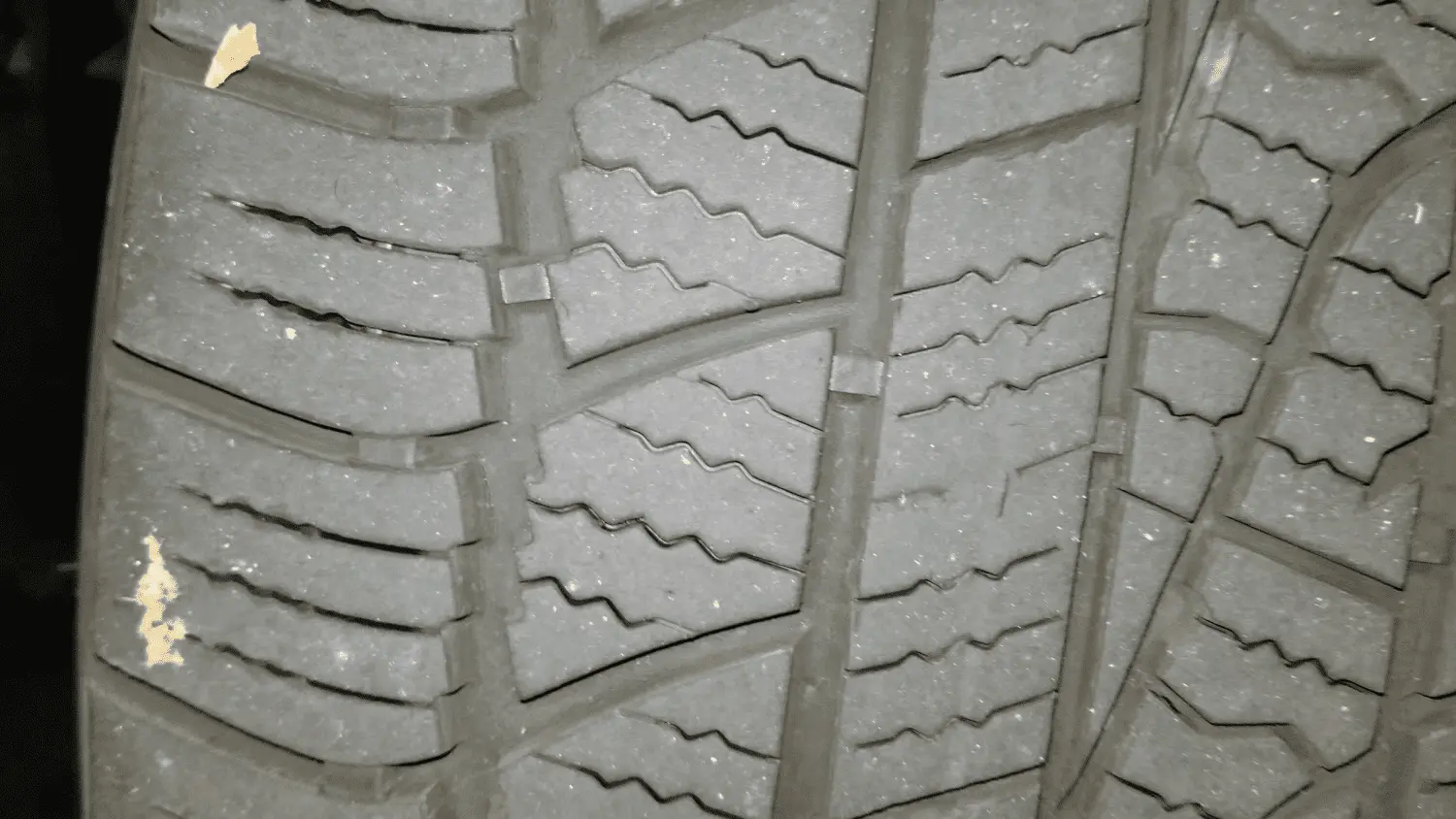

Again, Your car, your choice. If you would, please post up a picture of the tread on the goodyear's you are replacing. For a lifetime of over inflation, I would suspect they're worn in the center eh?

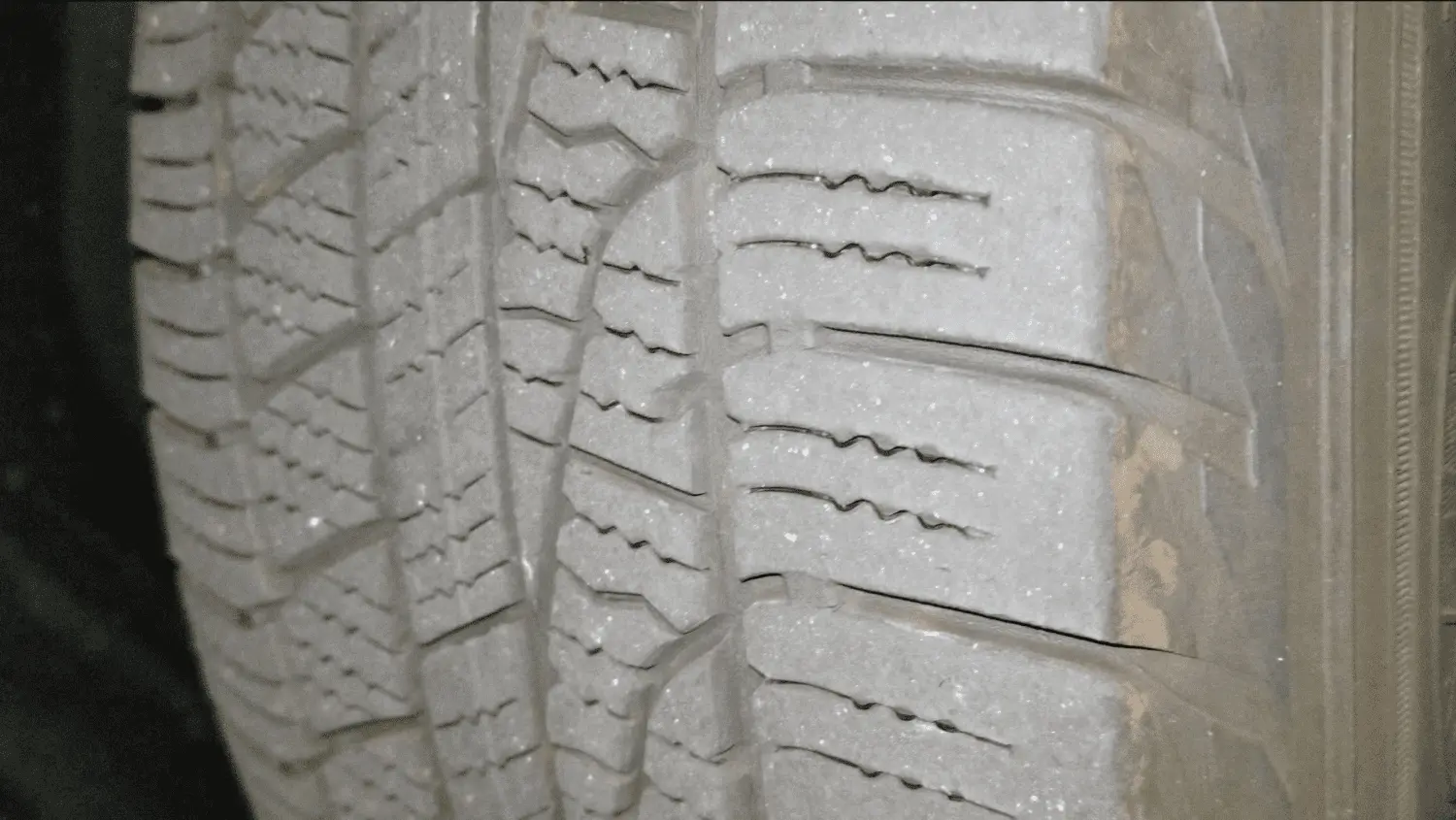

Not quite, they look fine in the center. I'm thinking that I may be replacing these tires a little too soon but I suppose you can take a look and provide your insight :).

it's pretty clear from those pics that the center of the tire is wearing faster than the sides from being overinflated.
as was mentioned, the max psi is the structural max the tire can handle. the manufacturer has no idea what vehicle the tires will be put on or how much it will weigh

I went back out again and did the measurement using Lincoln's head instead since it's actually very difficult to depict the tread without a comparable object.
Driver (Front) - Inner Tread
Center - 1
Center - 2
Outer Tread
Driver (Rear) - Inner Tread
Center - 1View attachment 229054
Center - 2
Outer
Use a tread depth gauge at 3 or 4 places around the tire for an accurate reading.
Thanks for the pics. For me, the variables at play for my tire replacement decisions aren't necessarily visual tread depth but rather how they feel when I'm driving. The easiest time to feel the tires on the edge of their performance limits is when traction is reduced (rain,snow,dirt/gravel). The car behaves similarly on dry roads it just takes higher forces to get the same results.
I'd guess you are probably similar to me ... If you regularly drive in a "sporty fashion" you're very familiar with the edges of the traction envelope and know when the tires no longer suit your driving style.
Tread depth is a compromise ... More shallow tread is more fun on dry pavement with less squirm but conversely bad news for contaminated surfaces. Need more tread depth to handle rain and snow and mucky yuckies. That's where a tire has always shown me first when it's done (for me) is wet roads.

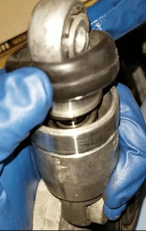

Upon pulling back the silicone/rubber housing, the fluid seems to be a very light viscosity/consistency. I did spill a bit of the fluid since it was tilted and when I inspected the insides, there really doesn't seem to be much in there at all (seems empty).
I don't know if it's still a good idea to install the OEM one back after spilling some of the fluid out so I may have to reconsider that. If anyone knows what kind of grease I can fill it back up with, feel free to let me know.
I did try to pull the tensioner arm back and forth (gently) and it feels a little stiff. Not sure if that answers your question or not.

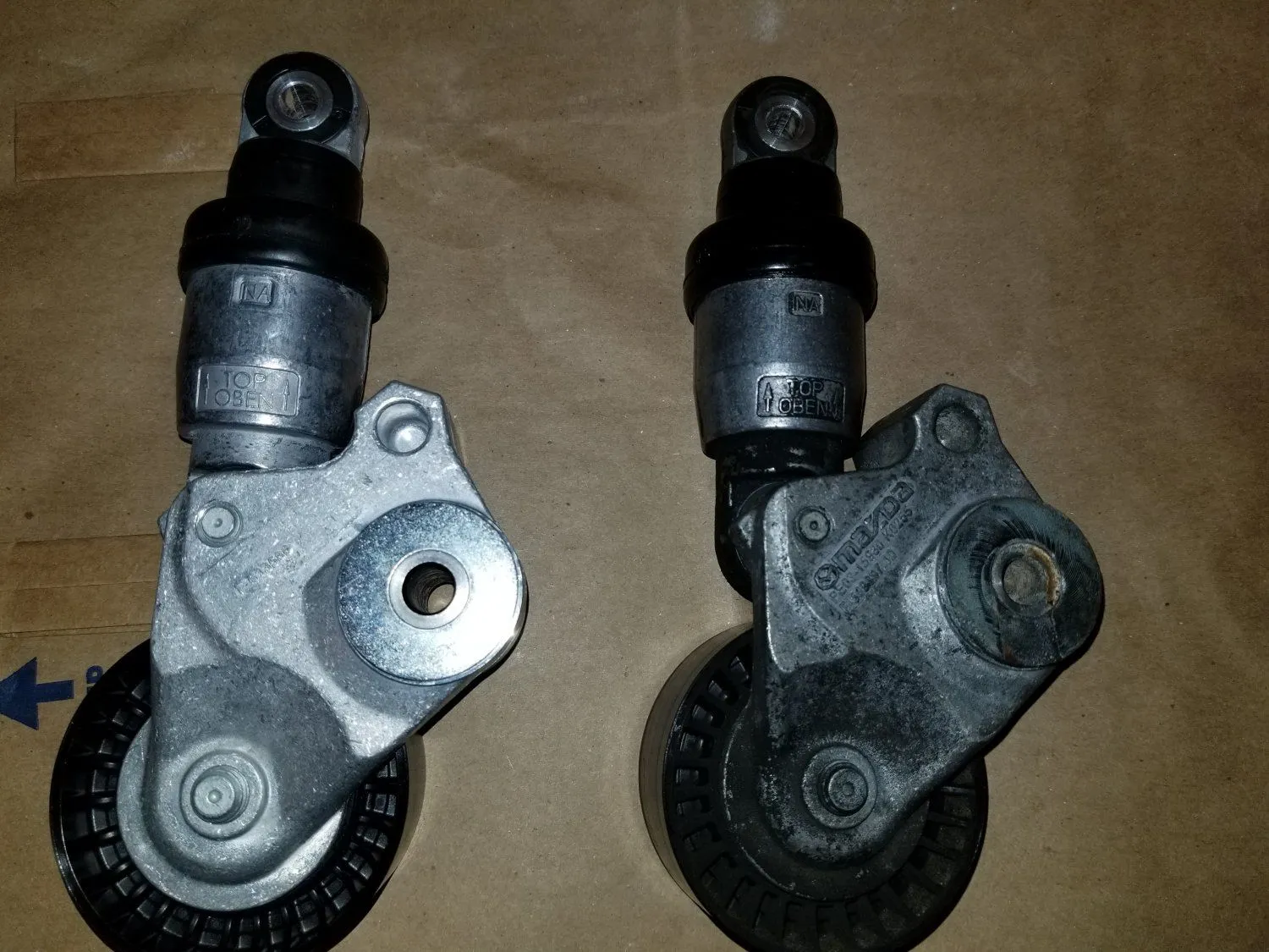

Seems like RockAuto has the INA FT01291 back in stock. I bought it and now we can finally test the below:
  1. Whether or not the serial # is >".10". Based on the pictures on RockAuto, it doesn't seem like it has the Mazda logo stamp so I don't think the serial #would appear.
  2. Whether or not the OEM/Aftermarket belt tensioner makes a difference in power/acceleration.
  3. Whether or not I am wasting $$ on these belt tensioners. = Yes, I am.
Will provide an update once I install it unless it starts snowing then never mind hehe

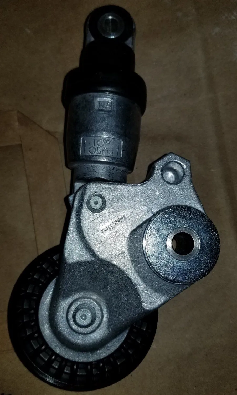

Update 11/27:

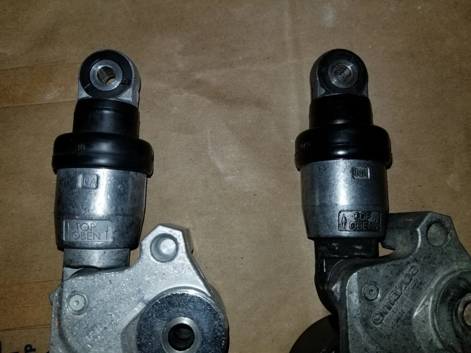

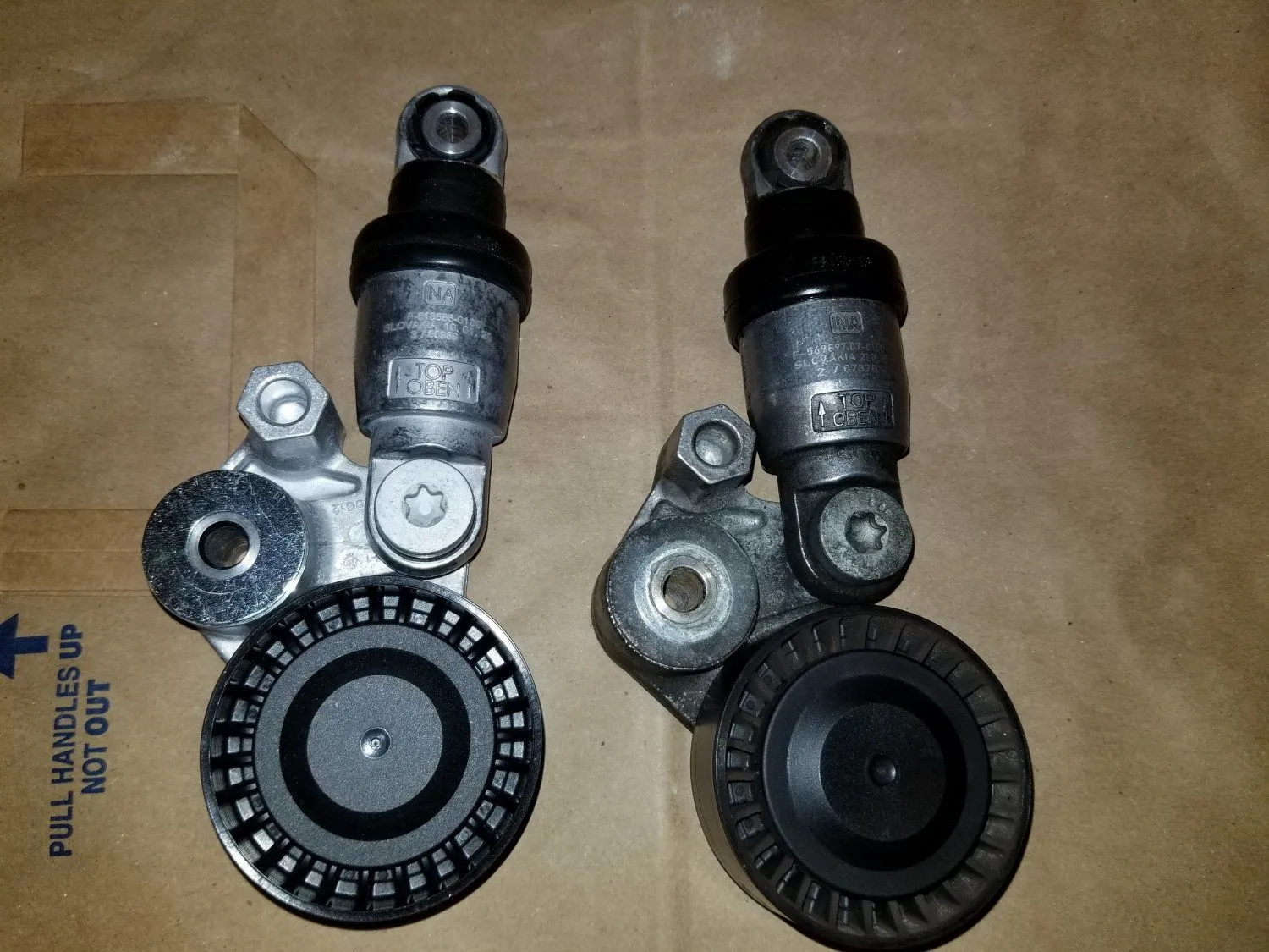

The new INA belt tensioner has arrived today. Based on my observation, the OEM INA and the aftermarket INA belt tensioner look exactly identical. The only difference is the date stamp on it and serial #'s.
The packaging is kinda crappy if you ask me because the pictures you see below are exactly how the belt tensioner arrived. Nothing held the tensioner in place while it moved/dangled/jumped around inside the box so I hope there was no damage. Visibly, there is none but I'll find out once I install it.
I'm really hoping this resolves the issue with the Gates tensioners lackluster performance at high revs (60 mph+) and I think I have a conclusion of why it feels different from the INA one. It could be that it is more refined/better built due to the "vibration dampening system" but I could be wrong since it's just a theory.

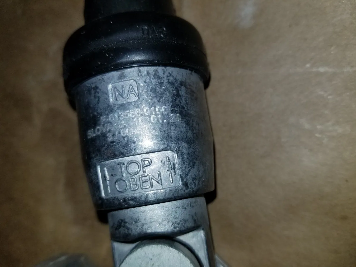

OEM:
F-569897.07-0100
SLOVOKIA 21.10.15 (MM.DD.YY)
2 / 07378
Aftermarket INA Tensioner: SLOVOKIA
F-613586-0100
SLOVOKIA 10.01.20 (MM.DD.YY)
3 / 00959
Here are some photos
That crispy refinement is why the OEM one is more money. No casting edges and the lettering and angles are sharp. But the three most important things are having the right spring tension, how the bearings and pivots wear and how long until it leaks.
Use method mentioned in http://www.mcx5.org/drive_belt_removal_installation-1230.html to check the workings of it.

Does the new one feel stiffer when you work the cylinder back and forth compared to the leaky one?
Does it seem to have a better seal?
Appreciate the report Digbicks. The good news is you know how to change the tensioner. The bad news is not having good experience with the Gates tensioner.
I have no idea what type of fluid they put in there. My guess is hydraulic fluid?
