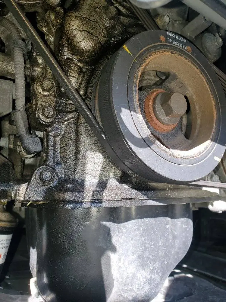

Do you guys think all this oil can be from the tensioner? Any other common leaks on passenger side of the engine?
I just replaced it together with the serpentine and water pump belt. About 2 hour job, 30 minute of which was cleaning the oil (so I can track if it stopa). If I have to do it again tomorrow- under 1 hr. No special tools required if you have the basics. The OCV solenoid/seal (top of engine head) is also sipping oil - that job is for next weekend.

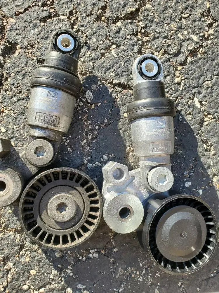

Also attaching picture of the latest INA tensioner from RockAuto. I noticed the pulley is no longer replacable. Seemed to be snapped on in there vs held by a bolt. Not a big deal but sad to see more of the one time assembly parts. Manufactured May 1st 2021.

The factory belt tensioner on late CX-5’s, such as the one on my 2016 CX-5, all look like the new INA one you got on pulley, production change. Unfortunately revised tensioners from factory are still prone to leak.
Your leak based on pictures can’t be from belt tensioner as the oil in the tensioner is very thick, and not much in there. IMO it most likely is from the valve cover gasket. You want to replace the VCG and OCV、OCV seal at the same time. Here’s a good source to get OEM OCV:

The other possibility on oil leak in that area is timing chain cover. There’s a TSB for it, but the job is complicated, and many times the Mazda dealer has to do it a couple of times, but it still leaks.
TSB No.: 01-018/18 OIL SEEPAGE AT ENGINE FRONT COVER

No, dealer did some work on the OCV (not sure if they replaced just the seal or seal + solenoid) that time. It is leaking bad now.
It is the first time I am replacing the tensioner and unfortunately I forgot to check it's tension before I removed it. But at $45 - it was a no brainer to replace with the belts since it is such a common failure.
