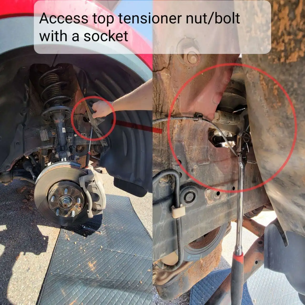

The top bolt/nut on the tensioner was pretty tight and easily rounded with a 12 point box end wrench.
I would definitely recommend only using a 6 point wrench or socket (which is always good advice on a car) and recommend accessing it through the wheel well using a socket driver and a 3+ inch extension. This would also allow a torque wrench (17-22 ft lb, info thanks to Digbicks1234). Pic attached showing where I did that.
If you don't use a socket, I'd recommend buying a new nut (part #19994-00-801, info thanks to Digbicks1234).

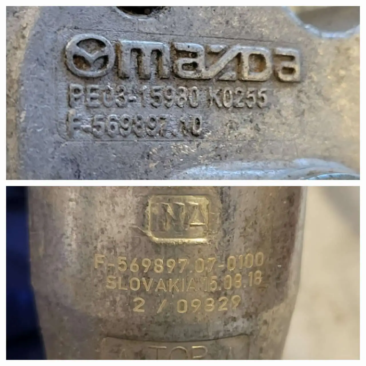

And I've attached pictures of the numbers on my original tensioner which hasn't leaked at 62,000 miles. At least at some point people were interested in those.

Thanks for the report of your experience on replacing the tensioner and sharing the pictures. Somehow I’m getting “The requested content cannot be loaded” error from your first picture.
Can you tell us what kind of tensioner you’re using? If you use an OEM, what is the current part number?

Is the picture showing up now? I replaced it with one that has better labels and it may have taken a minute for the site to update.
I used a an INA from RockAuto ($40). RockAuto lists the part number as FT01291 but I forgot to check the numbers on the tensioner before installing it.
Yes, I can see both pictures now.
OEM tensioner has INA mark on it, but the price is tri-fold with a Mazda logo.
