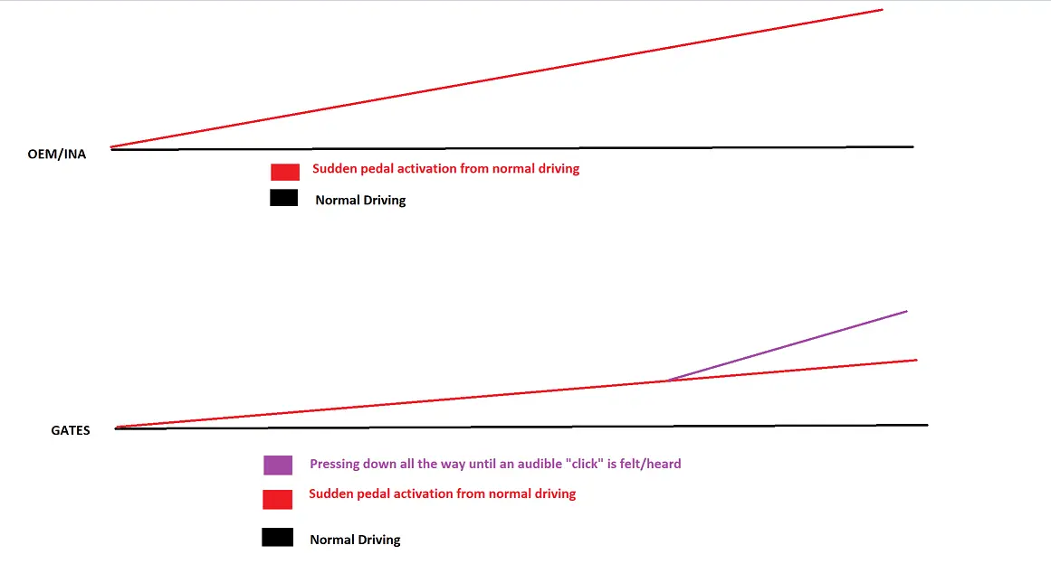

This diagram below illustrates how I feel using both. It's not supposed to be 100% accurate but it gives you an idea at the very least:
I did not disconnect my battery this time prior to yesterdays spark plug change. It has been as-is so this is a direct comparison between two belt tensioners. I'm really trying to think of some theories of why the vehicles characteristics feel so different after the belt tensioner change.
Could it be related to:
  1. The type of fluid being used as a lubricant inside?
  2. The rubber boot material that's different? The GATES one looks much more durable and more stiff looking compared to the INA one which is a very soft/supple rubber. I'm thinking that this is a very likely possibility.
I know that OEM hardware are typically tuned to work the best with our vehicle and using aftermarket parts may make a difference but I just can't wrap my head around this belt tensioner.

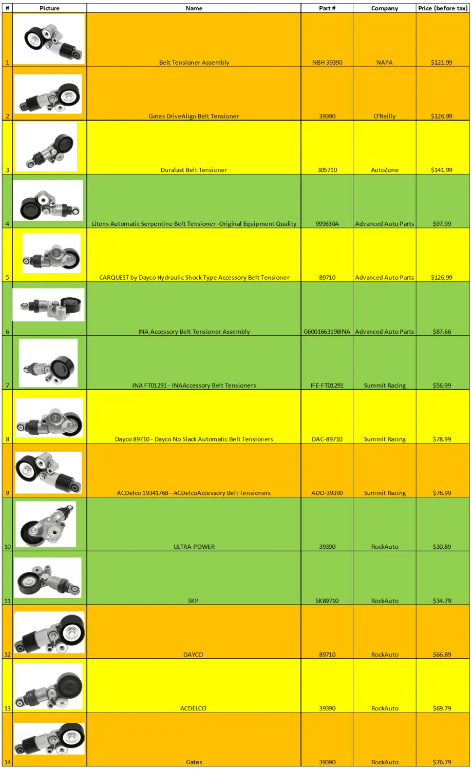

Very good question. I actually went through most of the major auto parts sites and they look more or less identical. It seems like most of the belt tensioners follow (3) design types but see a list below I put together for reference. As for me, I don't plan to buy any more belt tensioners but I hope someone else would be willing to haha.

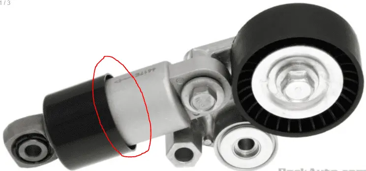

Can you elaborate this about the leaking new Gate tensioner? The damper is totally sealed and I don’t believe it has anything to pry open like OEM / INA tensioner with a rubber cap seal?

I remember the price on OE INA belt tensioner was one of the lowest among many listed on RockAuto website for Mazda CX-5. It seemed always out of stock whenever I checked. But for some reason OE INA tensioner you just got is no longer listed for Mazda CX-5 on RockAuto website anymore.

To give a little more context, I was performing the belt tensioner swap when it was about to get dark and when I was taking out the GATES tensioner from the top of the engine bay area, I noticed my gloves started to have a oily liquid substance on it. Then upon looking at the tensioner itself, I noticed that there was fluid leaking from the bottom of the hard plastic boot. I did not take any pictures because it was already getting dark and I still had to bleed the new belt tensioner and then install the belt back on but for illustration purposes, the leak was coming from the red circle.

The OE tensioner on RockAuto is definitely the cheapest out of the bunch aside from the "Economy" versions that are listed. By the time I noticed it was there and announced it in one of my earlier posts, they said it would arrive by December or something but somehow it shipped out even earlier than December so I was very surprised. You still have other alternatives though, such as Summit Racing but their ship date is in December also. Then there's AAP charging $87 for it...

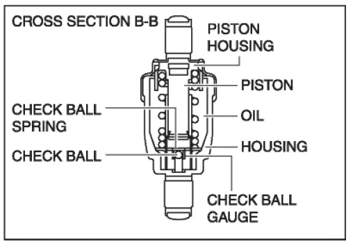

I always think the damper on belt tensioner is just like a mini shock absorber. It’s sealed with piston、bypass valves、and hydraulic oil inside. It’s not supposed to leak until the seal is worn out.

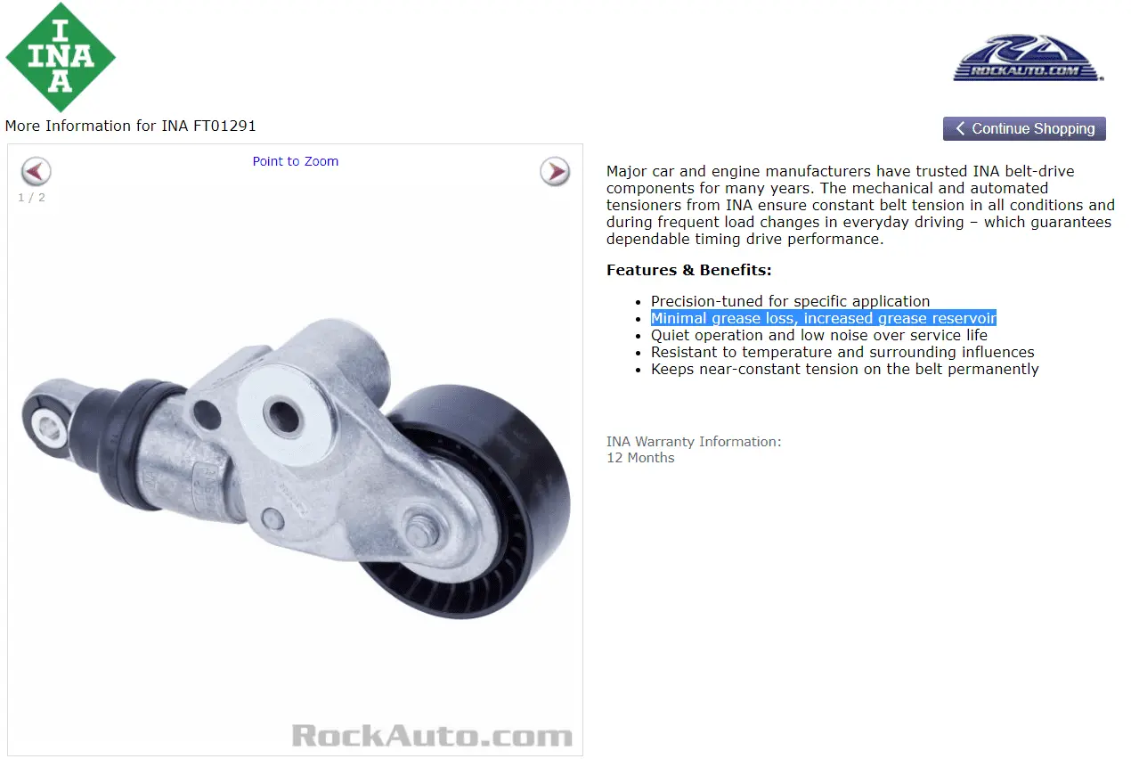

The reason why I brought that up was because in the listings for some of the belt tensioners, they mentioned about "minimal grease loss" such as the INA one that sold out. This makes me believe that the fluid over time will eventually seep/weep but not to the point of rendering the tensioner useless but like any wear item, it'll eventually run out of the lubrication required to operate the component.
Not a rush at all. I kind of regret changing mine now that I think about it. I don't really notice significant leakage or leaks at all. I just did mine because it was being mentioned by everyone on this thread and I wanted to play it safe hehe

  • Spark plug replacement yielded a slightly noticeable increase in the acceleration; engine felt slightly louder. This could be attributable to the fact that the spark plugs condition is NEW and that's why I felt the difference.
  • Replacing the GATES tensioner with the INA one solved my problem with the pedal kickdown switch. With the OEM tensioner, I did not have this issue where I had to literally press my foot all the way down to the floor and then apply 30-40% more pressure to hear a "click" in order for the car to downshift/accelerate quicker at highway speeds.
