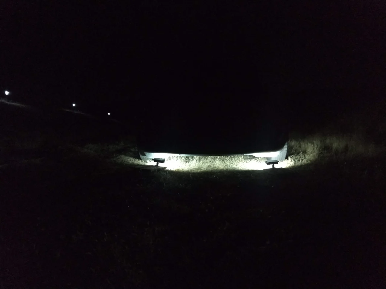

Outside on the ground, I have three cold white led lights mounted on wood boards pointing at the undercarriage. I used to toss the ones that met their demise. Now I keep one or two in a box by the wheel. That smell is more of a deterrent than any essential oil. The ants usually take care of the mess in a week.

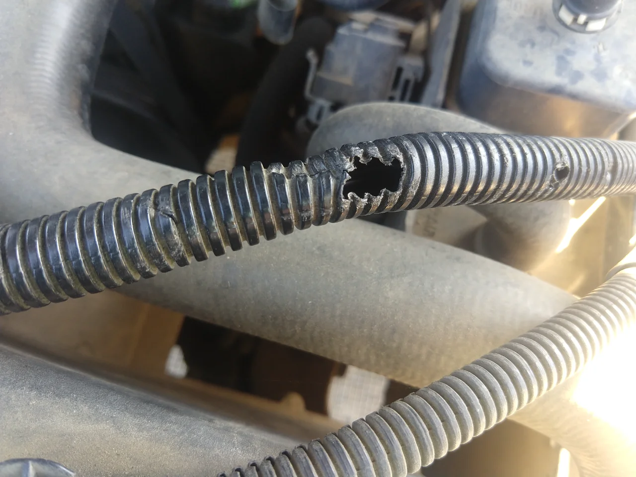

Between the two types of split loom sleeves that I have used, only the plastic tubes (as pictured) have sustained damage. The woven type has not. I believe it is because the plastic tubes are more rigid, whereas the woven kind would just collapse when force is applied. I might do a human bite test later, on clean sections, of course.
This is the second time that I found bite marks on the plastic tubes, and both times they covered USB-C cords that were "live," i.e., the Bluetooth speaker playing ultrasonic clips, and this time the sunset light. Those mice are smart enough to find the cords from the offensive devices. They didn't mess with the tubes/wires connecting the solar panels, charge controllers, and battery terminals. Damaged sections are still usable, I just wrap it with tape, most tapes except painter's tape.

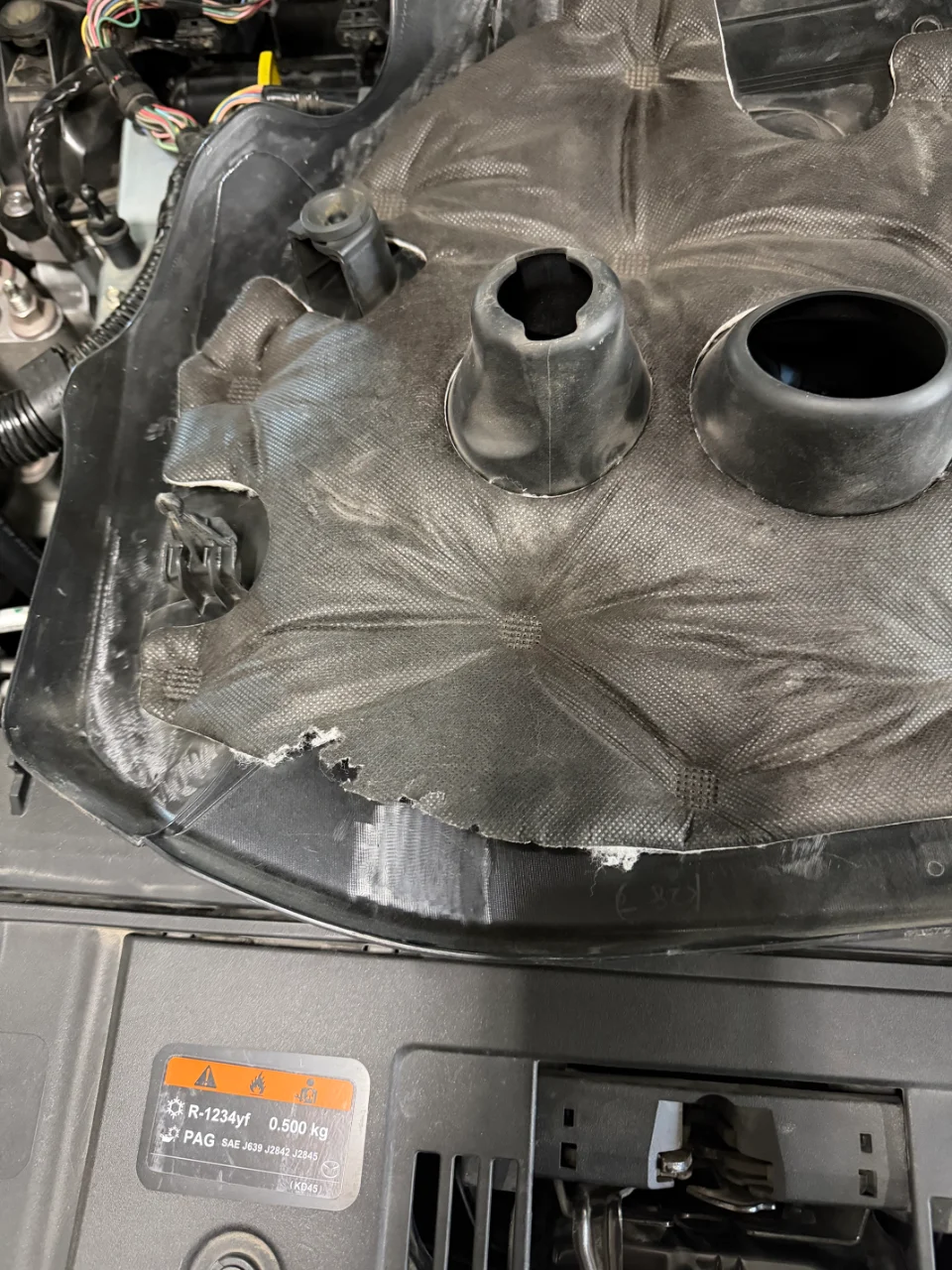

never chewed any wires but used was chewing on the engine cover insulation...moved it over to my jeep and was using it to make a nest....I set a trap and got the little bugger...
I had the exact same thing happen to my engine cover. Ended up pulling out all of that fabric and insulation, hardly was anything else left.

trust me there are multiple traps but never had any signs of mice prior or since....
