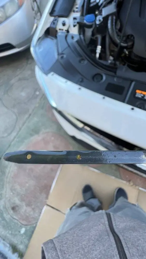

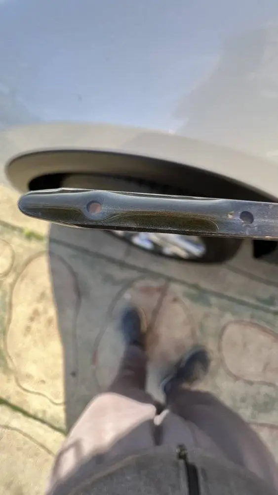

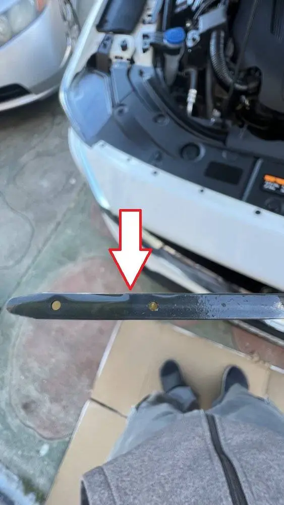

Here is before and after photo of cold oil level, 1st is before. I used whole 5 quart jug.

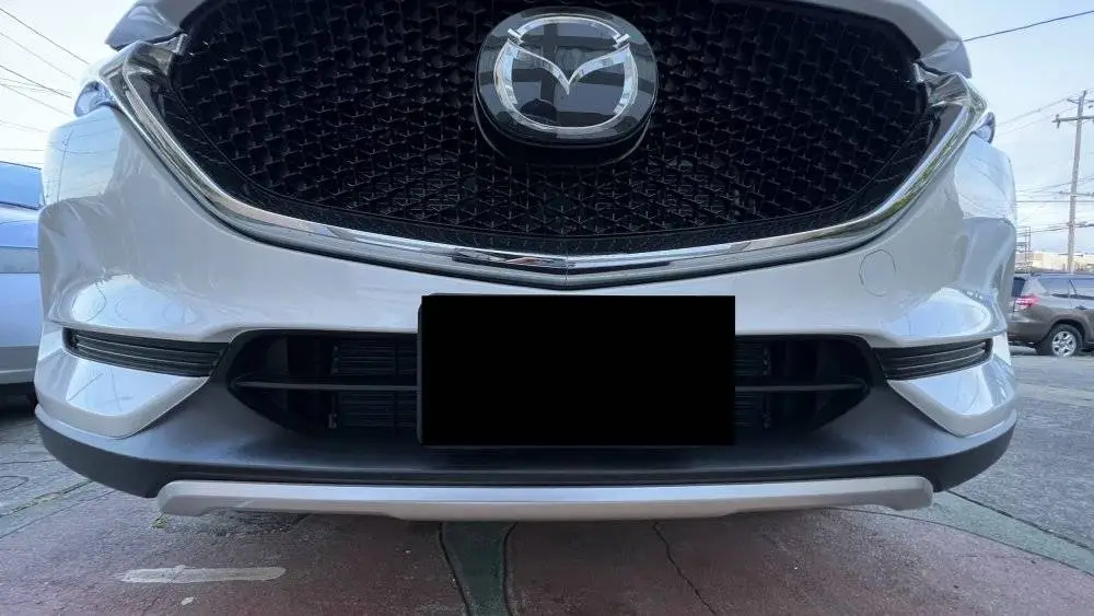

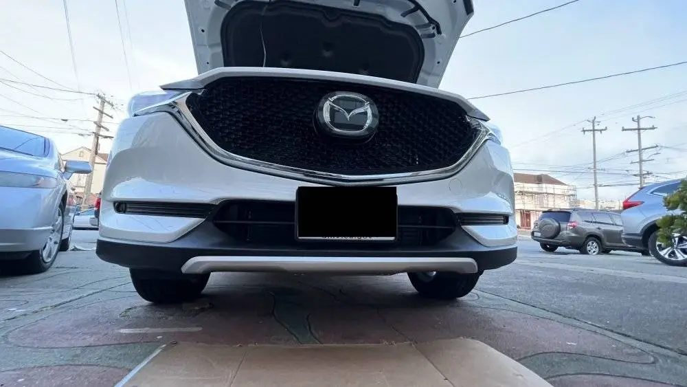

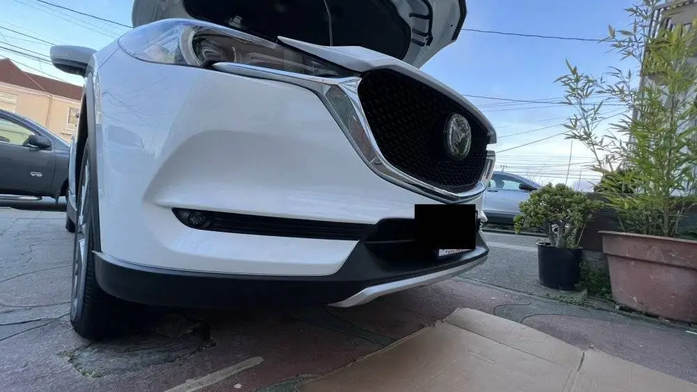

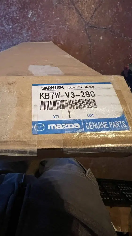

I also installed a front garnish after oil changed.
Upvote 0
This’s weird. Before photo on oil level indicates you shouldn’t have oil consumption issue like some 2021 2.5T’s based on the TSB. But 5 quarts of fresh oil makes you over-filled about 0.5 quart?
The manual says 5.1 quarts on the 2.5T for the oil change. Many DIYers say 5.5 quarts. Something just doesn’t seem right. :unsure:😜🤪
Upvote 0
I don't think you're reading it right. Looks like oil level is just below the max mark to me.
Upvote 0
This’s the “after” picture posted by Glee217. I can clearly see the oil level is about 0.5 quart higher than the Max mark, to the bottom of the front bumper in the background. Or I can see another “flat line” which is about quart below the Max mark?
Upvote 0
That's just oil from the dipstick tube. Common on warm engine oil level checks. Actual oil level is this, IMO.
Upvote 0
Yeah, but Glee217 said he checked the oil level when cold, not warm. The oil level line on the dipstick shouldn’t be a perfect 90° straight clean-cut line like that. The oil mark ½ quart above the Max hole seems to be more natural to me. When I check the oil level on mine when cold, the oil level mark always looks like that.
Upvote 0
Sm1ke’s reading with arrow on 2nd photo is right but it was not on a warm engine. I pulled stick out then read it and wiped it and reinserted it amd read it again thats why it might have caught some oil from dipstick tube.
Anyways it seems I am not concsuming any oil since its less than 3k mi. So hopefully same goes for the future lol.
I got the front garnish on ebay awhile ago.
Upvote 0
Slope of the driveway/garage floor may affect what the level looks like as well. I usually check my oil level in the garage, but even then, sometimes it looks like it has a "step" to it, other times its a straight cut.
Upvote 0
Thanks for confirming. Hopefully your CX-5 ownership is problem-free!

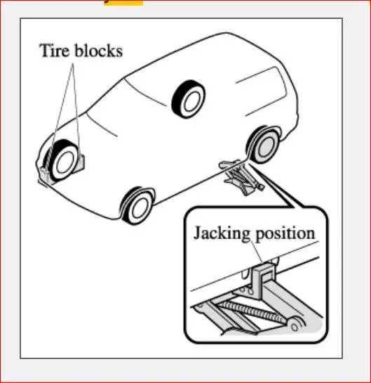

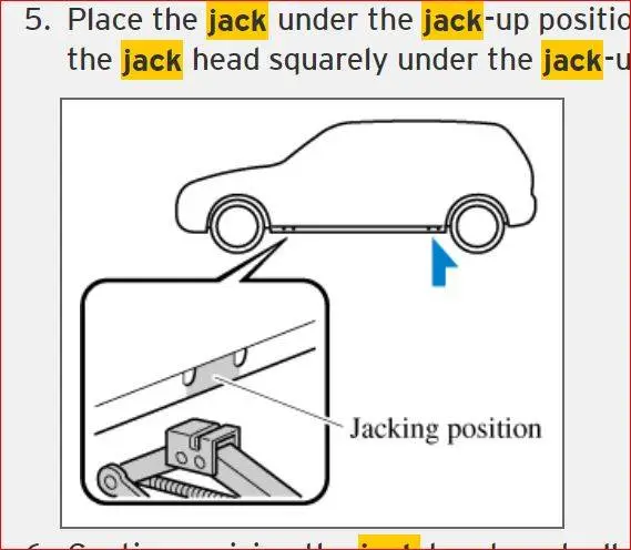

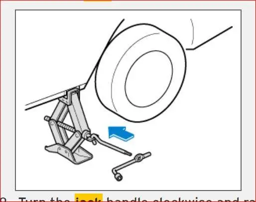

For tire rotation, I used a hydraulic jack w/round rubber puck on the jacking point that is located inwards (felt padding) of the fin for front and scissor jack for the rear. I used the hydraulic jack on this jacking point because this is the jacking point for the scissor jack (not the outward area of the fin). Underneath the felt is good solid jacking point for the front (last three photos). The rear though is alot narrower so I only used a scissor jack. I also had jack stands for the front (dimples) and rear differential.
AFAIK, you're supposed use your floor jack on the pinch weld(shown with RED patch on first two photos). The inside with felt area is just a sheet metal, not strong enough to support the weight of your vehicle(don't ask me how I know it). Scissor jack on the same spot as well.
Another, you should always use jack stands as a pair. You've been lucky this time. Is your floor jack rated for 3 ton? Looks kind of skimpy.
Upvote 0
To be clear for the rotation, I used both hydraulic jack and scissor jack AND jack stands for front (dimples) and rear diff.
For the jacking points, if you used the scissor jack to jack up the car you can clearly see that the scissor jack makes contact with the FELT and not with the weld! You can try it and see. Maybe its diff for other years but for my 21 GTR turbo awd it contacts the felt only. I dont want to risk warping that thin weld lol.
Upvote 0
I see you placed one jack stand on front and another on rear, that's what I'm pointing out. Jack stands should be used as a pair, either on front or rear, the same height.
Here's a few screenshots from 2019 CX-5 OM, and this should apply to ALL CX-5s not just 2019 MY.
