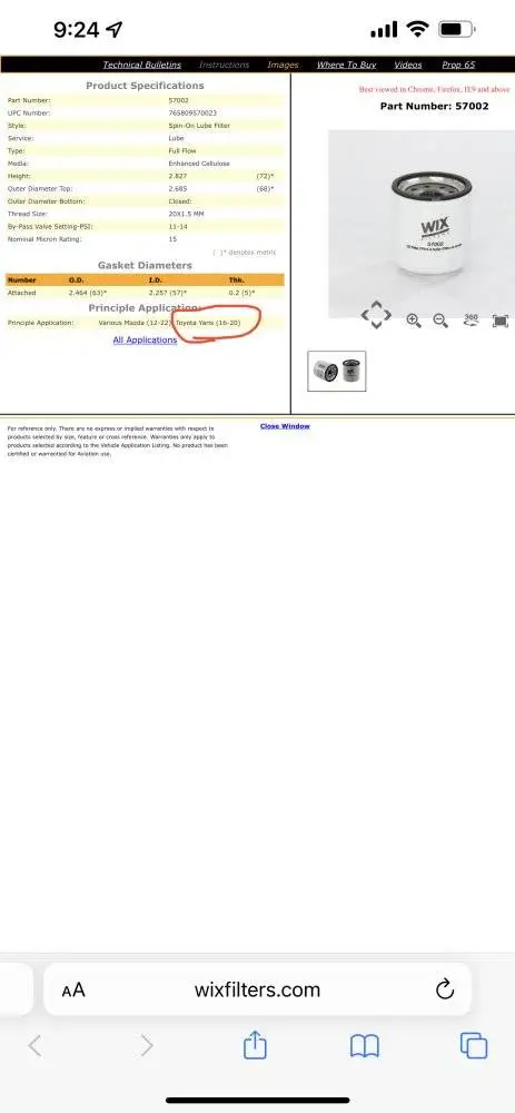

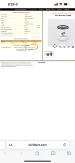

I find it interesting but, disappointing that WIX and Fram list one filter for both Turbo and NA engines.
And WIX 57002 fits a Yaris too so therefore I will be using Mazda Thai made filters.
Toyota Yaris iA is a Mazda2 in disguise. Parts sold at Toyota dealers for Yaris iA are actually re-labeled Mazda OEM parts. Ask how I know? I have a 2018 Toyota Yaris iA.

But Mazda oil filter still better?
WIX claims its 57002 oil filter is specifically designed for Mazda’s SkyActiv-G engines at beginning. But when Mazda came out with the 2.5T which uses different oil filter, Wix sill says 57002 is for the 2.5T. Other aftermarket oil filters are worse, claiming one oil filter fits every Mazda engine and dozens, if not hundreds, of engines from other car manufactures.
Yes, Mazda OEM oil filters are designed and manufactured to meet exactly the specs, hence they have to be better.
