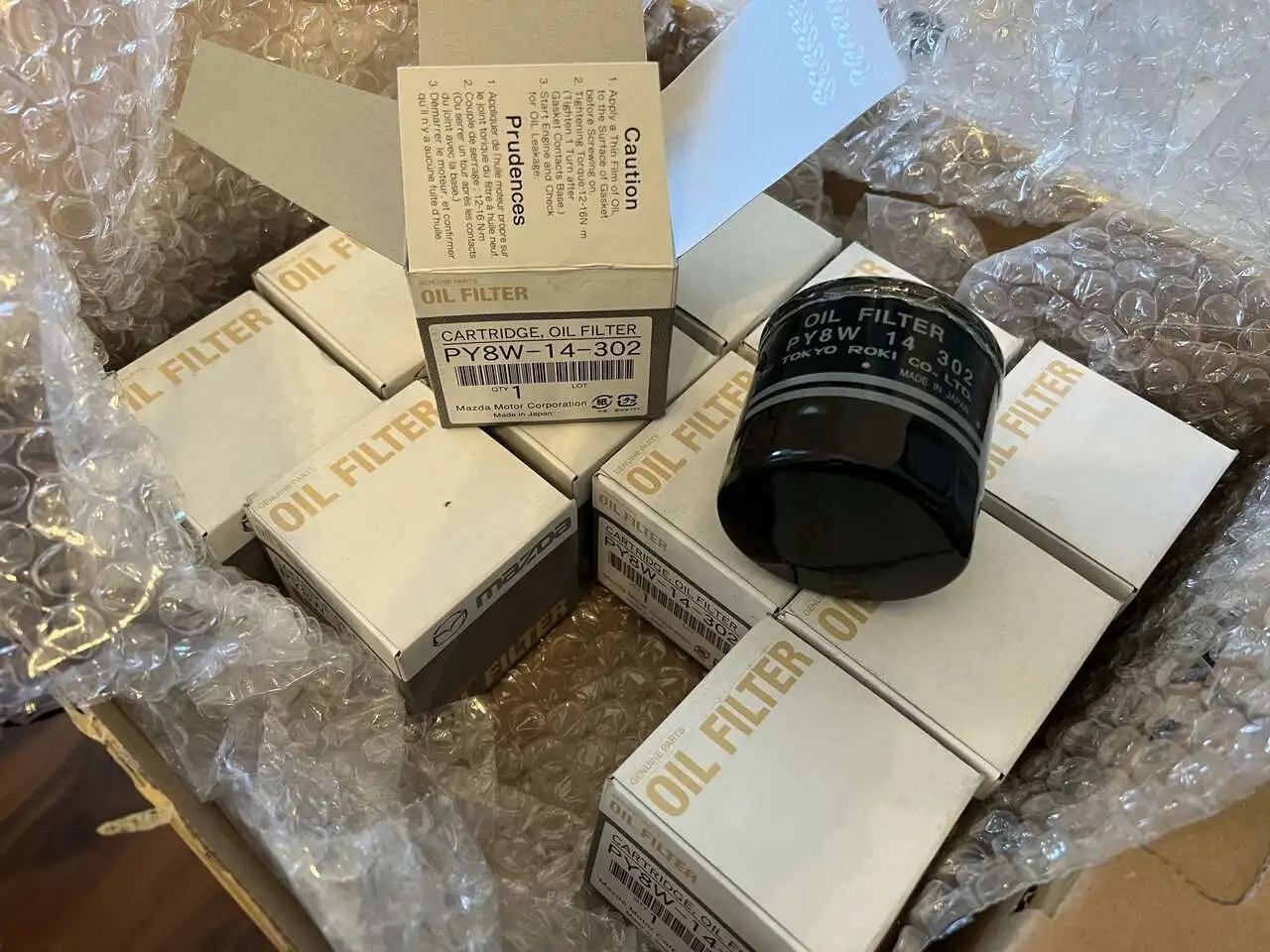

Ordered on a Saturday morning, and they arrived Thursday morning. 4 business days DHL cheapest shipping option. Packaged well!
