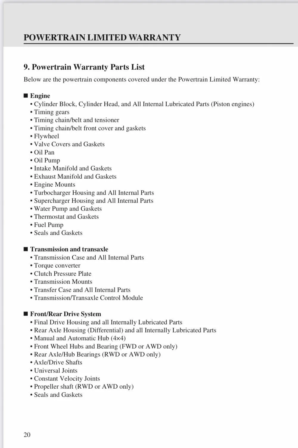

You don’t have to pay for this repair as thermostat and gaskets are covered under 5-year / 60,000-mile powertrain warranty. Just take your 2018 CX-5 with a copy of TSB to your Mazda dealer for warranty service.

So now I'll enter my guilty plea for not looking at the items covered under the power train warranty 😔
Being a DIYer, I'm not personally at all concerned about stuff like the thermostat, and also just assumed Mazda was like most other automakers with respect to what their powertrain warranty covers. So I was quite surprised to see the t-stat and the pumps on the warranty list, and hats off to Mazda for including these items. Another reminder to never assume anything. And thanks for posting this, which hopefully the op will come back and read.
Not just Mazda, I believe a typical powertrain warranty will cover thermostat and water pump, part of engine components.
I've spent most of my time during the past few years in the world of Kia/Hyundai, and can say for certain that their powertrain warranty does not include what Mazda does. The water pump is covered, but virtually nothing else external on the engine. And these automakers have even denied coverage of the transmission temp sensor, which is located INSIDE of the tranny case. I've also, worked on other make family vehicles but those were higher mileage, so I rarely (if ever) checked those warranties.
But again, this subject is not important to me at all, and I have no interest in doing any additional research. I'm certainly willing to accept what you said about the warranty of most other automakers, and just leave it at that.
Although never interested in getting a Hyundai or Kia, but I‘ve always been having the impression that Hyundai and Kia are having the “America’s best warranty”. Started with 10-year / 100,000-mile bumper-to-bumper warranty when they just got into the US market, now it’s 5-year / 60,000-mile bumper-to-bumper, 10-year / 100,000-mile powertrain warranty. If a coverage period of a new-car warranty is the same as Mazda’s powertrain warranty for 5 years or 60,000 miles, I’d still say it’s a better warranty no matter what.
Of course YMMV, we have to read the fine print to realize if there’s a catch somewhere. Our problematic belt tensioner on CX-5 is not covered under powertrain warranty, which was a surprise to me when I first learned that after I found mine is leaking at 40,000 miles.
well.. looks like they're not willing to cover it because it's the "coolant control valve" that's causing the thermostat to stay open...
They are probably 'diagnosing' by reading the TSB, which says to replace the valve you posted above. And that part (PYFD1516Z) will probably have a stealership billing somewhere around $400, plus another $200-300 for labor.
I was puzzled how an electronic valve could be 'causing' a mechanical thermostat to stay open, and went looking for documentation about this valve in the FSM. I have so far been unable to find any functional description, and very few references of any kind to it either. Could be I'm just missing it, so I'll continue to search.
That said, if this problem shows up on either our 2019 or 2020 CX-5, I would most certainly remove and test the thermostat (which is integrated into that much larger water control valve), before giving any consideration at all to replacing that very expensive valve.
I've found in a number of prior instances with other vehicles, that the automakers seem to take the easy, simple approach (for them), and just specify replacing an expensive part, instead of the more owner-friendly idea of trying to diagnose the actual issue. And it's certainly possible for that to be the case on this one as well.
I'm tempted to just buy a thermostat online for $10 and replacing it myself to see if it fixes the issue..
I just can't seem to wrap my head around how a thermostat like this fails? As you said, it's a mechanical piece.. :/
… I just can't seem to wrap my head around how a thermostat like this fails? ...
Actually lots of thermostats fail, and it's not unusual at all for that to happen. The real question here is that Mazda is saying that the water control valve is keeping the thermostat open, and that's what I'm not understanding. Perhaps there is documentation available which explains exactly how this valve can control the thermostat, but I have not found anything yet.
So the warranty covers the thermostat and the water pump but not this part?

This so called “engine coolant control valve” mentioned in the TSB is the “electrical thermostat” been implemented on the 2.5L along with newly added cylinder deactivation since 2018 CX-5. It’s served as the old mechanical thermostat functional wise for better control and efficiency. Unfortunately it also becomes a first-year problem just like the EPB on 2016 CX-5.
You should call MNAO directly and tell them this new engine coolant control valve should be covered like old mechanical thermostat under powertrain warranty, no ifs or buts.
