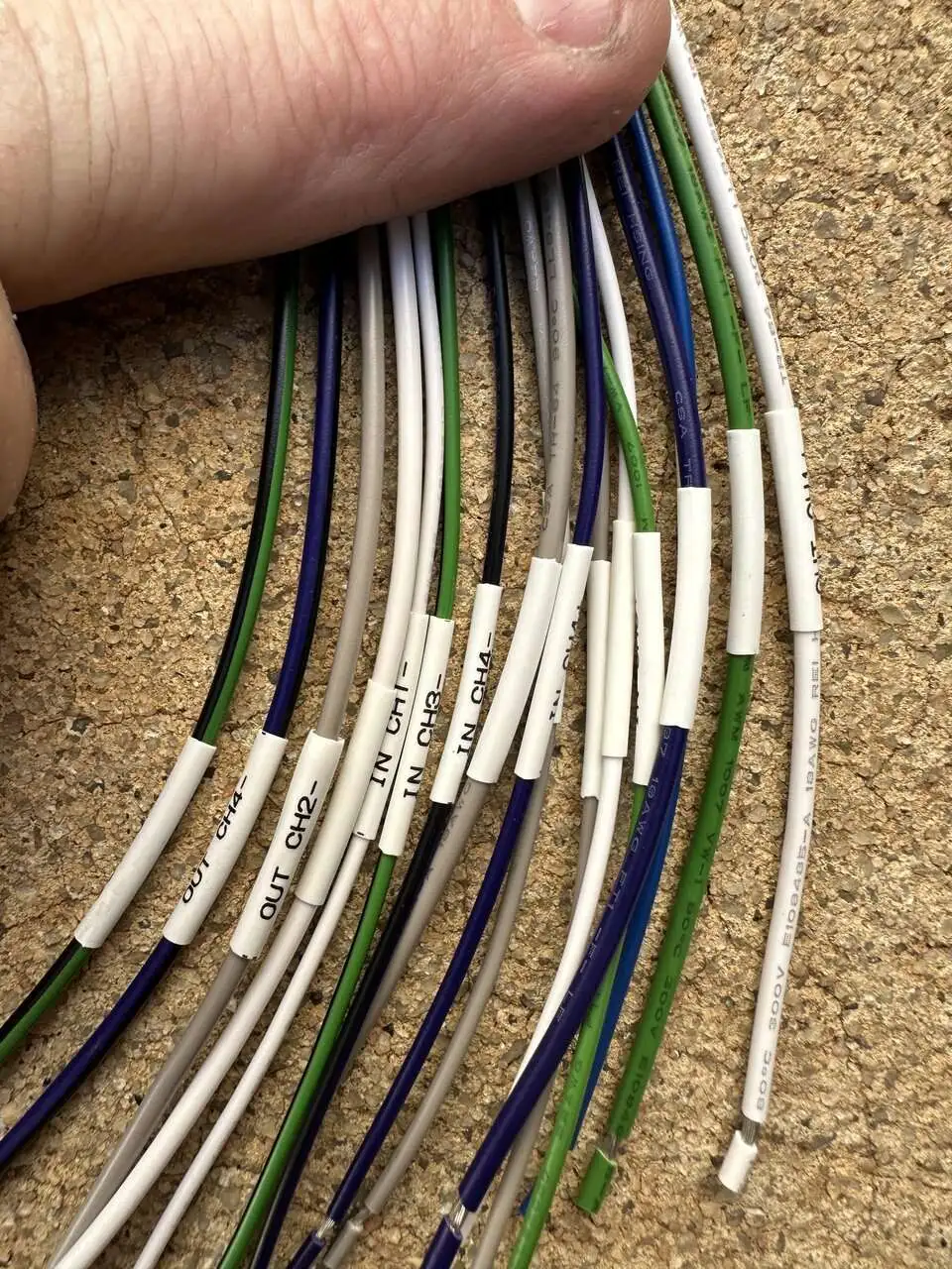

That’s what I’ve been reading, but if I’m keeping factory speakers, would I just splice into the rear speakers?
This is what I’ve got.
Like nearly all modern amplifiers, there's no need to add a Line Out Converter. That system will take speaker level inputs directly. LOC's are pretty much a thing of the past
