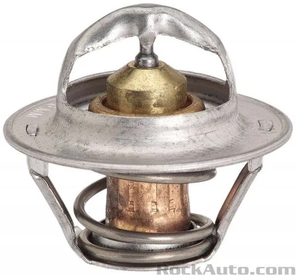

Now I'm confused.. are you saying there is no thermostat on the 2019 that looks like the image I added, and only this part that you mentioned?
No, there’s no mechanical thermostat like your picture showed in your 2.5L. The “electrical thermostat”, or the engine coolant control valve used in the 2.5L with cylinder deactivation is getting more popular for modern engines. Toyota’s new Dynamic Force 2.5L uses electrical thermostat too.
Sweet.. so I'm basically SOL unless Mazda covers this, and by the sounds of the guy At MNAO, he said that it's not likely mazda will cover this 100%, but maybe some..
Wait... So this IS the thermostat, they just renamed it essentially..

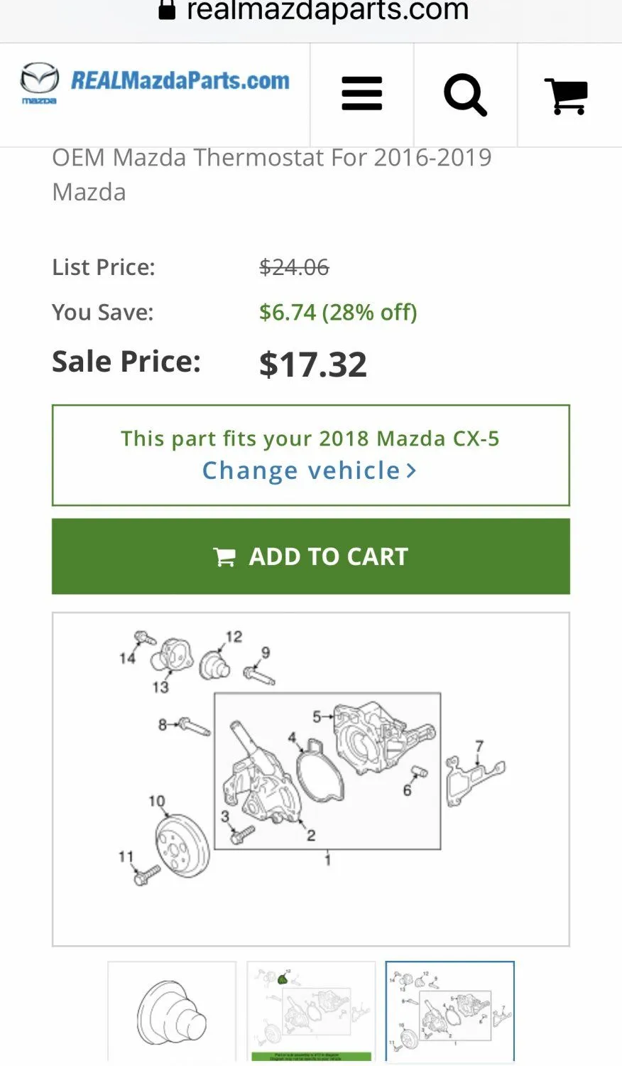

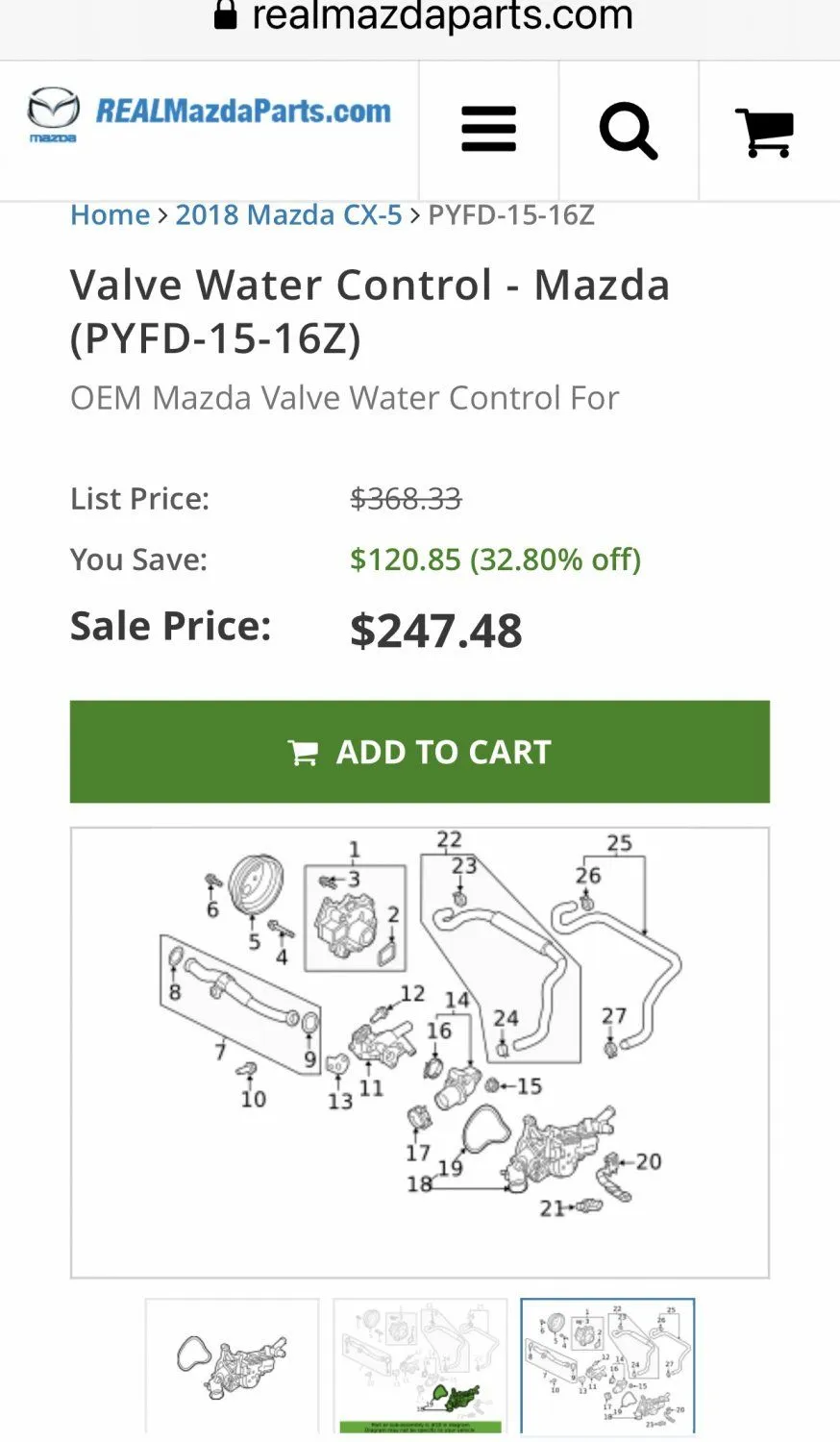

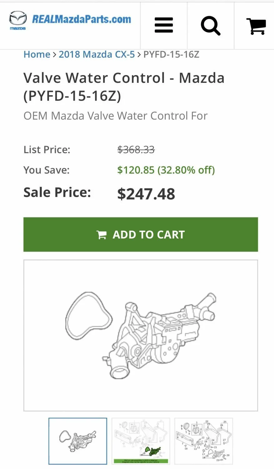

These are what I’d found from online parts list.
Engine coolant control valve is #18 in the diagram:
Valve Water Control - Mazda (PYFD-15-16Z)
If we go down to the engine coolant control valve part page to:
Other Names: Thermostat Housing, Water Inlet, Water Valve, Valve Water Control
It shows the coolant control valve is the thermostat housing, a part of thermostat system. And the location is the same for the mechanical thermostat found on the older 2.5L without cylinder deactivation.
Thermostat is #12 in the diagram:
Thermostat - Mazda (P502-15-171)
Again, hard to tell where is the specific location of this mechanical thermostat on a 2.5L with cylinder deactivation.

The coolant valve thing is all brand new to me as of yesterday and, as we all know, yesterday was a day where mundane things such as auto repair became quite unimportant. So I'm still trying to sort this out, and have looked at the valve on my own vehicle a couple times already, trying to get some clarification. What I've been able to see so far does not match the thermostat location of the drawing in the FSM. But the intake air assembly is blocking most of the view and I'm considering removing that stuff in order to get a better look. There's only so much that can be done with an inspection camera when access is so limited.
Yes this coolant control valve is new to me too. And I just thought it’s an electrical thermostat used by many newly designed engines.
The only other source that appears to confirm the presence of a thermostat contained in the coolant valve is the link below of the part from a Mazda parts outfit. The description twice mentions thermostat, and I'm taking that to mean a separate, mechanical thermostat. But I'm not certain of that, and won't be until I can confirm it in some other way. I will report back once I get more information, unless someone else is able to find it first.
The description of the coolant control valve, PYFD-15-16Z, does contains thermostat.
Part Number: PYFD1516Z
Supersession(s): PYFD-15-16Z; PYFB1516ZA; PYFD1516Z
2.5 LITER 2018-20. 2.5 LITER NON TURBO. 2019-21. A kit containing a engine coolant thermostat and additional parts for installation. A valve used to control the flow of engine coolant to the heater core. Incl.Gasket,Housing and Thermostat. JAPAN BUILT. MEXICO BUILT. inlet. outlet. WATE. Engine Coolant Thermostat Kit. HVAC Heater. THERMOSTAT HOUSING.
