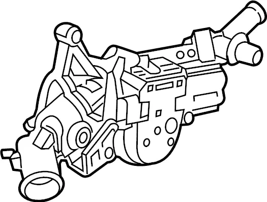

This Photo seems to show the actual "thermostat portion", wouldn't ya say? definitely seems different than the photo in my previous post...

View attachment 234503This Photo seems to show the actual "thermostat portion", wouldn't ya say? definitely seems different than the photo in my previous post...

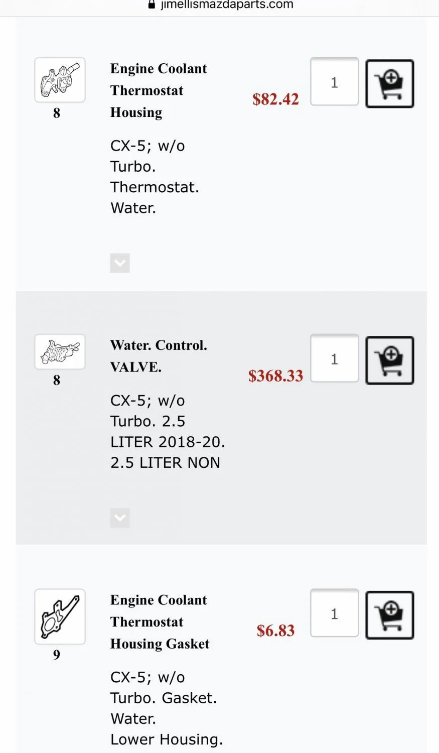

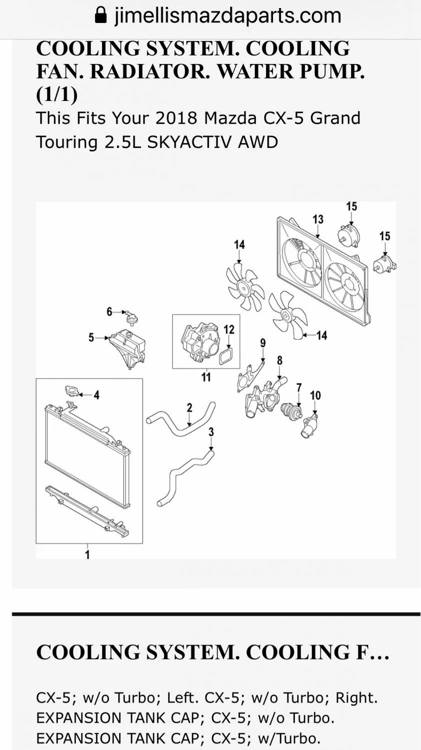

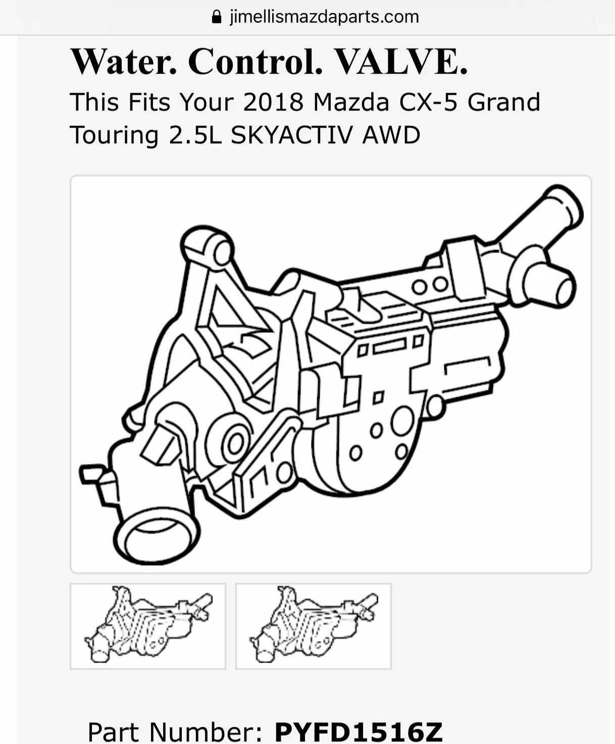

This online parts store has a better illustration on thermostat and coolant control valve (or thermostat housing) for your 2018 CX-5 2.5L with CD. #7 is the traditional mechanical thermostat; #8 is either coolant control valve for 2.5L with CD, or purely a thermostat housing for the rest of 2.5L’s. #9 is the gasket for #8.

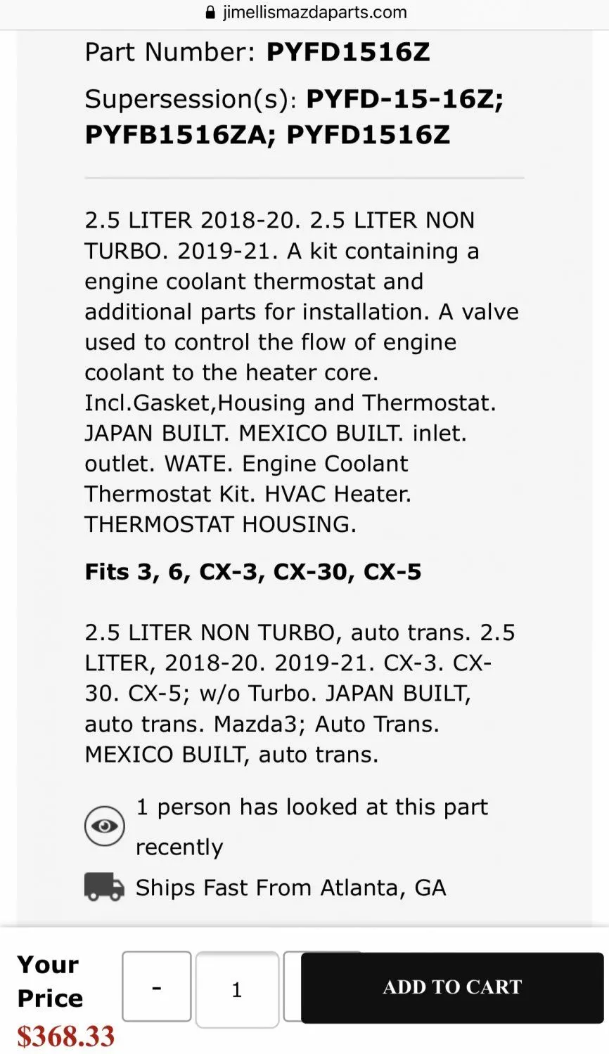

Based on the description on coolant control valve, part no. PYFD-15-16Z, it includes thermostat, part no. P502-15-171, and “additional parts” (#9 gasket?). These questions can be easily resolved by visiting the parts department at a Mazda dealer and see the coolant control valve, part no. PYFD-15-16Z, in person to verify.

By the illustration found on the Mazda online store you referred, I believe the coolant control valve contains either a mechanical thermostat inside with additional electrical valve assisting the flow control, or a pure motor controlled electrical valve which serves as traditional thermostat functional wise with better flow control by PCM.
Coolant control valve at #8 in above illustration with included invisible thermostat:

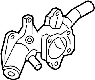

Thermostat housing at the same #8 location with a rounded hole for the thermostat #7:

Thanks for the insight. That’s why I believe OP should keep talking to the MNAO, not to his dealership. Unless his Mazda dealer is willing to absorb the possible cost of repair. However, MNAO also relies on dealer’s opinion to make decision on goodwill repair. And the argument here IMO is the definition of “thermostat” described in powertrain warranty. To me, “water control valve” is the “thermostat”, especially the part actually contains the “thermostat”!

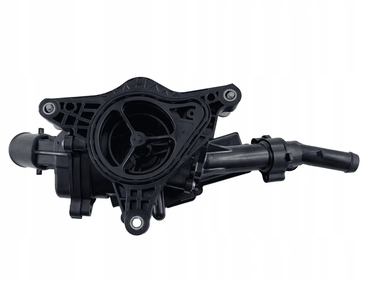

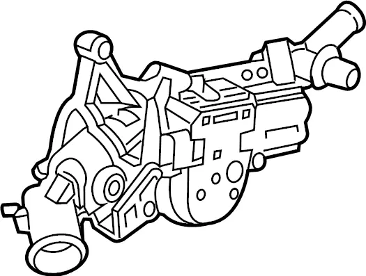

My car definitely has the following control valve in place..

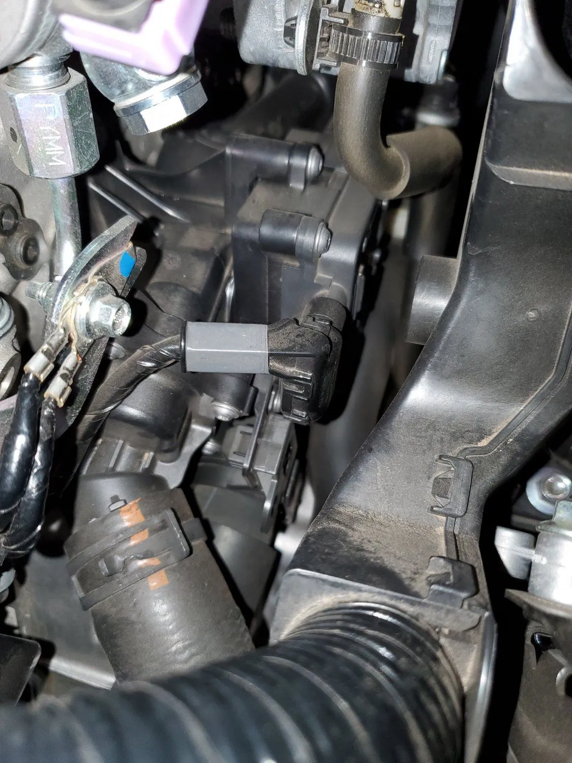

There are electrical connections attached to it.
I'm very inclined to think there is no traditional mechanical thermostat inside the housing based off photos.

Well looking at the real picture of thermostat itself makes me wonder. It just looks mechanical. And it wouldnt usually be separate part if it was all electrically controlled.

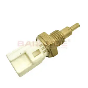

The electrical comnection could be a temp sensor.

Yes just snapped a pic. You are absolutely correct. There is a large partof the housing with a connector to it. Not temp sensor definetely.
