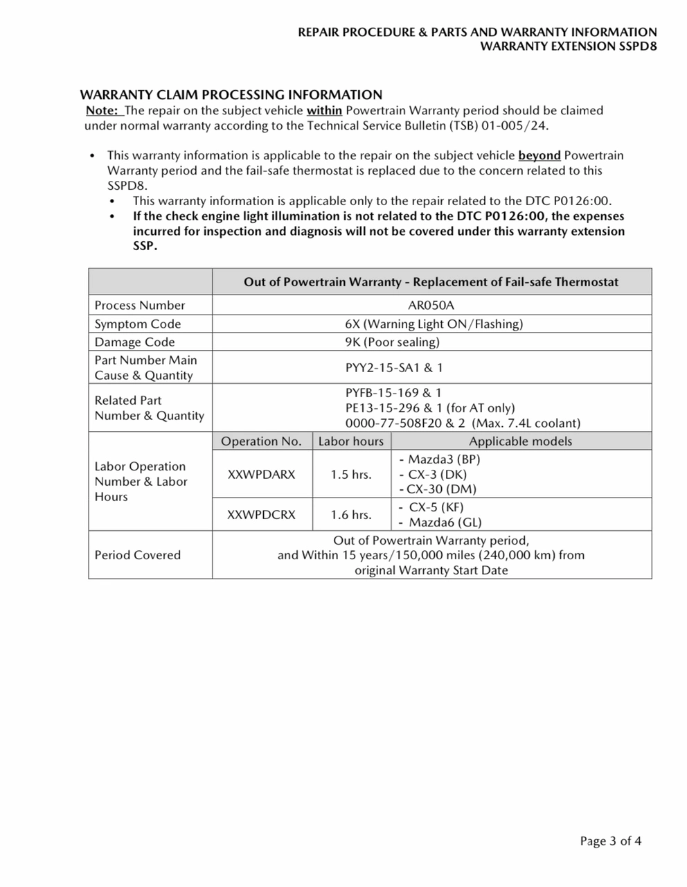

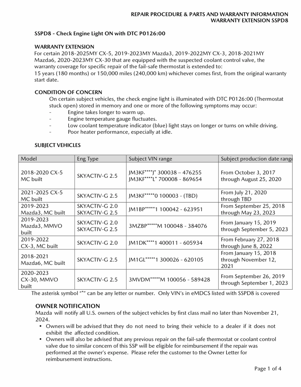

OWNER NOTIFICATION
Mazda will notify all U.S. owners of the subject vehicles by first class mail no later than November 21, 2024.
• Owners will be advised that they do not need to bring their vehicle to a dealer if it does not exhibit the affected condition.
• Owners will also be advised that any previous repair on the fail-safe thermostat or coolant control valve due to similar concern of this SSP will be eligible for reimbursement if the repair was performed at the owner’s expense. Please refer the customer to the Owner Letter for reimbursement instructions.
Call MNAO to get instructions for reimbursement. Your Mazda should have all the documents for your repair if you’ve lost your invoice.

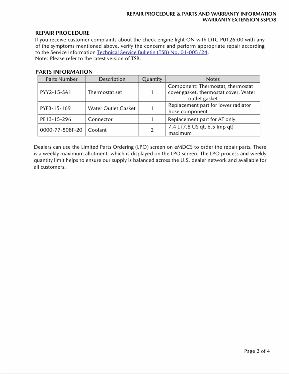

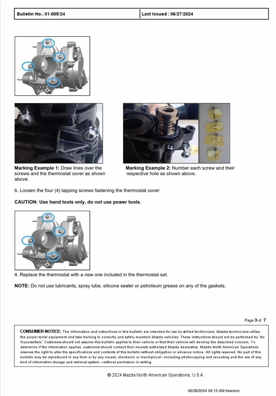

SSPD8 - Check Engine Light ON with DTC P0126:00
Mazda has issued a Special Service Program D4!(SSPD4) on this “Check Engine Light ON with DTC P0126:00” problem with the thermostat stuck open on the 2.5L NA with CD as posted above. The SSP stated the warranty coverage for specific repair of the “fail-safe thermostat” in the coolant control valve is extended to 15 years (180 months) or 150,000 miles (240,000 km) whichever comes first, from the original warranty start date.

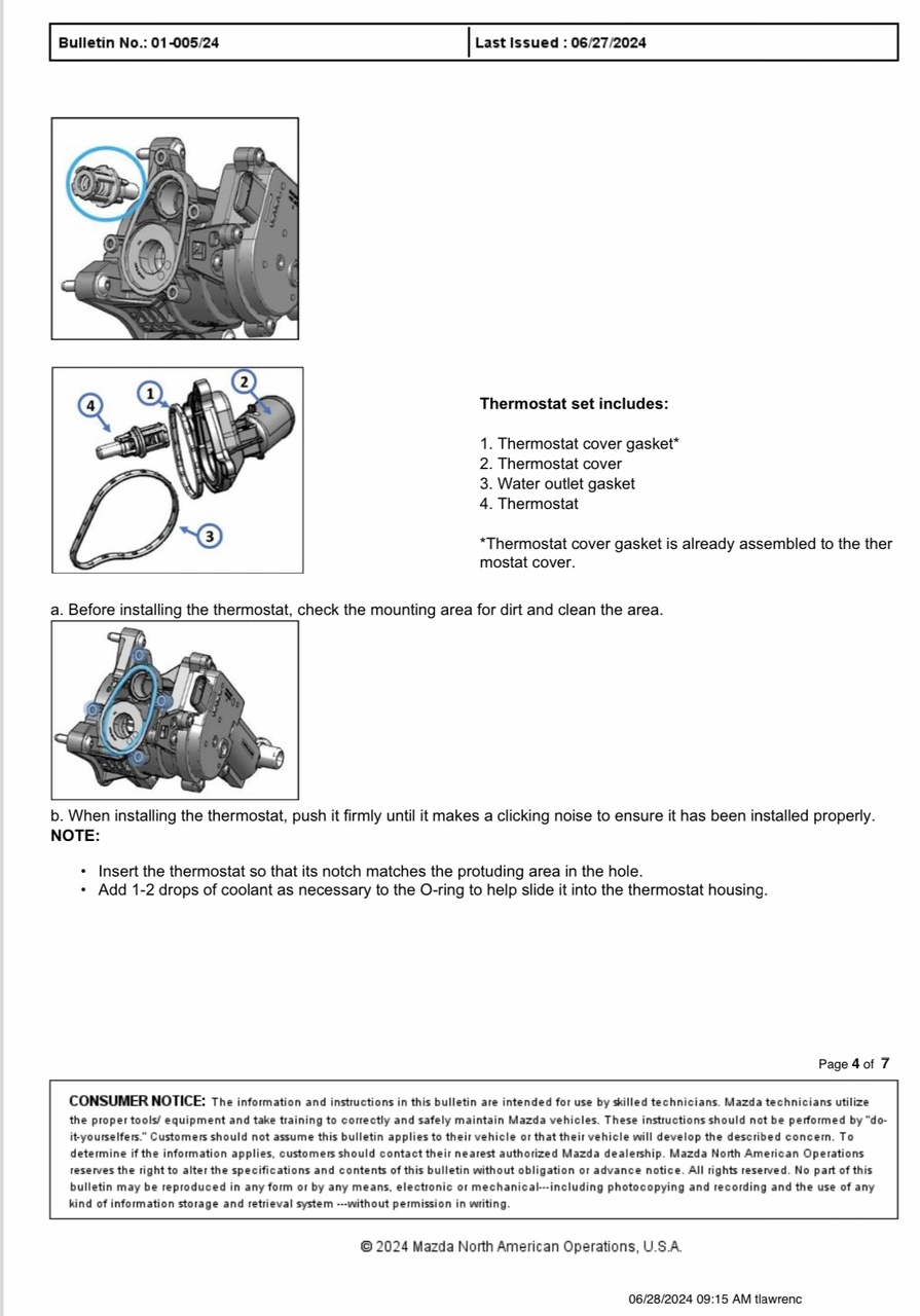

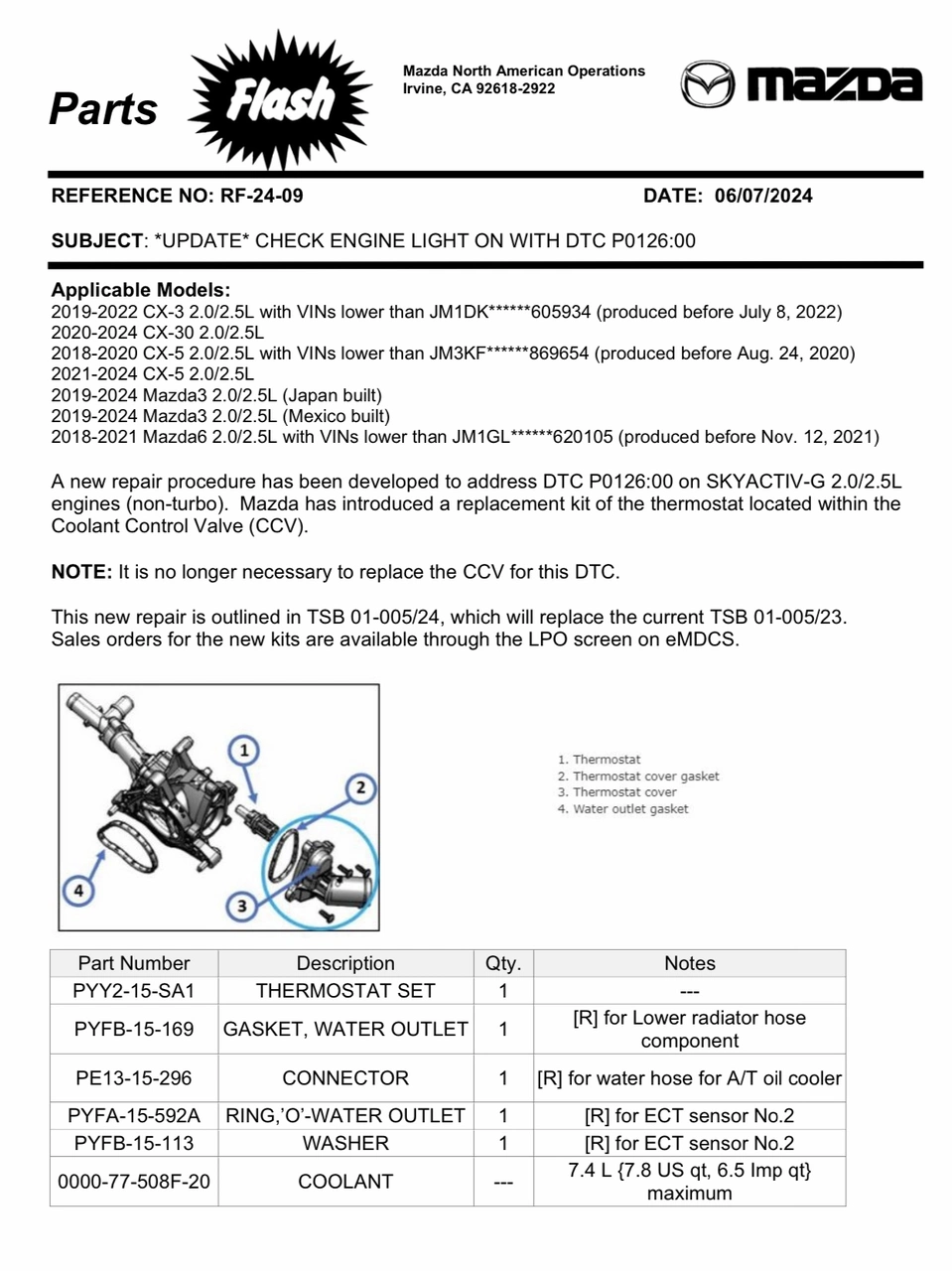

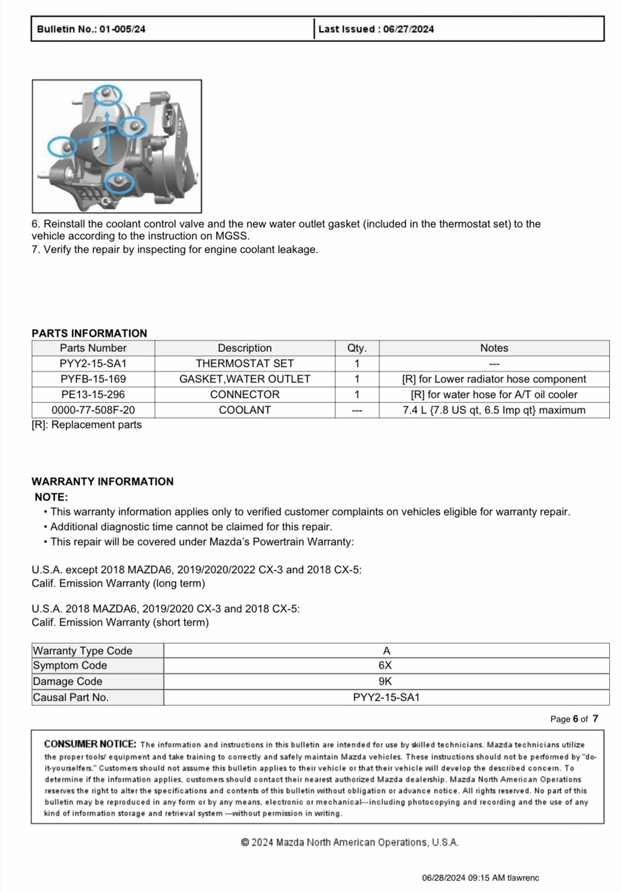

Also, Mazda has introduced a replacement kit of the thermostat located within the coolant control valve (CCV). Now the “fail-safe thermostat” is available separately so that the replacement of expensive coolant control valve (part #: PYFD-15-16ZA, MSRP: $454.36) is no longer necessary, only the thermostat (PYY2-15-SA1, MSRP: $31.11) and connector / gaskets are needed.
Parts Flash Reference No: RF-24-09 *Update* Check Engine Light ON with DTC P0126:00
TSB No: 01-005/24:
Unfortunately this situation is complicated by the fact that there is also a mechanical thermostat integrated into this coolant control valve. And I cannot find documentation on the operation of the valve, so it's unclear to me what the functionality of the mechanical thermostat is in the overall design of the valve.
So it appears that this Mazda stealership is trying to say the mechanical thermostat would be covered, but the valve is not. I agree with what you're saying, however it seems, based on the OP's case that they are relying on technical semantics to bail out on this warranty coverage. Time will tell where this ends up, but I would personally test the thermostat, regardless of anything else, because IMO it's very important to determine if it's working properly or not.
Based on the latest TSB 01-005/24 you’re correct that there’s a mechanical thermostat which is built into the coolant control valve. Although it looks different from those we usually see and it certainly is different from those “electrical thermostats” been used on Toyota’s. Luckily Mazda has made a right decision to make this proprietary mechanical thermostat available for parts in case it fails, and extended the warranty of this thermostat in coolant control valve for a long period of time.

Firstly, the thermostat inside the coolant control valve isn’t an “electric thermostat”, but a traditional mechanical thermostat with different size. Not sure why Mazda would fail to manufacture a good old thermostat properly, as those related TSBs since 4/22/2021 keep saying: “To eliminate this concern, the production process of the coolant control valve has been modified”, but the coolant control valve problem seems to be persistent.
By comparison, the newly added “electric thermostat” (not to be confused with Mazda’s “coolant control valve” although they both can have much more precise coolant flow control for different engine temperature) on Toyota’s Dynamic Force high-compression 2.5L / 2.0L NA found on my daughter’s 2022 Corolla Hatchback XSE doesn’t seem to have any issues since 2018!
I apologize for my iniquitous error on the terminology used "electric thermostat". I'll take 50 lashes with a ford serpentine belt.🤣
