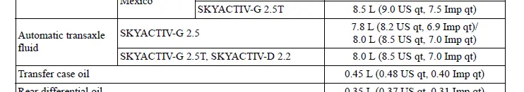

Hi, so gonna have to have transmission fluid changed in 2018 cx5 , but not doing flush and just having it changed. I know a flush would require the 8.2 quarts I believe the capacity is. But, how many quarts do I need for just a change? I'm guessing around 6?

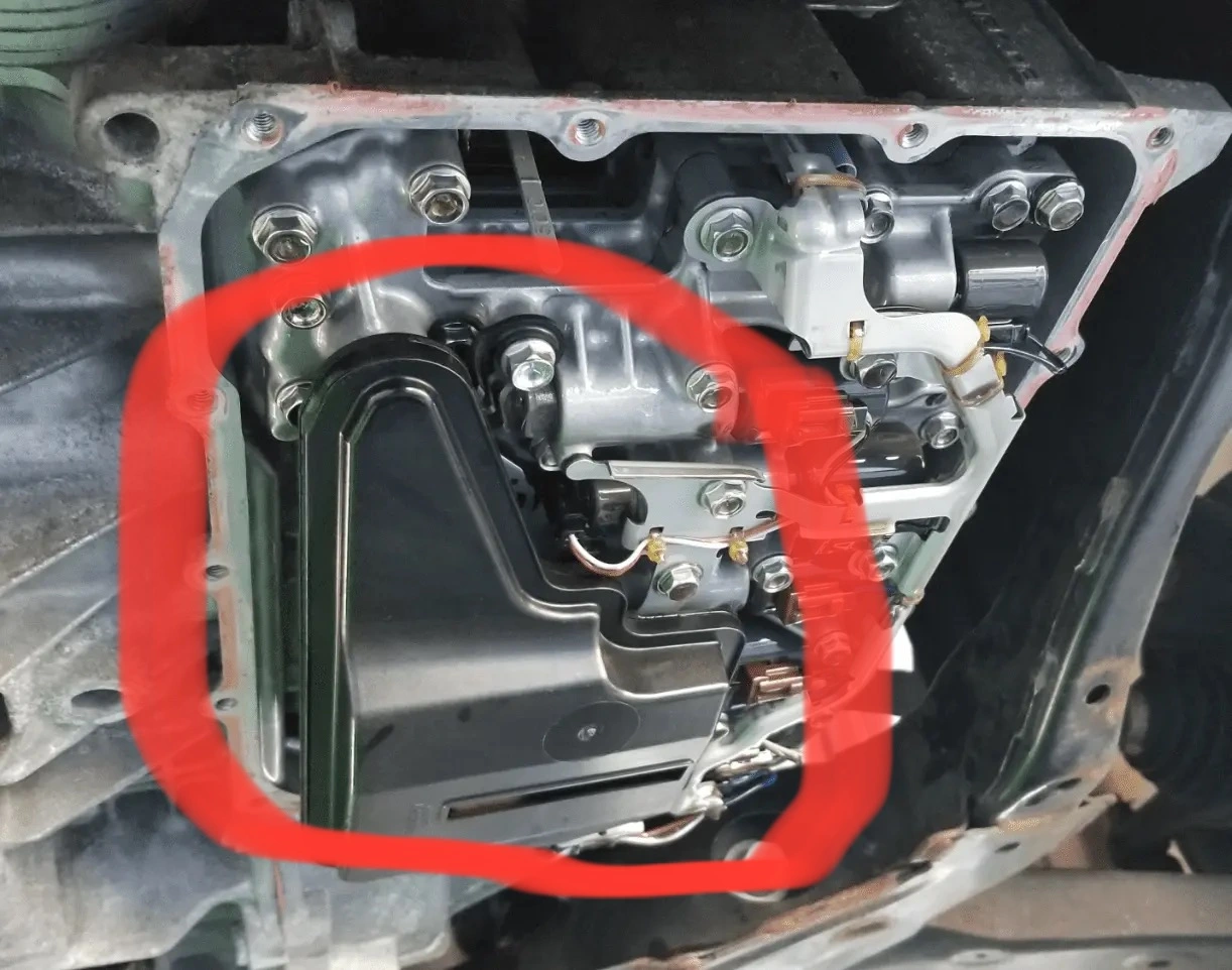

Agreed with @ceric , the pan should be dropped and bottom cleaned out, along with magnet, and new strainer (Filter) in.

Find a transmission specialty shop. Ask them to change both filter(strainer) and fluid. (Pan drop)

Based on many reports here you’d need 3.75 quarts of fresh FZ ATF for a single drain-and-fill. You’d need about 0.75 quart or more if your drop the pan with the filter cartridge change.

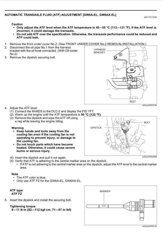

Since you have a 2018 CX-5 2.5L NA with cylinder deactivation, your AT is different from previous version with higher ATF capacity (8.5 quarts vs. 8.2 quarts). And you may need a bit more than 3.75 quarts for a single D&F. Follow the proper procedure on ATF level checking to verify.

Yes you may see only 3.2 quarts of old ATF coming out but you’d still need ~3.75 quarts to refill for a simple ATF drain-and-fill. Many have verified Mazda under-filled the ATF from factory, hence don’t put in the equal amount of old ATF you drained out back in with fresh ATF. Use a good OBDII scan tool to read the ATF temperature (122°F) with engine idling when you check the proper ATF level to verify.

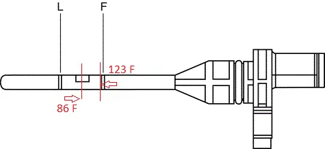

Forum member @FerrariF1 originally thought his ATF level from factory was fine while checking the ATF level without engine running on his CX-5 2.5T. Once he rechecked with engine idling, he needed about 600ml (0.635 quart!!!) to bring the ATF level to the Full mark (although the ideal level should be at the middle block area). Mazda under-filled the ATF in his transmission as usual at the factory. That’s why you don’t re-fill the same amount of fresh ATF as drained ATF because the factory fill usually is too low.
He also did an experiment and found the differences on ATF level in different ATF temperatures on his CX-5 with 2.5T:
ATF...Change or not?
But is it really different if you're idling versus just with the car off?? The dip stick doesn't give the same result?

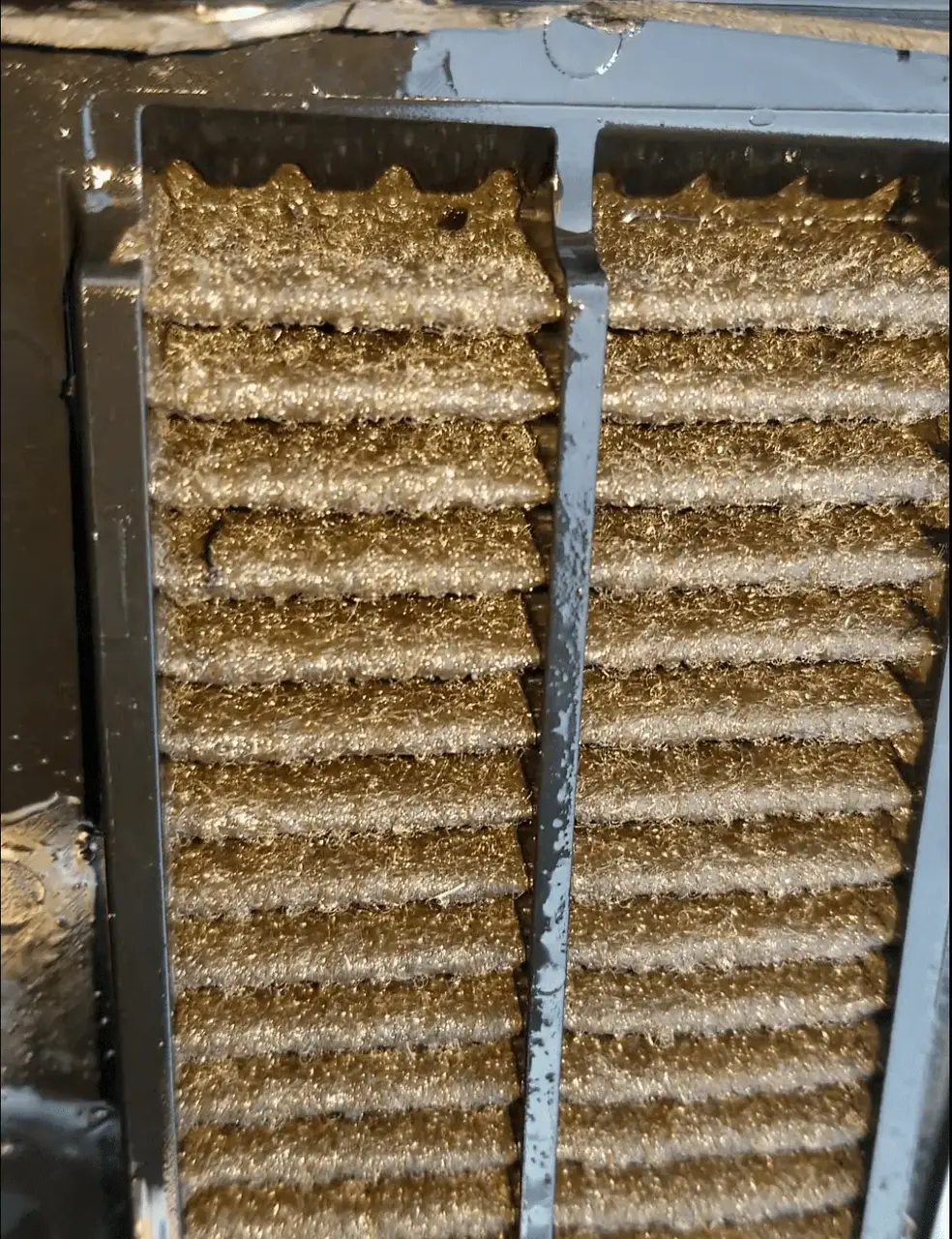

There is no filter to change - it's a very fine screen.
No it’s a filter cartridge / strainer there, not a fine screen.
Cut open:
