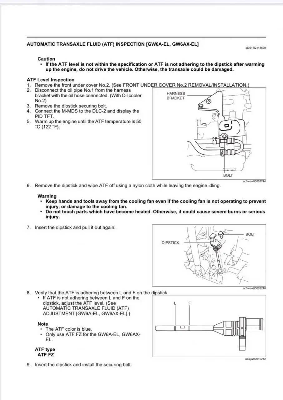

Yes, Mazda really made it so difficult to check the ATF level.

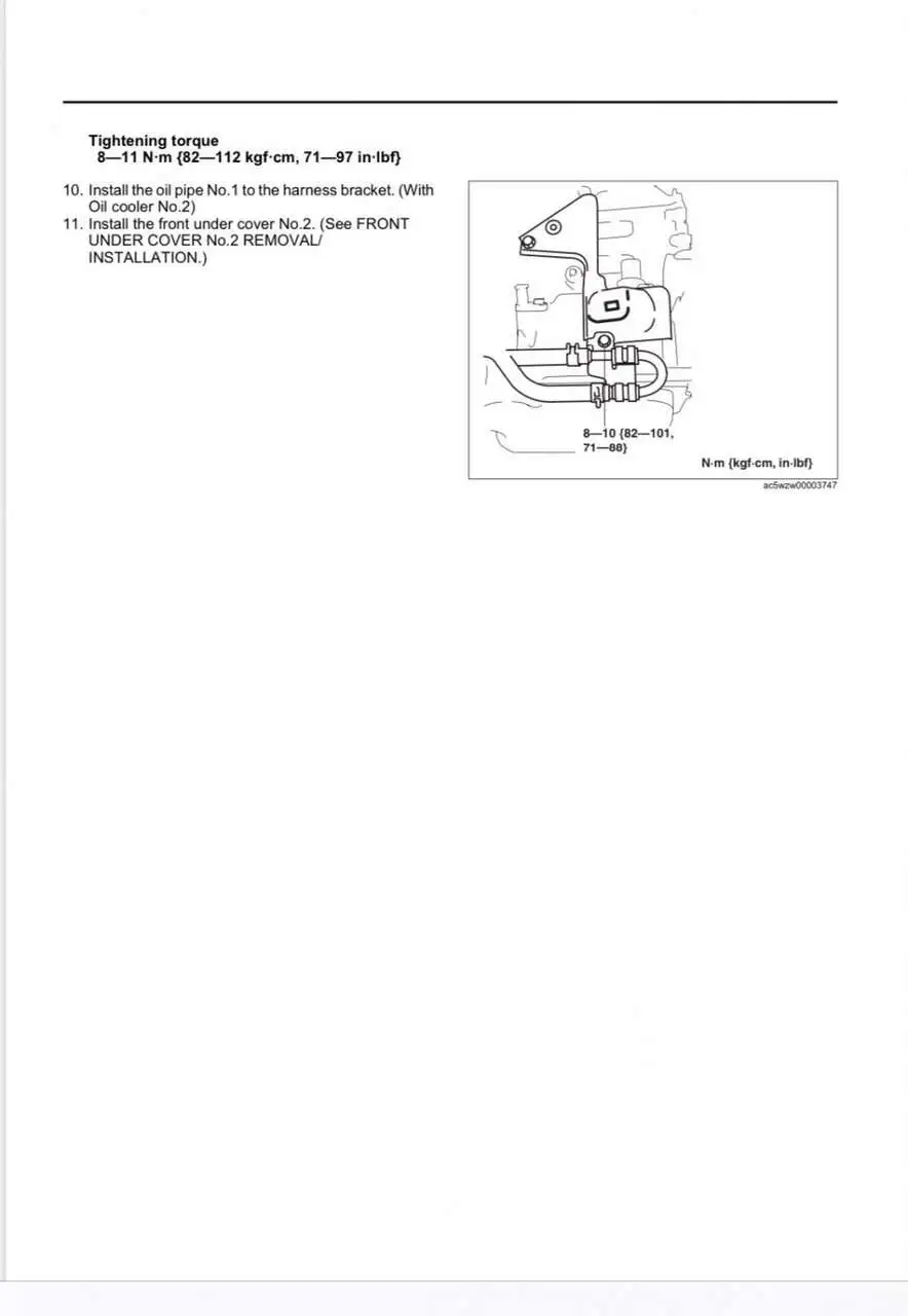

The step 6 in the Mazda Workshop Manual specifically says “while leaving the enginf idling” when you take the measurement of the ATF level at 122°F. I also would shift transmission into every gear then measure the ATF level with the engine idling. When engine is idling, the AFT pump is functioning and circulating the ATF everywhere in the transmission including the torque converter which has a half of the total ATF quantity. That’ll bring down the ATF level in the pan significantly. It’s similar if you check the engine oil level with the engine running, the oil level will be much lower in the oil pan.

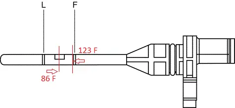

He also did an experiment and found the differences on ATF level in different ATF temperatures on his CX-5 with 2.5T:
You guys were right, I checked the ATF while idling and it was low. The ATF was at around 25-30 C (77-86 F). I added 600ml and it came up to the middle of the 2 lines, so perfect. I don't think ATF expansion is that great that I need to check at 122F, and I'm guessing if I were to check at 122F it would be closer to the top line.

Update: I warmed up the transmission fluid to 51C / 123F and re-checked level (car idling, level surface) and it was just below the Full line. MS Paint artwork attached.
Summary: added 600ml to factory fluid to bring it up to full level. I did not drain and fill since car has 30K km / 18K miles.

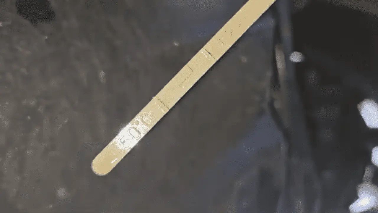

Can you check the video I posted. I show what the dipstick looked like when I the temp of the pan was at 122. does it look right? or still low?
Thanks for making a video. Based on your video at 24:50 mark, and this’s the screen shot, your ATF level is too low if you took the measurement with the dipstick full seated.
Compare yours to FerrariF1’s. He added 600 ml / 0.634 quart Mazda ATF FZ to the factory fill; which took the ATF level to the upper / full mark at 51°C / 123°F. The ideal ATF level is at the middle block mark of the dipstick at 122°F.
