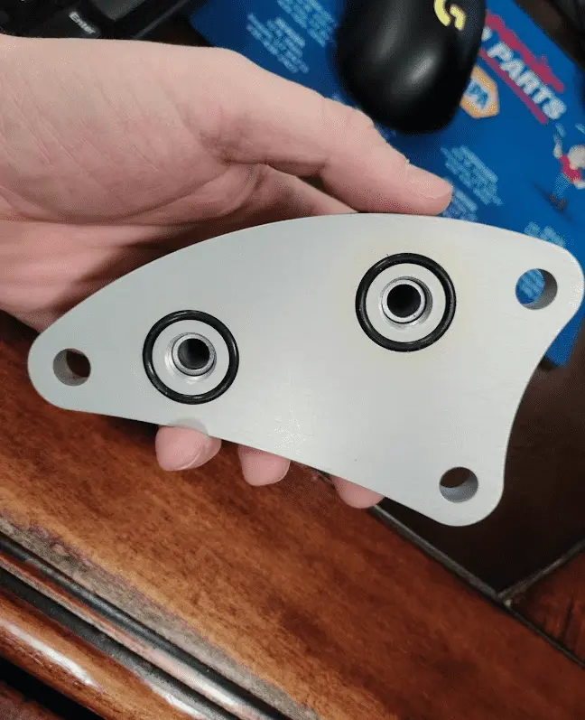

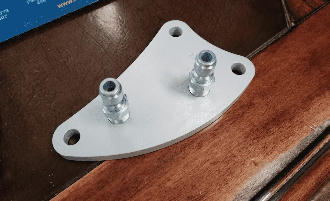

This is that BG products adapter I pointed out 4 years ago

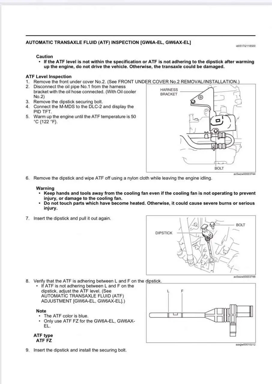

Are you sure you’d followed Mazda’s proper procedure to check the ATF level? Did you check the ATF level with the engine idling?
Here @FerrariF1 originally thought his ATF level from factory was fine with engine stopped on his CX-5 2.5T. Once he rechecked with engine idling, he needed about 600ml (0.635 quart!!!) to bring the ATF level to the Full mark (although the ideal level should be at the middle block area). Mazda under-filled the ATF in his transmission as usual at the factory. That’s why you don’t re-fill the same amount of fresh ATF as drained ATF because the factory fill usually is too low.

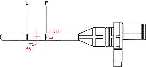

He also did an experiment and found the differences on ATF level in different ATF temperatures on his CX-5 with 2.5T:
You guys were right, I checked the ATF while idling and it was low. The ATF was at around 25-30 C (77-86 F). I added 600ml and it came up to the middle of the 2 lines, so perfect. I don't think ATF expansion is that great that I need to check at 122F, and I'm guessing if I were to check at 122F it would be closer to the top line.
I also changed the rear diff and front transfer case, and they both took about 0.5L each. Not too complicated.
Update: I warmed up the transmission fluid to 51C / 123F and re-checked level (car idling, level surface) and it was just below the Full line. MS Paint artwork attached.
Summary: added 600ml to factory fluid to bring it up to full level. I did not drain and fill since car has 30K km / 18K miles.

first time doing transmission fluid change so I'm not sure if I checked right.
before the fluid change, I let the car run for 5 minutes then put the car on neutral and ebrake then checked the level marked in the picture. checked again with the gear in neutral now at 15 minutes the level is where I marked.
after the fluid change, let the car run for 15 minutes then put the car in neutral and ebrake
I don't have a device to measure atf temp so I didn't do that just let the car run for 15 minutes.
correct me if I did anything wrong.
here is the level

But did you check the ATF level while the engine is idling?

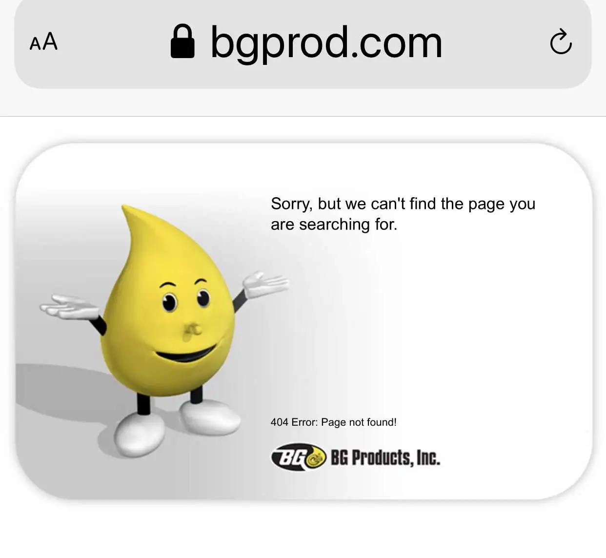

I got some pushback when I attempted to order one a few years back. Perhaps I will try again.
I think this adapter is useful only if you have a commercial ATF flush machine ($$$) to hook up. Not much useful for a DIYer.
