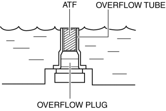

Interesting. Must be different per transmission? For the MX-5, the ATF should be 136—144 °F.You won't. 122 isn't the normal operating range.
AUTOMATIC TRANSMISSION FLUID (ATF) LEVEL ADJUSTMENT [SJ6A-EL] | 2016 ND Shop Manual
< Previous Next > CAUTION: NOTE: 1. Lift up the vehicle. 2. Remove the filler plug and O-ring. NOTE: 3. Remove the overflow plug and the overflow plug gasket. 4. Fill with ATF from the filler plug…
