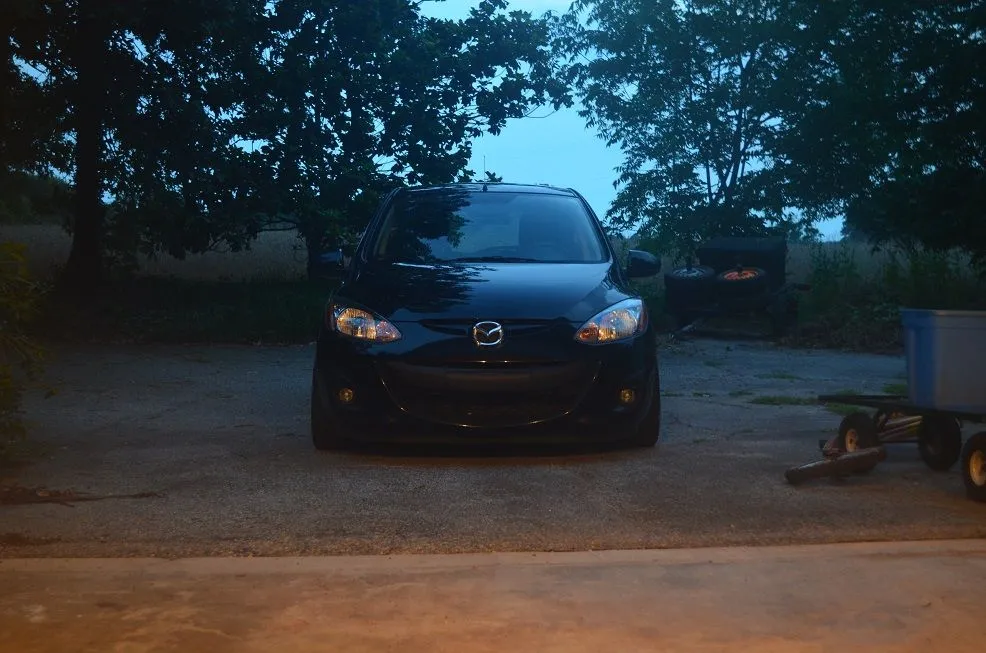

Here is an interesting picture I just took. From the front you can really see how wide the car is now. Also looks so good with the camber as well.
Sooooo much better :)
What is the offset of the oem wheels to start with? I wonder what it is equal to now with those spacers.
I'm going for TR C1M 15x7" 30 offset my self, they are only 94$ each + 205/50R15 tires.
It is equal to a +15 offset. Basically a number of people on here showed how you can fit a 15X7 with a +25 offset with no issues. The factory wheels are 15X6 and +40. So those aftermarket wheels have 15mm more offset, plus they are half an inch wider on the outside because of the wheel width. That is 15+12.7=27.7mm difference. I just went with a 25mm spacer since I know I am using one of the good autocross tires for DD which are usually a little bit wider than most.

Thanks for the info, makes sense :)

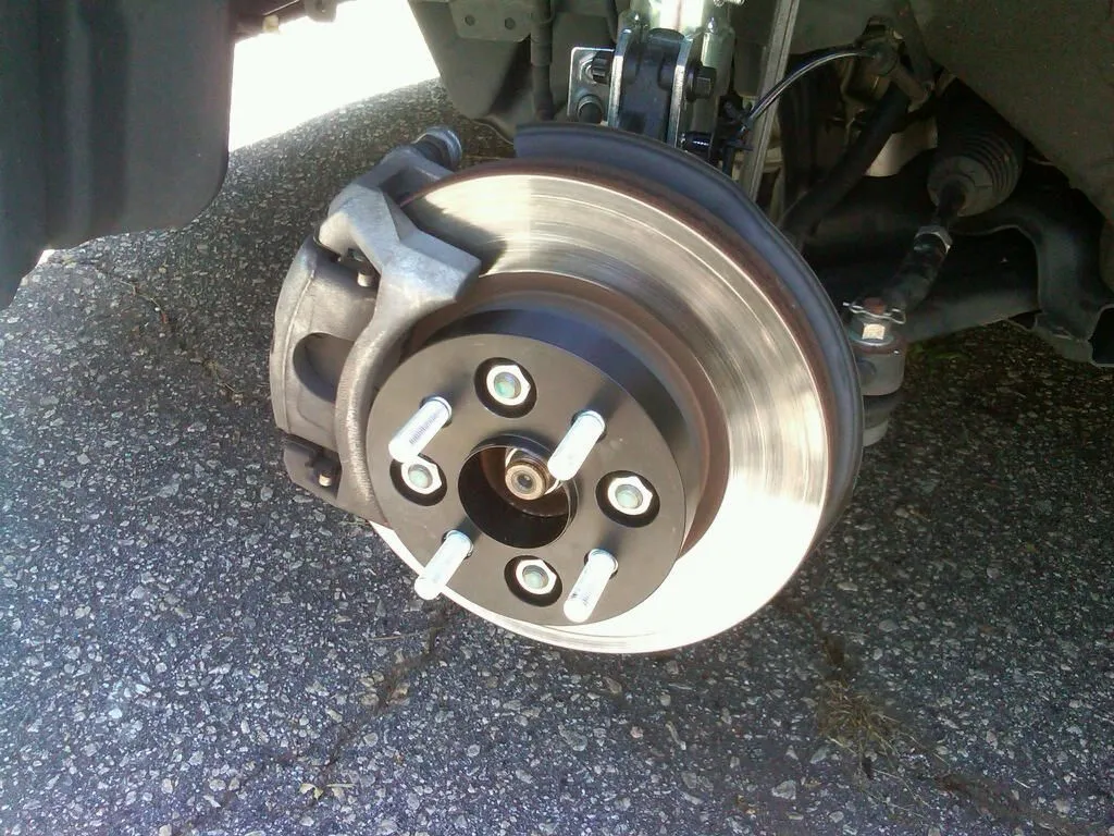

Technically I got wheel adaptors now spacers. They bolt to the wheel, then you bolt your wheels to them. It is a much better way to do it with how thick mine were. I think I put up a picture of that a bit back.
Here is the picture. It shows how the adapter is bolted to the hub, then the wheel bolts to the adapter.

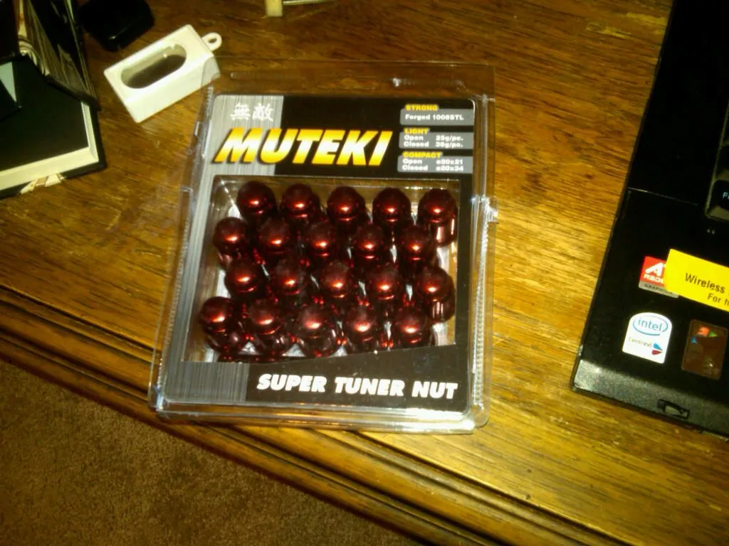

My new lug nuts came in today. The red will look good. Tomorrow the car will be getting a good cleaning to get ready for the cars and coffee on Saturday morning.
It would but when you order you order them for the specs of the car, not by what car they are going on. They are 25mm wide 4X100 with a 54.1 center bore for the factory hub and to fit the factory wheels. Oh and M12 X 1.5 wheel studs.
