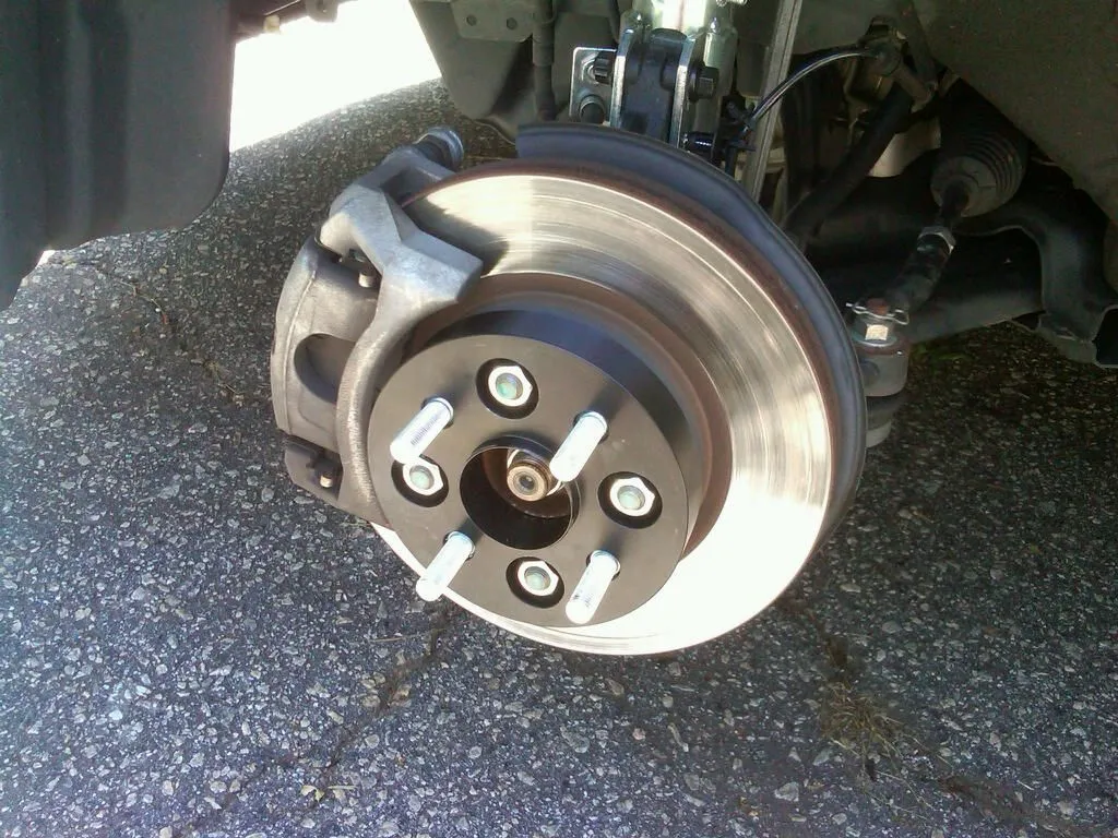

Here is a little teaser. I went home for lunch to get stuff done on the house, but as I was pulling in the UPS guy was pulling out. So since the spacers were there I tried to install them, but the studs are longer than the factory ones so I need deeper lug nuts than factory. Oh well I was close to getting them on. I might be able to get my hands on a set of lug nuts tonight though, we will see.

Before spacers installed
After:

Overall the spacers fit really well. The only issue I had was that on one of the studs the first thread was slightly messed up so I had to file it into shape some, but everything else was just fine. Very happy with the result and no vibrations either.

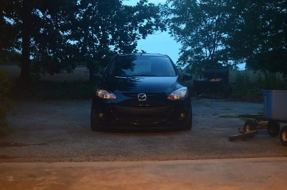

Here is an interesting picture I just took. From the front you can really see how wide the car is now. Also looks so good with the camber as well.
