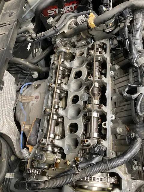

So, if microscopic abrasive soot (too small to be filtered out) from DI can accumulate behind piston rings and also cause timing chain wear then I want it out of there. Don't have a turbo but the heat and shearing alone would dictate reasonable oil change intervals. Engine deposits from oil breakdown can interfere with VVT operation.
Here's a pic @ 71,000 miles when replacing valve cover gasket before doing new spark plugs.
Nothing spectacular or uncommon but reassuring that my oil change regimen is working.

That engine looks new! What kind of oil are you using?
I had the oil changed at the Mazda dealer for the first 6 years (1 year past drivetrain warranty expiration-- and having had 42 years of oil changes under my belt I didn't feel any loss of manliness by letting them do it for a while 😉). About every 3500-4000 miles. After the factory fill, they mostly used bulk Valvoline synthetic 0W-20. The oils used in the last 4-1/2 years since resuming have been experimenting with a variety of brands. All synthetic naturally.
