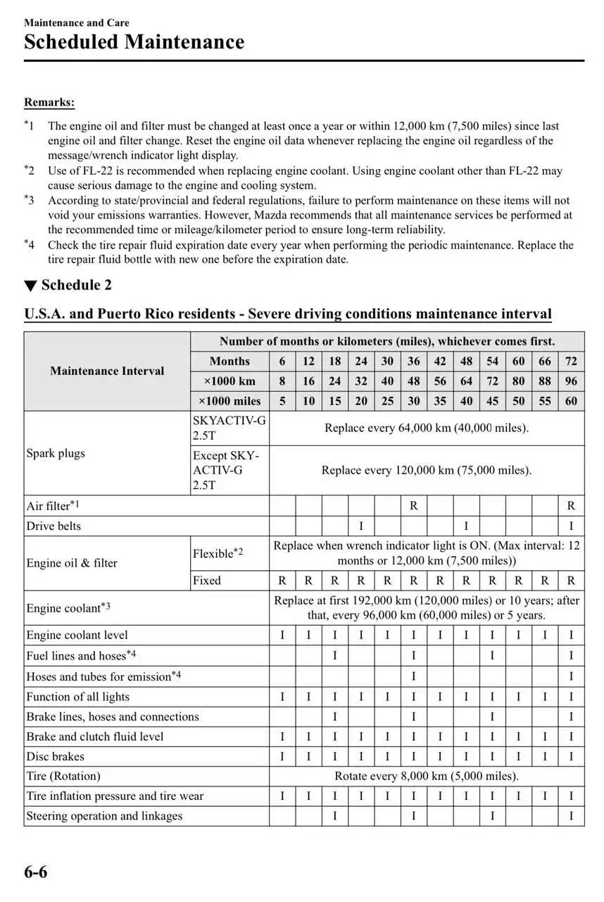

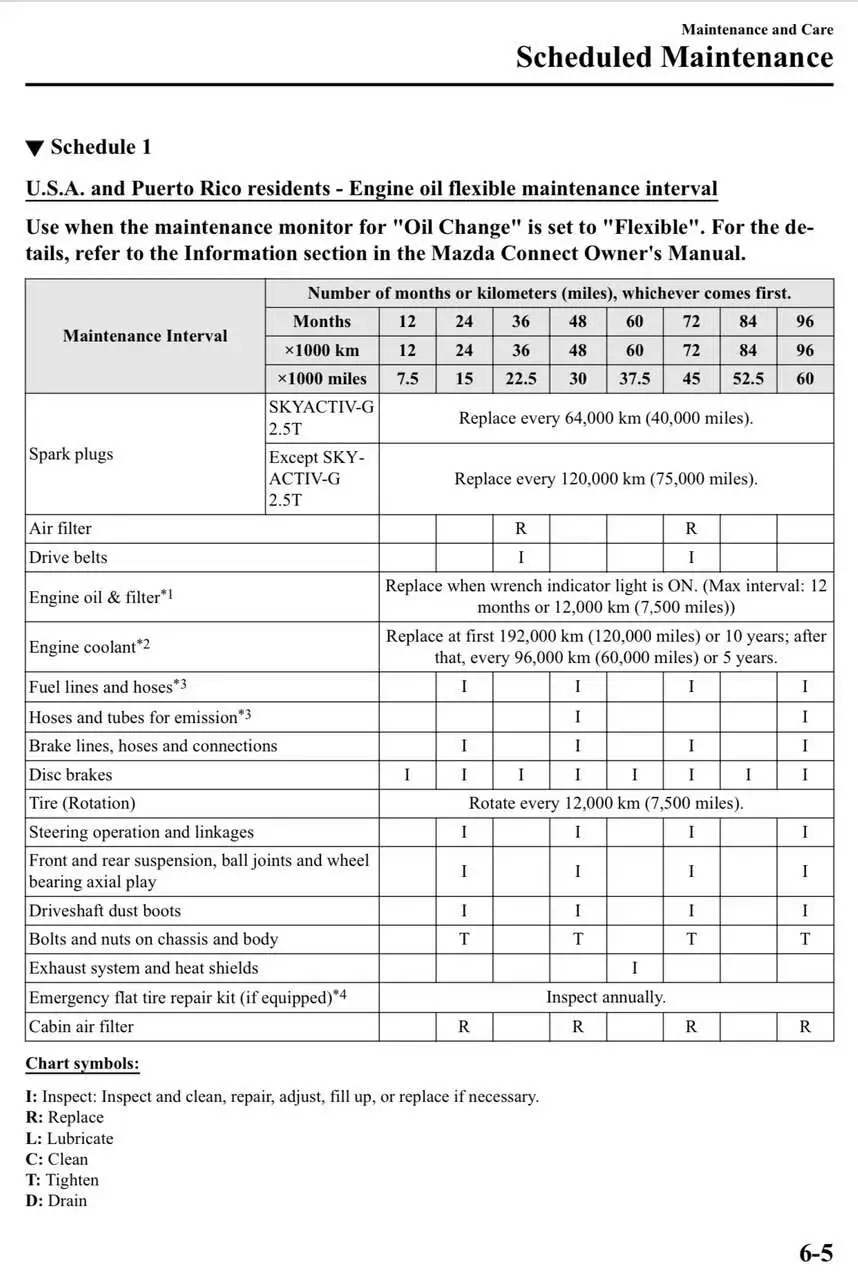

For the 2016.5 there are three possible recommendations, depending on if you're using the Fixed, the Flex, or the Severe use schedules.
Fixed = 6 months or 7.5k miles, whichever comes first.
Flex = 12 months or 10k miles, whichever comes first.
Severe = 12 months or 5k miles, whichever comes first.
So, if the OP changed his oil when he returned from his trip, with ~6.5k miles on the odo, he should be good.

The vast majority of people fall under severe, however, it seems OP intends to take care of the vehicle for the long term, so, severe makes sense, however, I already covered that. Pretty easy.
He was worried about possibly going 1,500 miles over. Really should it make a difference- probably no, but for extended changes an analysis is what is needed to be sure. Oil changes are cheap- especially if you can afford a new car you should be able to afford the oil changes.

This’s what the 2023 Mazda CX-5 owner’s manual says:
Based on mostly highway driving by the OP, it’s hard to be qualified as “severe driving conditions”. The best is to follow Mazda’s recommendation and use “Flexible” OCI which can be used in normal and severe driving conditions. And the maximum OCI by “Flexible” is 12 months or 7,500 miles.
IMO any current synthetic oils can handle 7,500 miles of service under most driving conditions. There’re too many UOA reports can support that. Considering Toyota has been using 10,000-mile OCI under any driving conditions with a super-thin 0W-16 oil for many years you should feel Mazda’s oil change interval at 7,500 miles is pretty conservative.

Unfortunately somehow your flexible oil change monitor got reset at the certain point, hence the 8,000 miles total indicated. And did you check the mileage or reset it at the time you picked up the new car?
Although Mazda’s maintenance monitor doesn’t do sophisticated oil analysis but it does calculating the driving time and mileage with other factors. I myself found the system is pretty accurate and “flexible” depending on my car usage and driving style. It even gave me the red wrench indicator to warn me the oil change for the last couple of years even thought the CX-5 had driven only 2,500 miles, but reached 12 months maximum time period.
